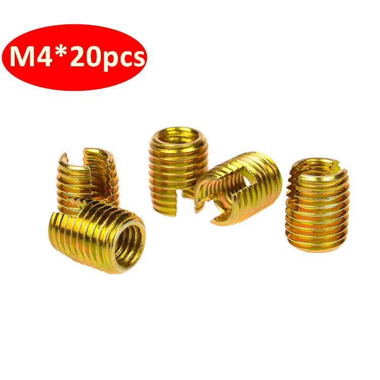

Two of the nuts in my tool mount has gotten loose when I screwed in a tool holder. Now it’s just a mess, impossible to fix new nuts in the opening. I’m afraid that I have to make a new tool mount. To avoid the same thing happening again - I’ve been thinking about threaded inserts, that I can hold fast when I screw in bolts from the tools side. What do you think?
or this one: https://www.aliexpress.com/item/33045940499.html

I wonder if you use these threaded inserts if you’ll have to then use loctite as well?
I watched a youtube video where the guy heated up a brass insert and then pushed it into the 3d filament. Once it was cooled, it was almost impossible to get back out. You could probably do the same thing on the tool mount.
From experience I can say these (heat pressed threaded inserts) work really well IF (big if) you are not using super cheap inserts. This YouTube video compares the different types and how well they hold. I can also say these don’t work as well in PETG printed parts. PLA and ABS are fine.
Heated inserts work best when the hole is sized to leave the right amount of plastic to hold it in place. May not be the best solution for the stripped out nuts in the original post.
They’re typically bigger than an equivalent nut though so you might need to drill them out a bit or just redesign the mount for them and reprint.
