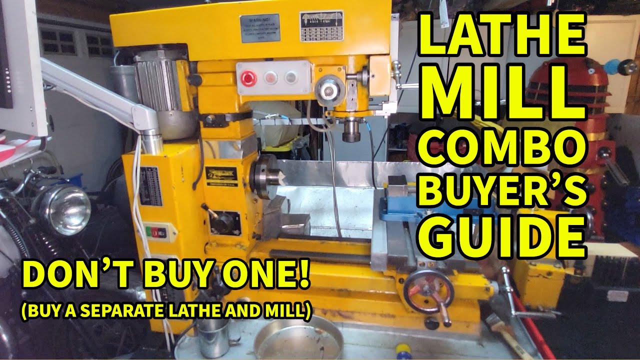

Most machinests recommend looking for good used individual tools if you have the room.
Yep, and I lean that way. The guy in this video argues strongly for that position:

I started out with a combination machine. Mine was an Eldorado Bridgemill (kind of like the yellow one in the linked video, but a bit newer). I did a LOT with that tool, it was pretty capable. The lathe part was better than the mill part, but both produced passable results. It was small, and it fit into my shop very well. I recently upgraded to a full size lathe and mill and it is a night and day difference, but they are large and do not fit into my shop all that well. Time for a new shop…
