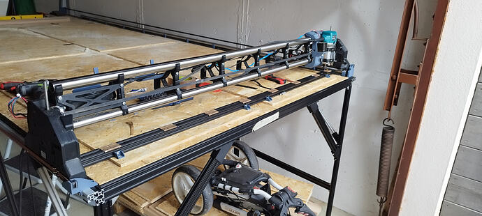

Hello everyone — greetings from Germany,

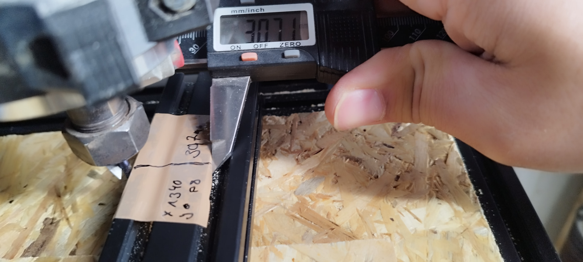

I have the machine Low Rider finished as far as and. Everything checked. I also carried out the squaring. Successful. During the last inspections I noticed that the x-axis does not produce a straight line, but something like an arc. As can be seen in the picture, I carried out the measurements from left to right and zeroed all axes. I measured with a caliper. The measurements were taken using a 4 mm cutter against the groove of a 4020 profile. I aligned the profile with the two endpoints of the milled path, and that’s when I noticed the error. I measured a deviation of about 3 mm in the middle of the gantry; toward the ends the deviation decreases again.

Are your X rail tubes straight?
The core will follow the tubes, so if they are bowed, your cut will not be striaght.
Yeah, that make sence, as far as i can see the Tubes are Straight.
How i can check this to be sure ?
A laser level/line is the fastest route
Are you using temporary struts? It might be possible that the gantry is flexing/bowing in the middle under load.
this is how it looks
A low-tech way is to roll them on the floor to see if they roll straight or have any lift along the length. That’s how I tested them before buying them.
I check by rolling on flat surface before assembly as Vincent noted.
You could try to loosen the clamps and rotate the X tubes 90 degrees. If the tube does have a bend, then that should move the change to the Z axis. When I assemble, I always try to have any bend pointing up to try to offset sag due to weight of the router.
Your permanent strut plate may also help pull things straighter when you get those cut and installed.
It looks like you have temporary strut plate? Have you cut the permanent strut plates?
I’d say that the permanent strut plates would solve your problem. :slightly_smiling_face:

It probably makes sense to insert the permanent structure first and then see if the problem is solved.
This is your best place to start. Get the struts installed because you will need them regardless of the problem.
Just a note to mention that you should include a finishing pass when cutting your struts.
If the problem is indeed that the gantry tubes are flexing under load, the initial roughing pass will most likely be a bit bowed. The finishing pass will have a lot less load, so should clean things up somewhat (less load, so less flexing).
