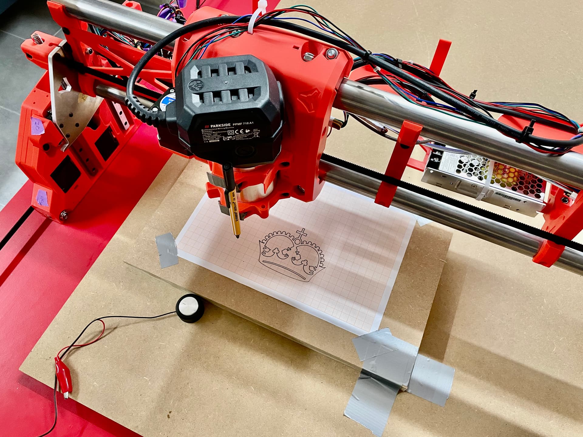

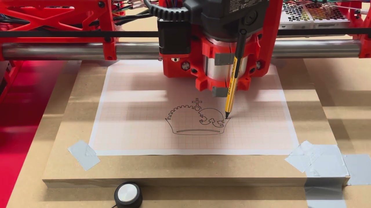

I am currently building a ~1x1m LRv4 and wanted to share my progress here. Some progress has already been made, so this first, longer post will summarize what has happened up until I drew my first crown with the machine this evening.
Intro
I am 35 years old with a background in IT and 3D printing, but I have no prior CNC experience and am based in Bavaria, Germany.
The machine has a square working area of 1.05 x 1.05m, is controlled by a Jackpot3 board, and is built primarily for processing 1x1m sheets of birch multiplex. The title of this thread is inspired by @Jason_Toops’s “Green Machine”.
While I initially considered to go with an expensive spindle from AMB or similar from the start, I ended up choosing a very €75 six-speed router from Parkside (a brand of the European supermarket chain Lidl). The reason is simple: I am a CNC beginner and this router let’s me test the limits of the machine more freely while also massively reducing the complexity of the build. I’ve already destroyed a 2€ Stabilo pen while testing :smiley: You might ask, “Why not the default Makita?” Paying €40 for the required adapter/collet for a €140 router was a ratio I just couldn’t justify.

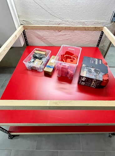

Table
I built a simple table using materials I already had on hand (leftover profiles from storage racks and roof battens), plus three 19mm particle boards from the local hardware store. I chose the red laminated boards because they were actually the cheapest option (the store wanted to get rid of the color).
For the feet, I chose these leveling casters and connected them with a custom 3D-printed adapter. I wouldn’t necessarily buy these specific casters again—the feet are hard plastic rather than the rubber I had hoped for—but they do work.
One thing to note is that the CNC does not sit on the top of the table, but on the middle level because the top working surface (which sits loosely on top and can be lifted by hand) is needed much more often than the CNC itself.

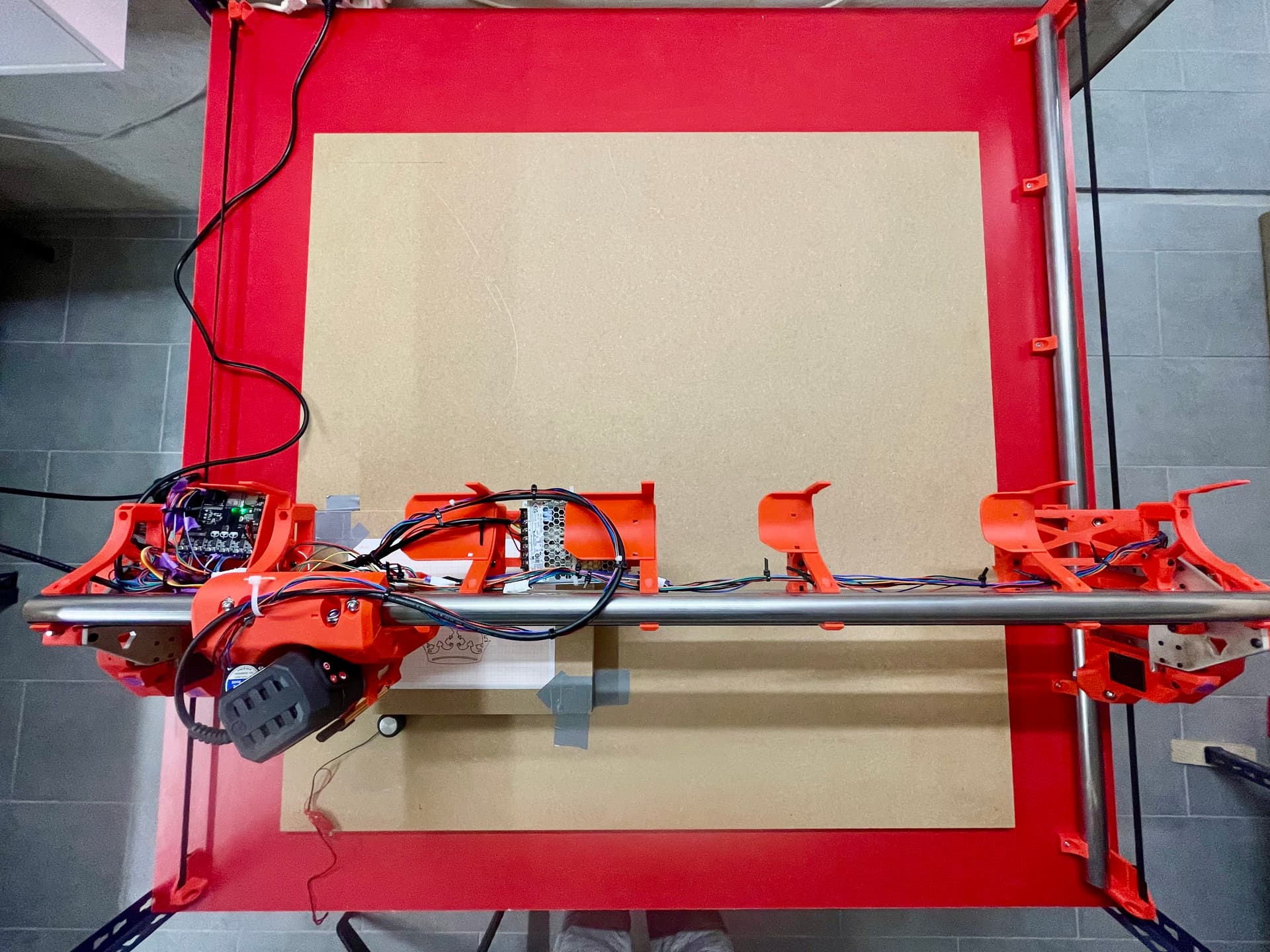

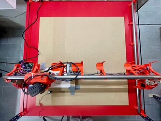

Building
All in all, the assembly was great fun. What took some time was figuring out the required wire lengths, slotting some of the wires through the YZ plates, and some of the M8 screws/nuts were difficult to screw together all the way due to the hole sizes.
Suggestion for improving the instructions: It would be helpful to include rough estimates for the endstop wire lengths relative to the axes’ lengths.

I work a lot with Fusion360 for 3D printing, but I wanted to stay on the supported path, so I chose Estlcam to start my CNC journey. Since I am on a Mac, emulation was required, but it works surprisingly well.
For anyone interested, and without any support, here is how I got the most recent version of Estcam (v12, 64bit) running on an M2 Macbook:
Instructions

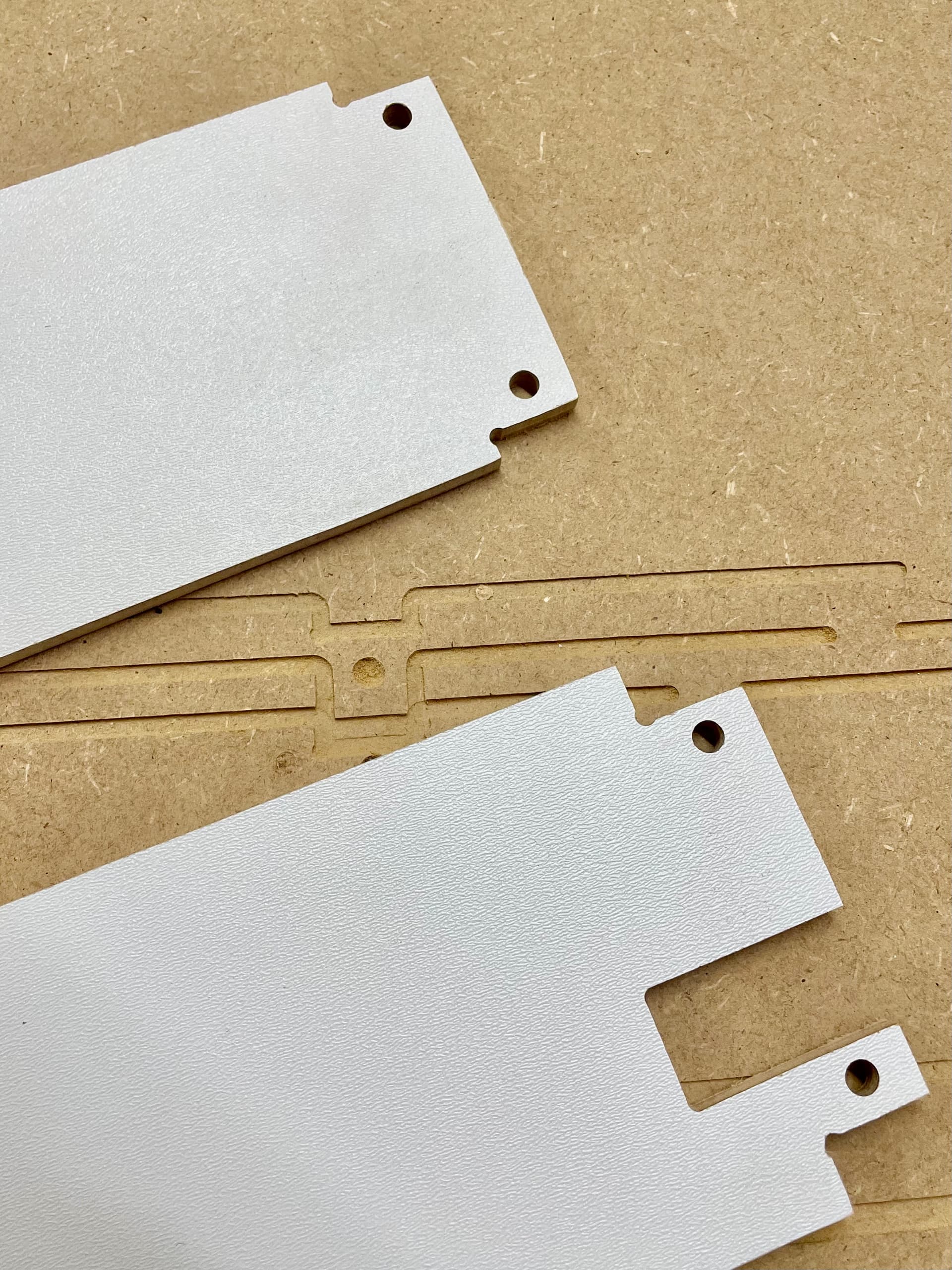

After half a day of getting to know the machine, 5mm fiberboard strut plates are now cut :slight_smile:
I used this 4$ Down Cut Router Bit 1/8 Shank 2 Flute bit with 1mm depth of cut, 20mm/s feedrate, 3mm/s plunge feedrate and a plunge angle of 30°. Getting there took a few tries to figure out feedrate, rpm, depth of cut, required collet tightness, … - good thing I had purchased a spare board for this :smiley:
Test cuts came out 2mm too long, so I just “cheated” and regenerated a 2mm shorter strut plate svg which came out spot on. Seems I still need to do some additional calibration after installing the strut plates.
What I did not consider initially was that my MDF spoil board is harder than the fiberboard I am cutting. After the bit tip reached the MDF, the fiberboard settings were too slow and the machine slid off the planned path. What’s common to address this - use the settings for the hardest material (workpiece or spoil board) for everything as I did?
With more power/rpm I was able to get the strut plates cut. However, at the beginning of the last precautionary 1mm cut path downwards (to safely clear all of the workpiece), the bit again deviated from its path - luckily away from the workpiece, which was already finished by then. Any ideas on what could have caused this and how to resolve it?

Nice workaround, but be sure you go back and address the root cause.
Double check that your core is not wobbly on the beam.
The video isn’t loading for me- what speeds are you using for your cut? Are you using a finishing pass?
