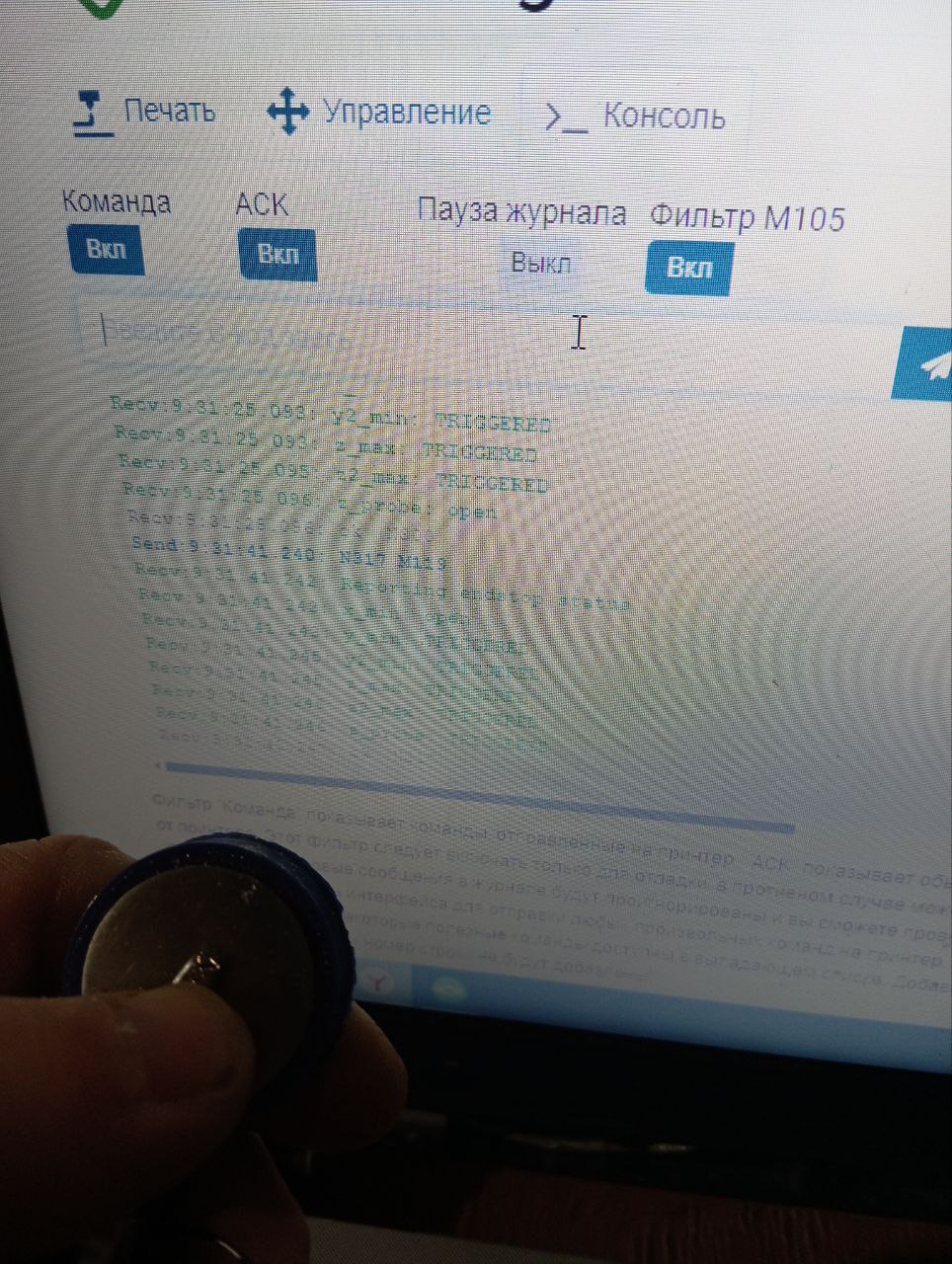

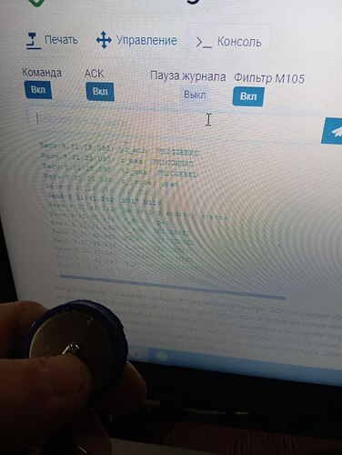

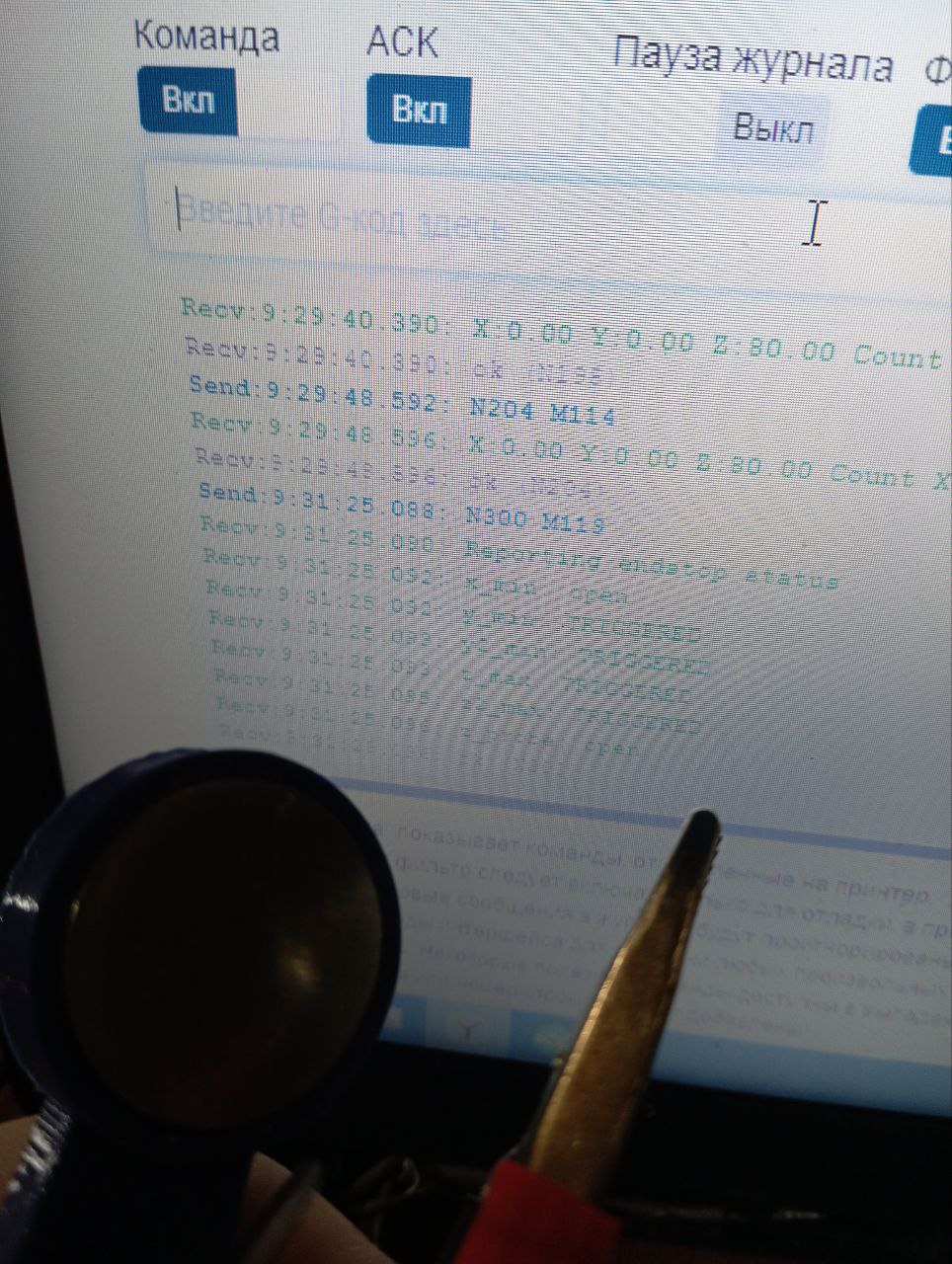

This is my milling cutter touch sensor. When it is open, the response from Arduino is that the Z-probe terminal is open. When I close it, the response from Arduino worked. The photo doesn’t show it very well.
Openned

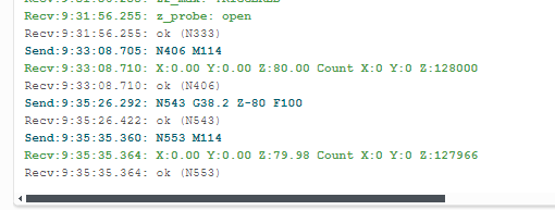

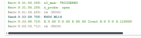

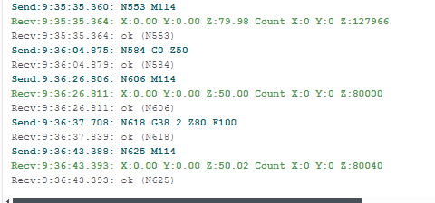

Through the Repeater-Host Server, I tested the G38.2 command and took screenshots
Zprobe1
:point_up:All axes have been sent home
Zprobe2
:point_up:I try the command, the sensor is open. Although the M114 command shows that the Z axis has shifted a little, but not by ear or at first glance it is not noticeable at all :slightly_frowning_face:
Then I tried to shift the Z axis from the house down by 50mm and use the 38.2 command again, and again with no apparent success

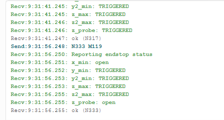

Zprobe3
At the same time, the sensor was open all the time
I changed the arduino mega 2560 and ramps 1.4 to new ones, the problem with G38.2 disappeared (everything works as it should) and parking on X is ok (not stopped and kill machine on move from long distance).
