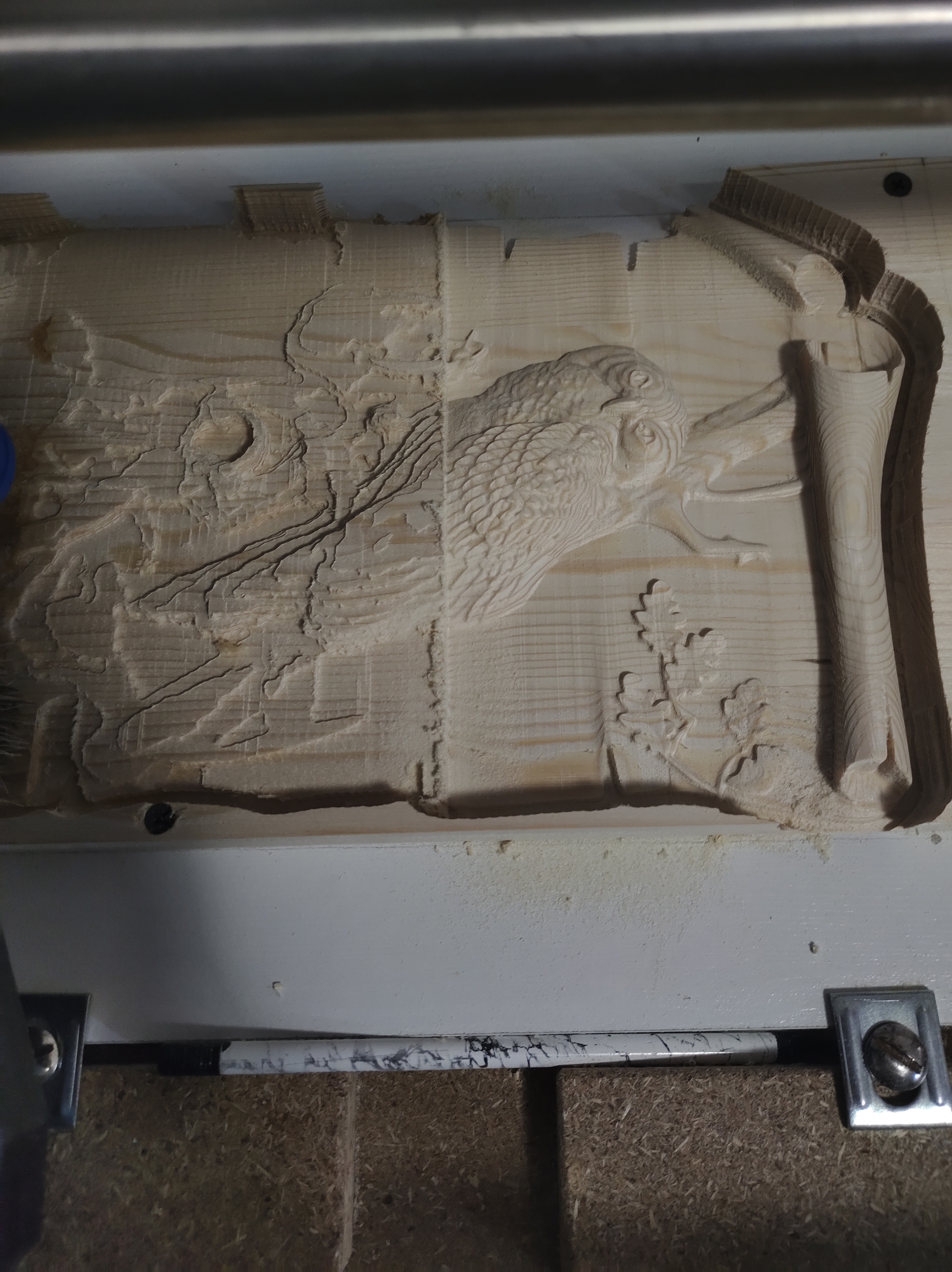

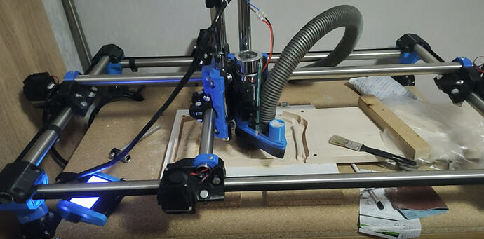

Years ago, after buying a 3D printer for my son (back in 2021), I printed and assembled an MPCNC using standard steel pipes—though, unfortunately, they eventually rusted. I rebuilt it using stainless steel pipes and, as it happened, my first project was a birthday gift for my mother. It is a very popular design in Russia; we call it “Sova na bereste.”
I used a tapered ball-nose end mill (1mm radius) and a 2mm “corn-tooth” (burr-style) roughing end mill from AliExpress.

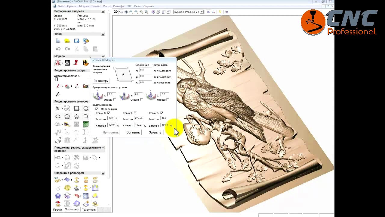

I prepared the G-code using ArtCAM. I even modified the default template so that my RAMPS 1.4 controller could interpret it using Marlin firmware.

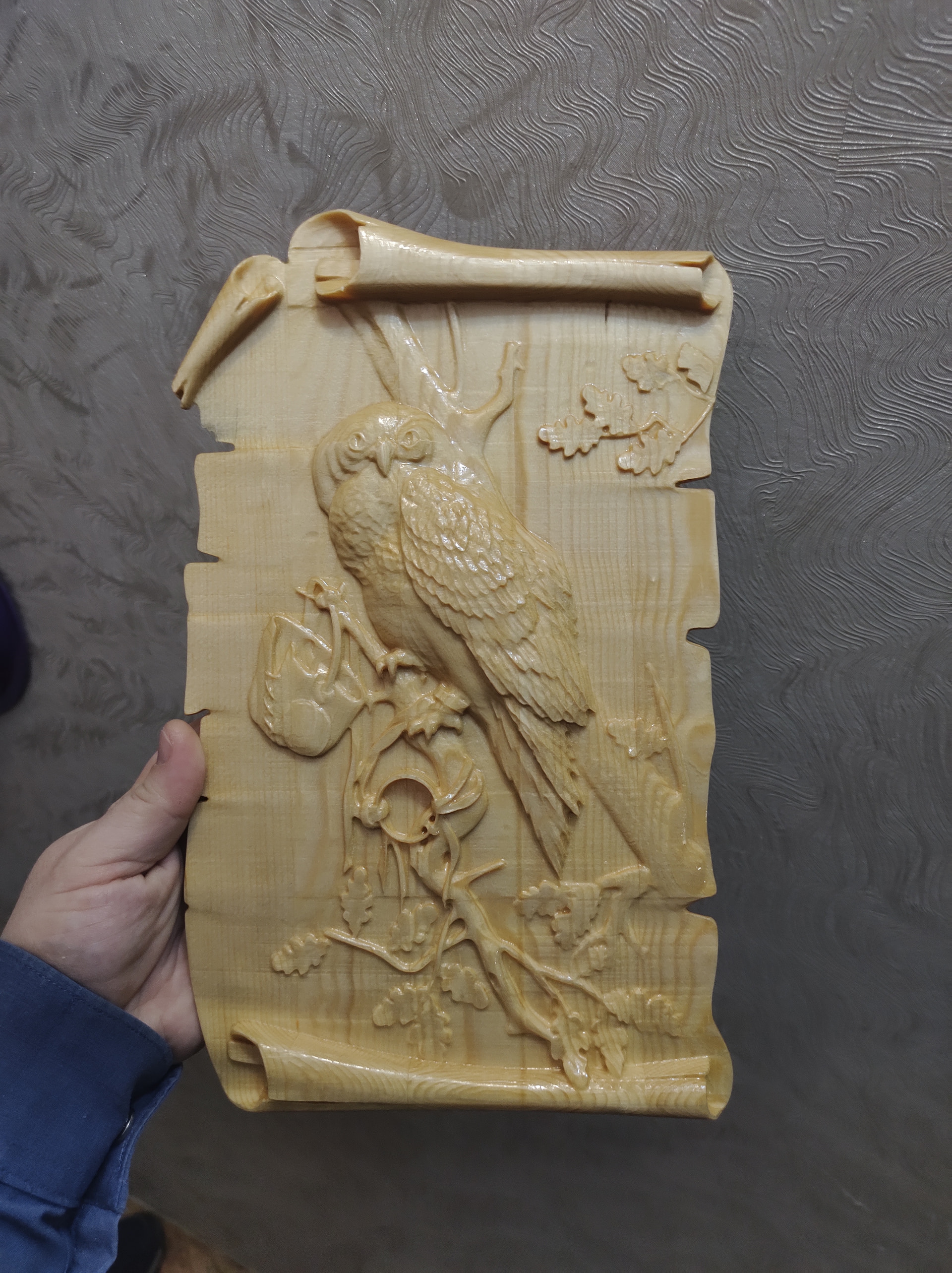

That is amazing! How did you do the top and bottom curl ?
There’s a greeting on the back, the content is too personal to post. I did the milling of the text before cropping along the contour. The workpiece was fixed with screws to a blackboard.

It’s an optical illusion. The workpiece is machined on one side; on the other, I simply rounded it off with sandpaper to give it a round shape.

The material used was a tread made of pine from a hardware store. I probably went through about 30 of them before I could choose a decent one. Pay attention to the video — it was filmed more than 9 years ago. When the mpcnc project was taking its first steps. But thanks to Ryan, this is now accessible to almost everyone.
