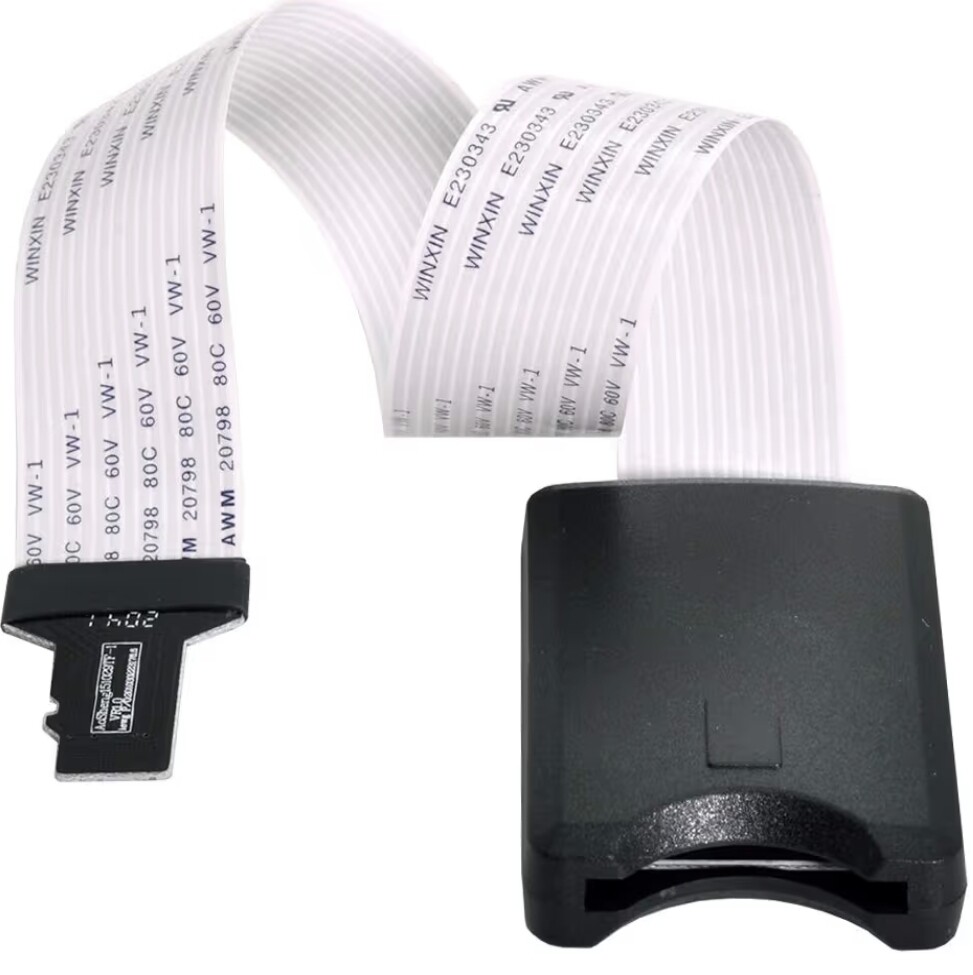

Yea, I need a micro SD card. I see I have some old regular SD cards. I think I’ll just buy one of these.
I have one of those! They work well!
