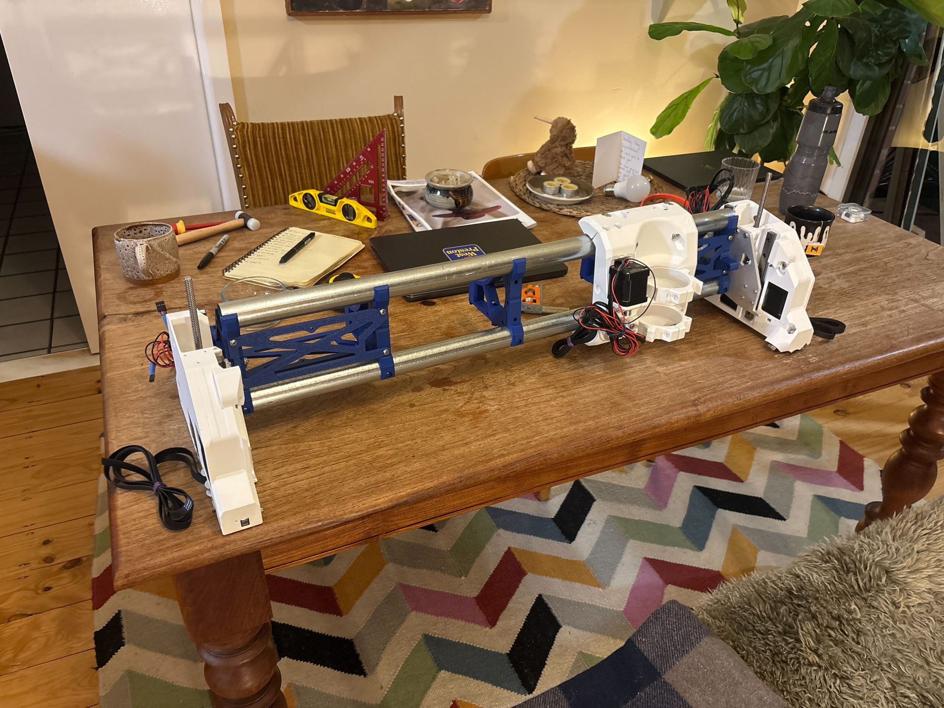

Late update but I got some friends together over a couple of weekends and have built the gantry.
Assembly was extremely smooth for the most part. We appreciated the thoughtful touches like through-holes for screwdriver heads. We were often joking:
The Vicious One provides yet again
