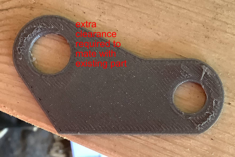

That didn’t work out very well, so I decided to try something different: brackets similar to those used in Y and Z rails.
The bracket on the left was one that I designed, the one on the right I found on Thingiverse.
Owing to the poor fit of the Thingiverse bracket, I designed a shim.
Note the poor clearance for one of the bolts: you cannot screw the nut on it.
I wanted a better fit to the existing V1 Engineering part.
This part I designed in Fusion 360. I am a novice, so this is a research effort at the moment. I care greatly about the law so I have tried really hard to understand copyright. This has proved much harder than expected and I am still researching it.
The bit on right I designed from scratch, using measurements from the V1 Engineering part. Those measurements were taken from both the stl and the physical object.
The left hand side is based on an STL from V1 Engineering that I converted into a BREP, then cut down to a usable primitive before mirroring it the then joining it to the right hand side into a single part.

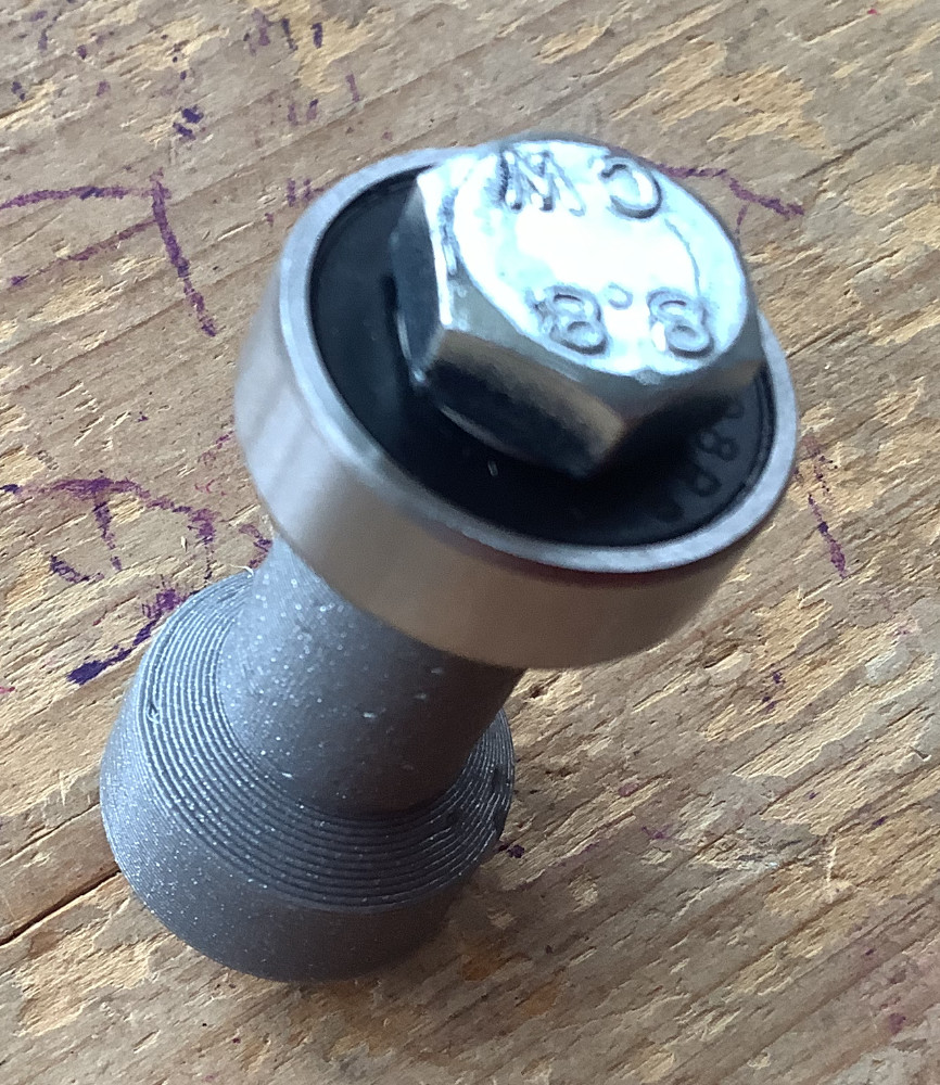

In any case, I rapidly found I needed a way to securely hold the bearings with my M8 40mm bolts and nylock nuts. So I have spent time learning how to use Fusion 360 to design a primitive to do that.
Here are some prototypes and some slices to confirm fit and make minor adjustments.
These 3 pictures are the “final” version that I will use in the part that I am designing. The idea is to have a part that plugs onto the Lowrider with minimal adjustments. Because I am targeting things I have at hand (i.e. M8 nylock) this makes the design specific to my needs: but that is the whole point of owning my own 3D printer and CNC.
