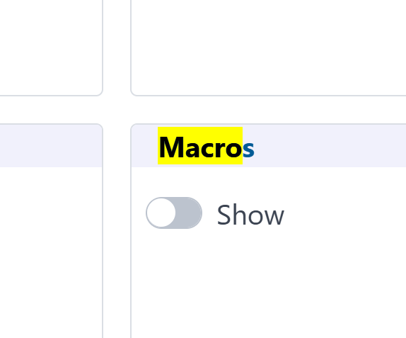

So was just going to build my own save macro. the wiki shows this as the option to do so

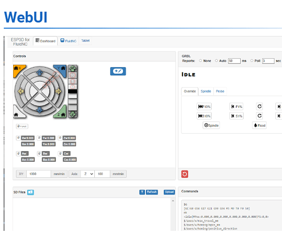

However my WebUI looks like this.
I’m not seeing any option to build a macro… someone point me in a direction?

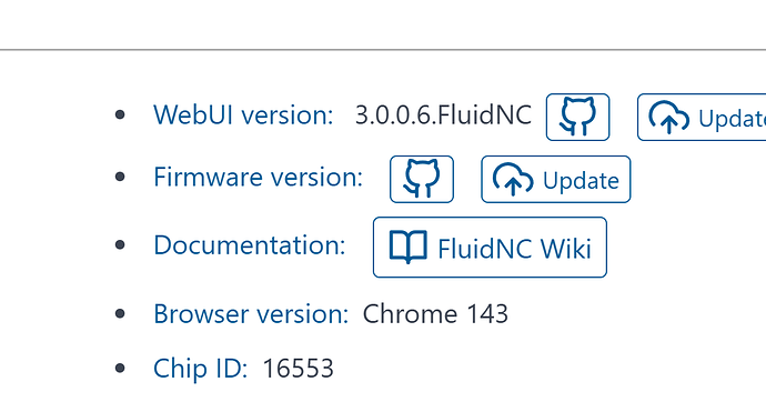

You have WebUI V3. It should have the save macro as well. Did you update your board since you got it or is it still the same flash that Ryan put on it? Assuming you got it from V1 and not Elecrow
I got it from V1. I have not updated anything. Figured it didnt need anything. The only save buttons I see are on the settings|features and interface tabs. I see no macros area at all.

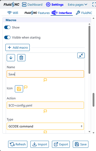

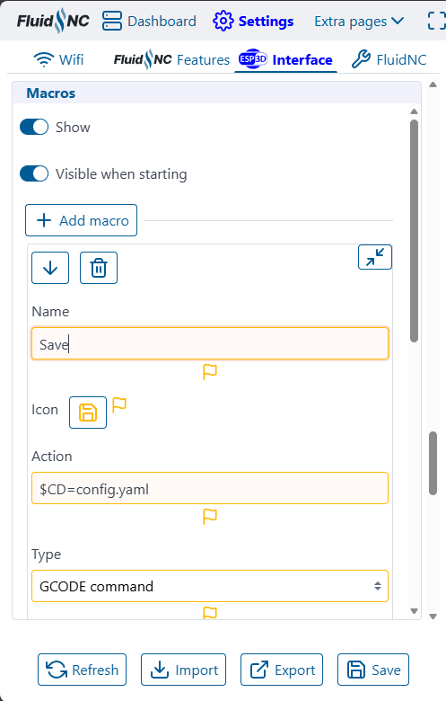

Settings → ESP3D Interface → Add macro:
Use these settings and click the Save button at the bottom.
There it was. thanks guys.

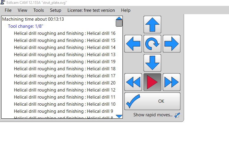

Oooooh I bet you guys missed me… So i’m going over the prerequisites for cutting the strut plates. got through the initial stuff in estlcam without much issue. The simulation in the CAM runs in about 15 minutes… I loaded the gcode to the machine and went to cut some air. The movement was almost impossible to see. Probably another “Hey look under your nose dummy” but I appreciate your time.
What do you mean by that? Moving too slow/fast? Moving too long/short?
I’m guessing too slow? If so, show your settings under Tools → Basic settings. I have it setup with Feedrate units for Estlcam as Millimeters per second and CNC controller as Millimeters per minute. If you are entering mm/s values that are actually moving in mm/min, it’s going to be super slow.
Change this to millimeter per minute and regenerate the gcode.
This means it’s putting mm/s values in the gcode that it’s treating as mm/min. So, it’s 60x slower than it should be.
