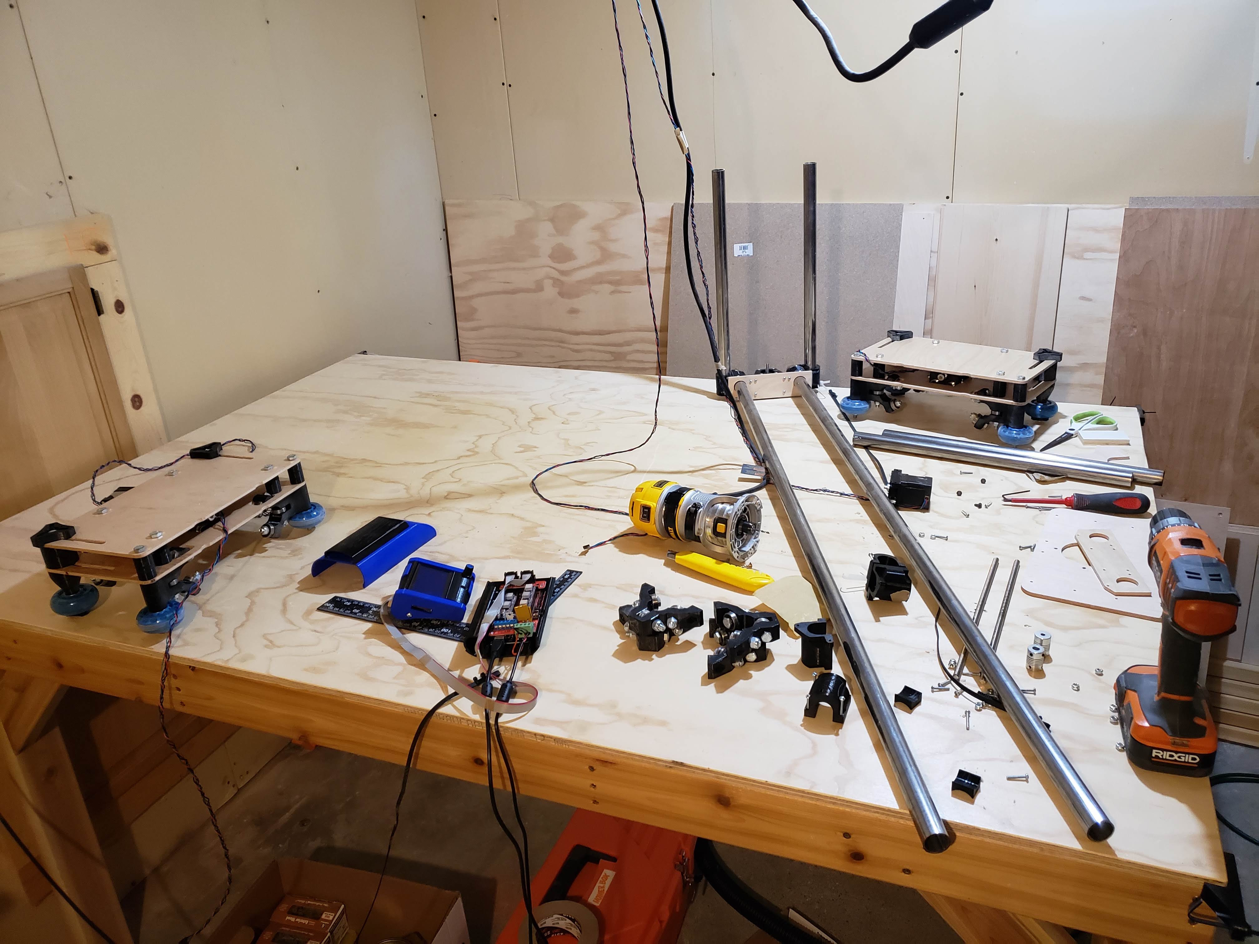

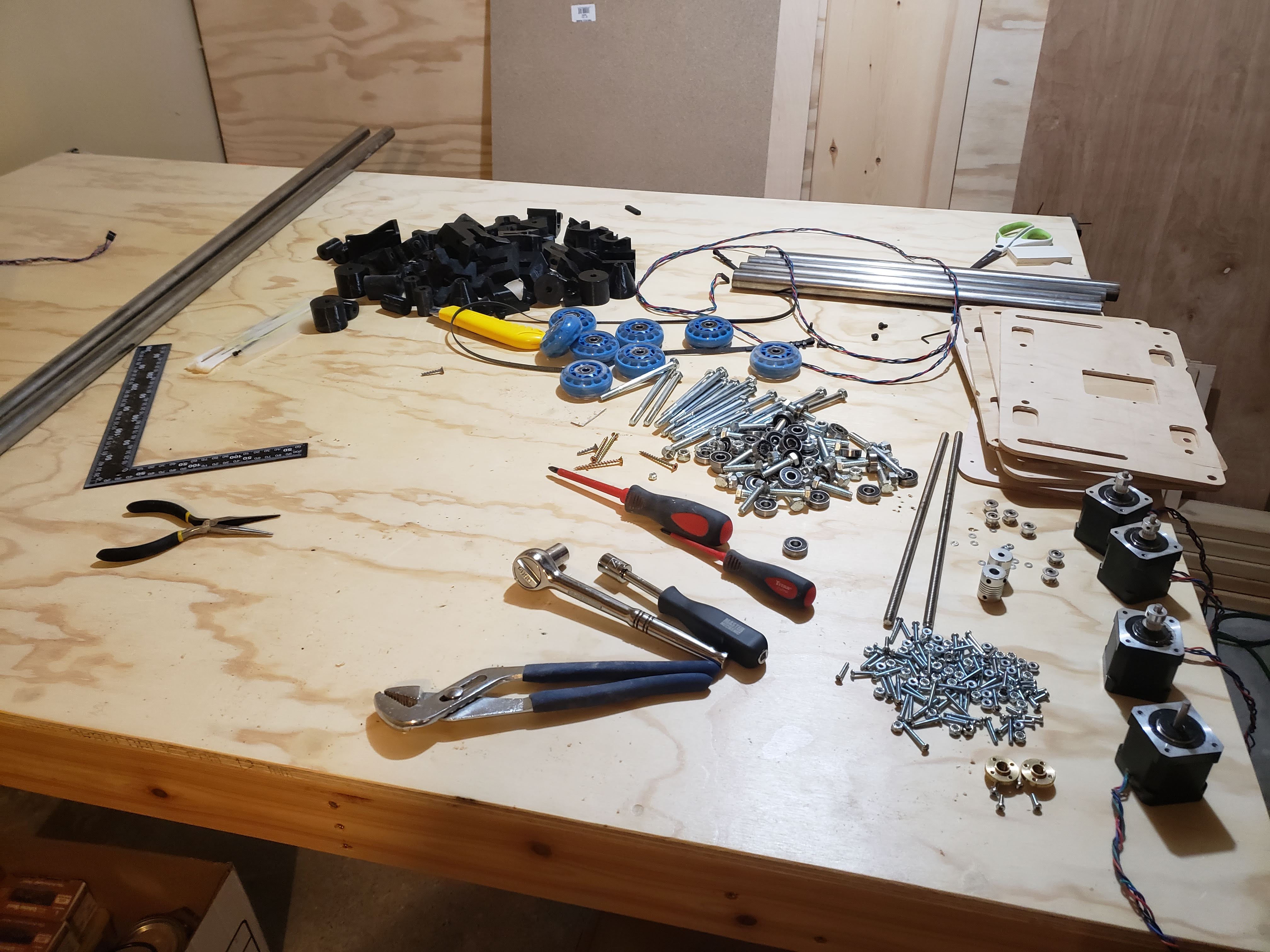

Well, I decided to do the upgrade to the Lowrider2. Took the whole thing apart and organised all the parts, had a buy some more bits and bobs but not too bad overall. I know I read that plywood might not be good for the sides, but this stuff I found is pretty tough and looks really nice to boot. So I’m thinking it’ll be okay. printed the parts over the last week. So now I’m just waiting on the wider 10mm belt and parts. In the meantime, I have one half built, and I should be able to get it assembled here today or tomorrow maybe.
I really like the new version so far. I’ll be outfitting this one with all of the suction and everything from the get go this time. So that means Ill need to get some angle stock for the hose/wires. I like that whole suction and wire organization a lot on Ryan’s setup: very clean.
I need to ask a dumb question though to make sure I’ve got my drivers set right on my RAMPS. Cant find where I referenced last time. What should the Voltage be set to on each? The Y and Z are wired in series and the X is on its own.
New halves:
[attachment file=69888]
Tearing it down:
[attachment file=69889]
[attachment file=69890]

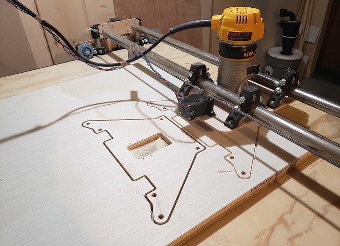

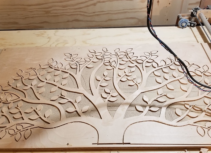

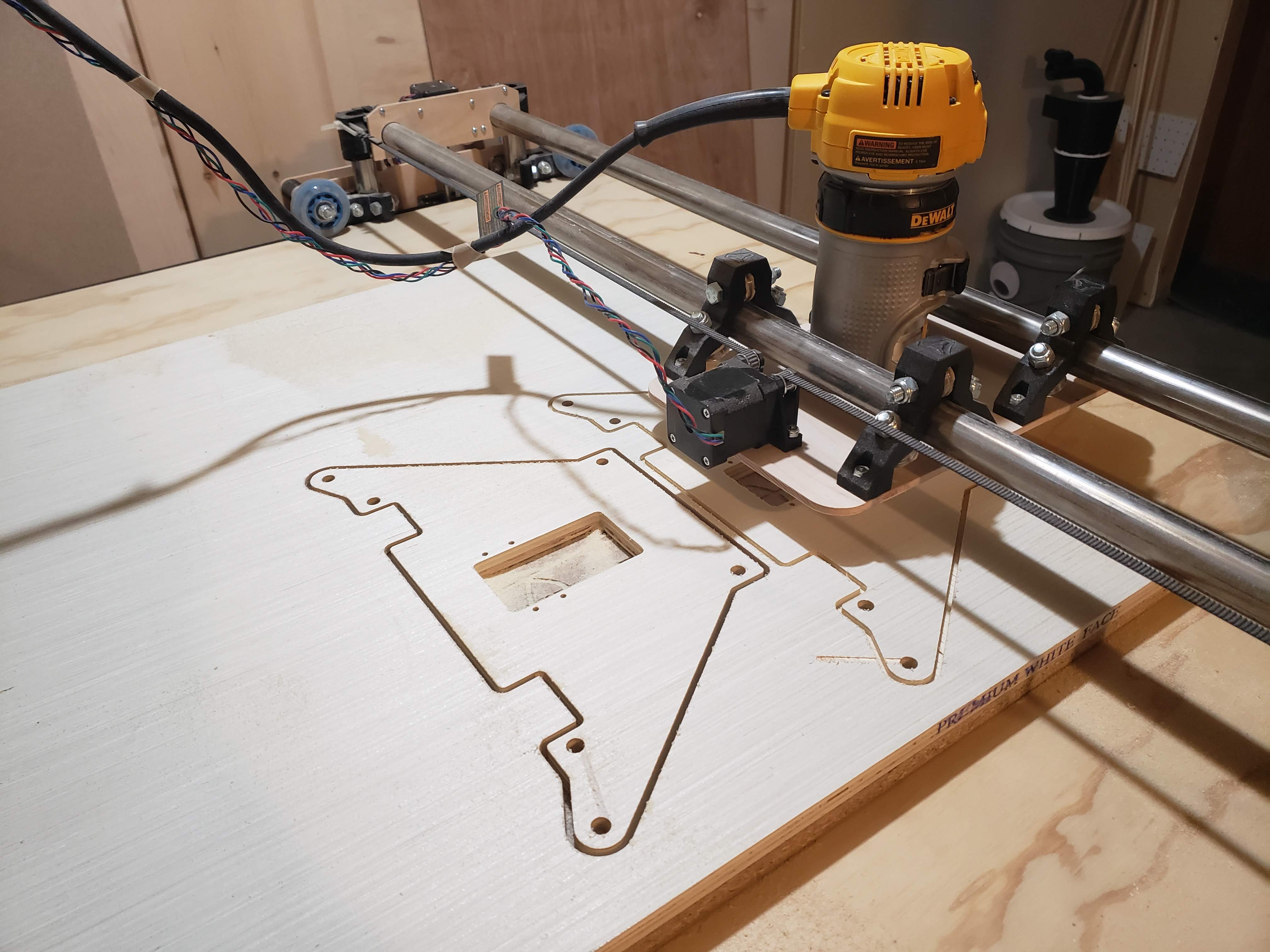

Cut this out a couple weeks back, came out great, except I was having issues with my Z axis not raising correctly, hence the extra cut on the return trip at the bottom. So I just did it in one long, through-all cut. This new build will replace the motor I think was being the problem.

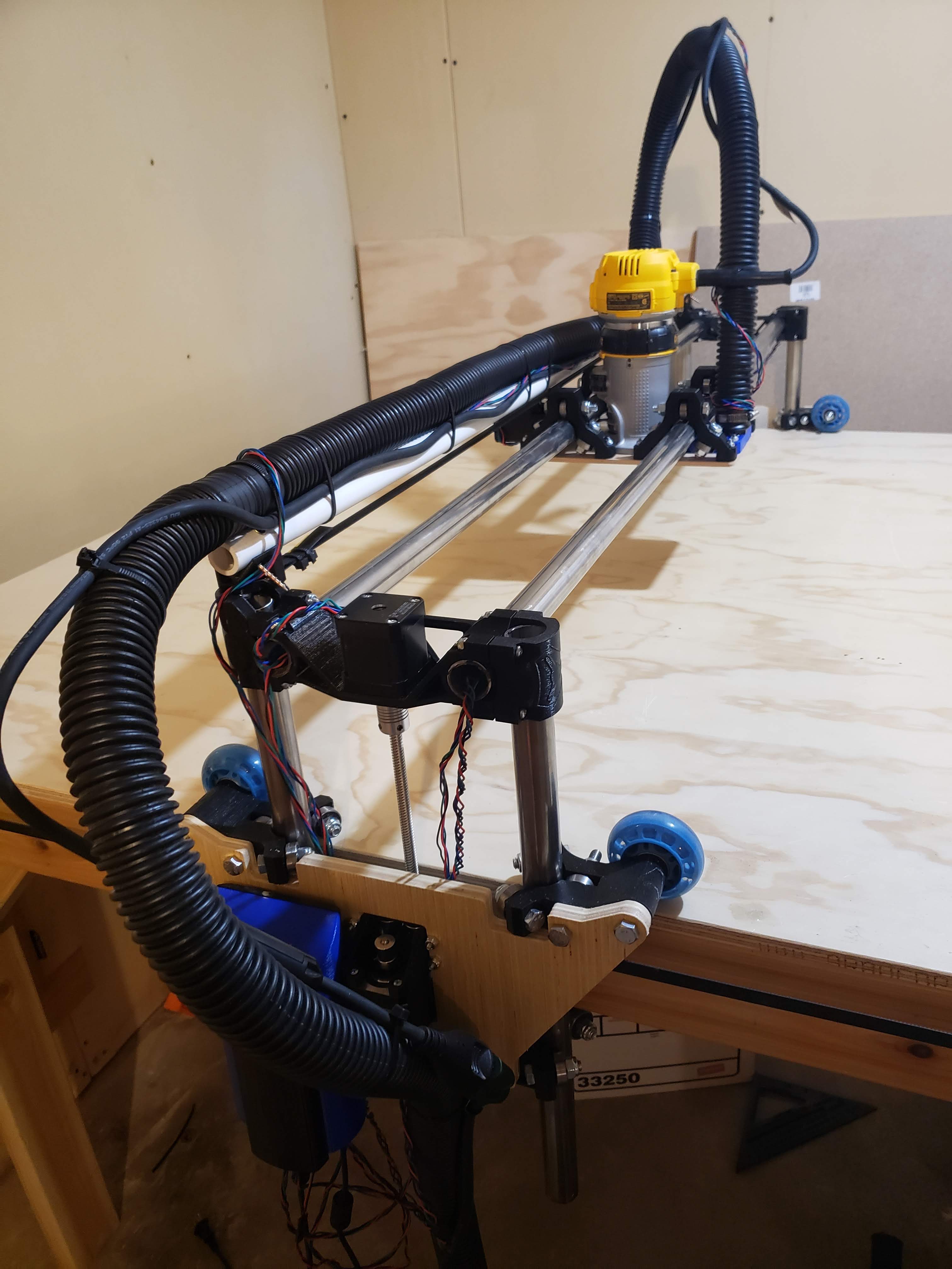

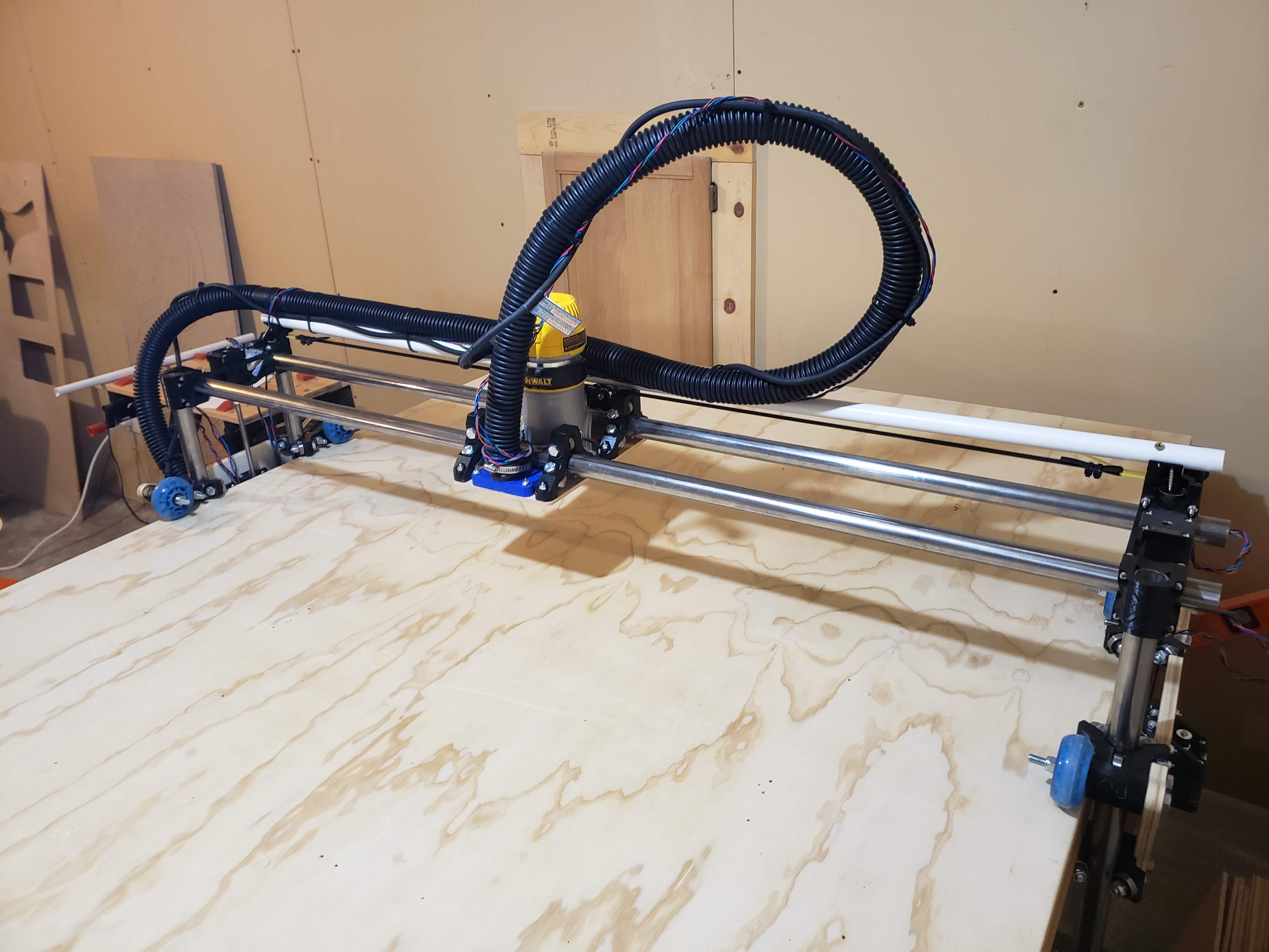

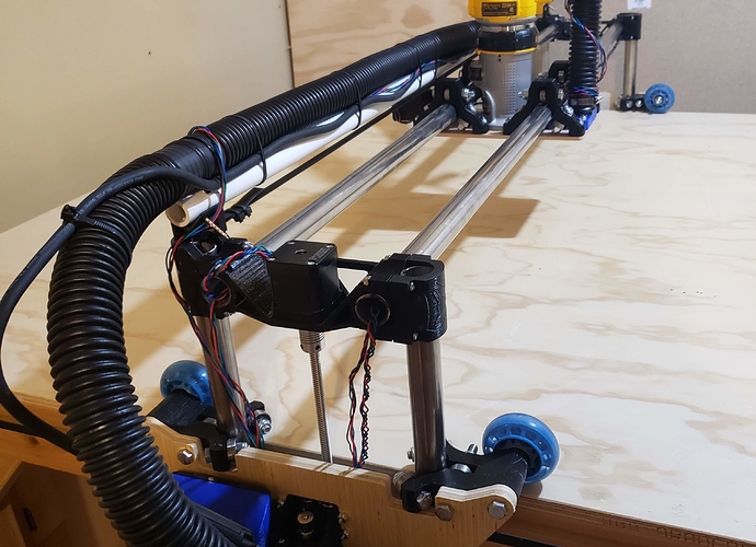

Got everything together and cleaned up. Ran some tests and calibrations last night and it all seems to be working great. Its definitely lighter than the previous design, but doesn’t seem to be a problem so far with anything. Cant wait to get some good runs in and really put it to the test. Suction fit up real nice and seems to be working just fine so far. A lot of sucking power on the cnc side so I’m looking forward to seeing that in action. I’ll probably add some kind of a soft foam shroud around the x plate. WooHoo!!
[attachment file=70737]
[attachment file=70738]
