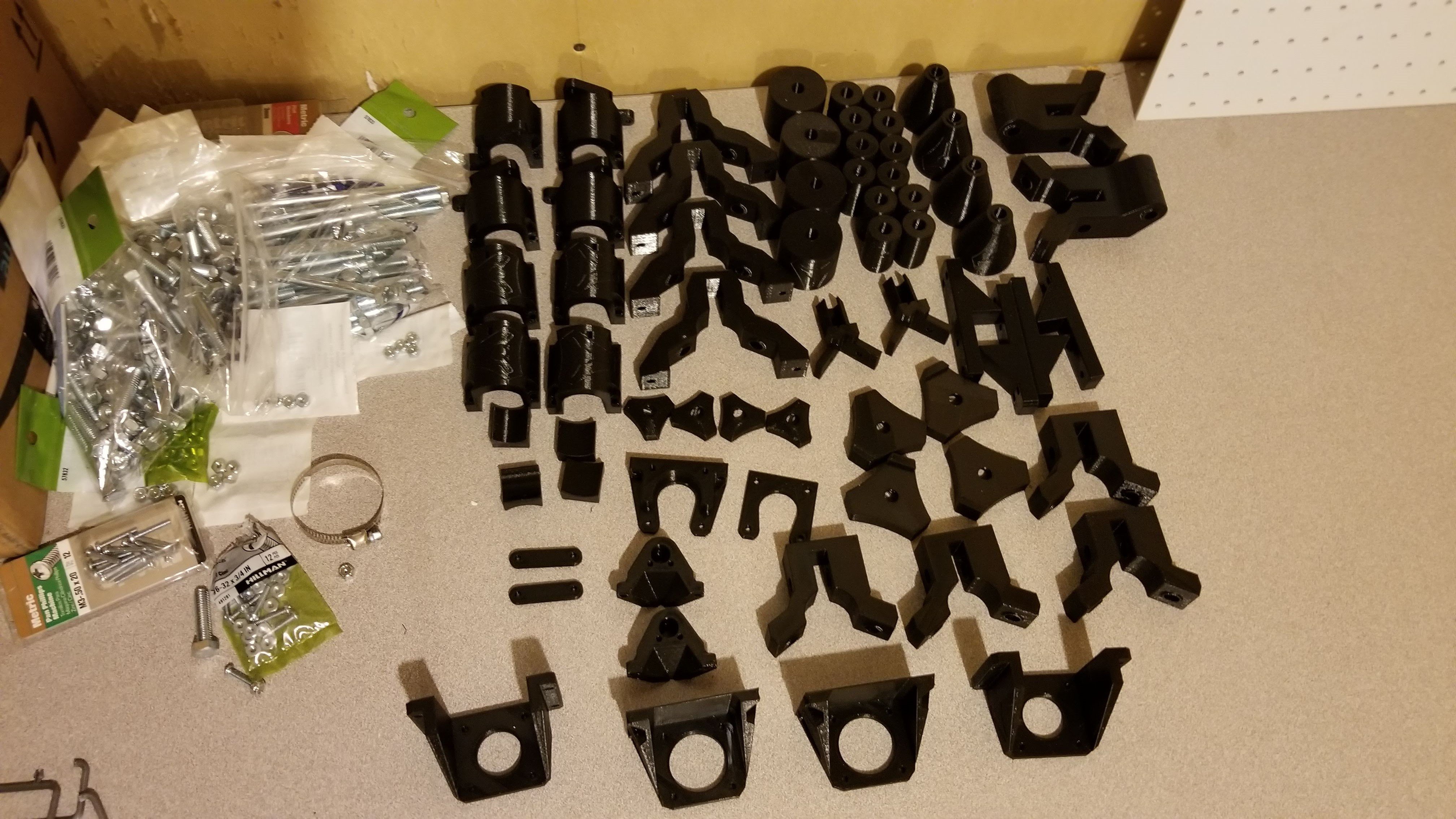

Hey Everyone, Starting my build thread finally. Making some good progress now that I have my M3 up and running. I really enjoyed seeing everyone’s builds and this is one of the better supported machines out there. Great community here, so I’m excited to finally post my progress.
As I’m getting parts together finally, it seems like the tubes seem to be just slightly too small. The printed pieces all seem to fit together really well with my cnc’d parts but its slightly larger than the 1 in tube. My tubes are for sure the 1 in OD and 25.4 mm, so not sure what I might be missing.
Has anyone else run into this? Will I maybe need to reprint these scaled down a little, or maybe use something to build up the tube like electrical tape? I haven’t fully assembled the x/y section yet but it seems like its not going to get any tighter.

Oh geeze, of course that’s it, lol, there’s a spacer. I’ll probably answer all of my questions if I just keep going.
smacks forehead
