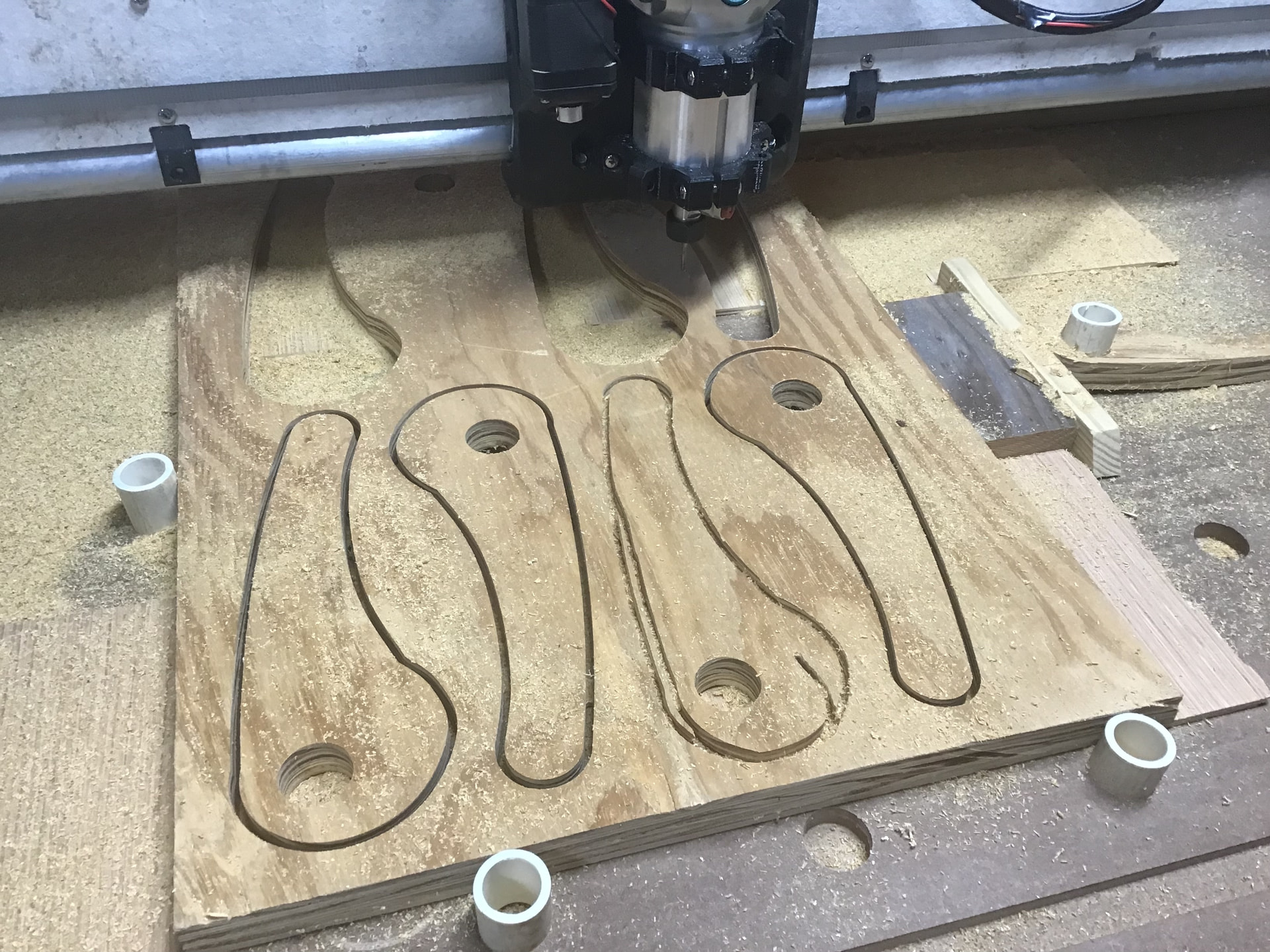

I’m new to CNC, both hardware and the software.
I was flattening my spoilboard, ran the same file 3 times without issue. I just kept resetting the Z zero. on the 4th run it was about 75% down the Y direction and 80% done in the X direction and acted as if was at the end on the run, came back and crashed because it tried to go beyond the physical limit. this was not photoed.
Today i was cutting and it did all but one cut just fine. as you can see in the pic it goofed. It almost looks like it was scaled down. The outside line is correct.
what would cause these 2 things? the controller, my G code ? it just happens?
using Carbide Create Pro to generate the G code if that matters.
2 things always come to mind.
1 always check the grub screws’ the screws that hold the pulleys on the stepper motor shaft.’
2 you may be skipping steps. Caused usually
By feedrates,dull bits or depth of cut. Plywood,rhe glue layers can mess you up
This has gotten me a couple times as I was learning. What works with a new sharp bit can’t always be done with a used / duller bit. I changed bits to a new one and it was ‘fine’ again. Same general idea, but what worked for one bit in plywood from one of the big box stores didn’t work the same on some nice quality dense plywood.

Is there a general guideline for the feedrate, depth and type of material?
