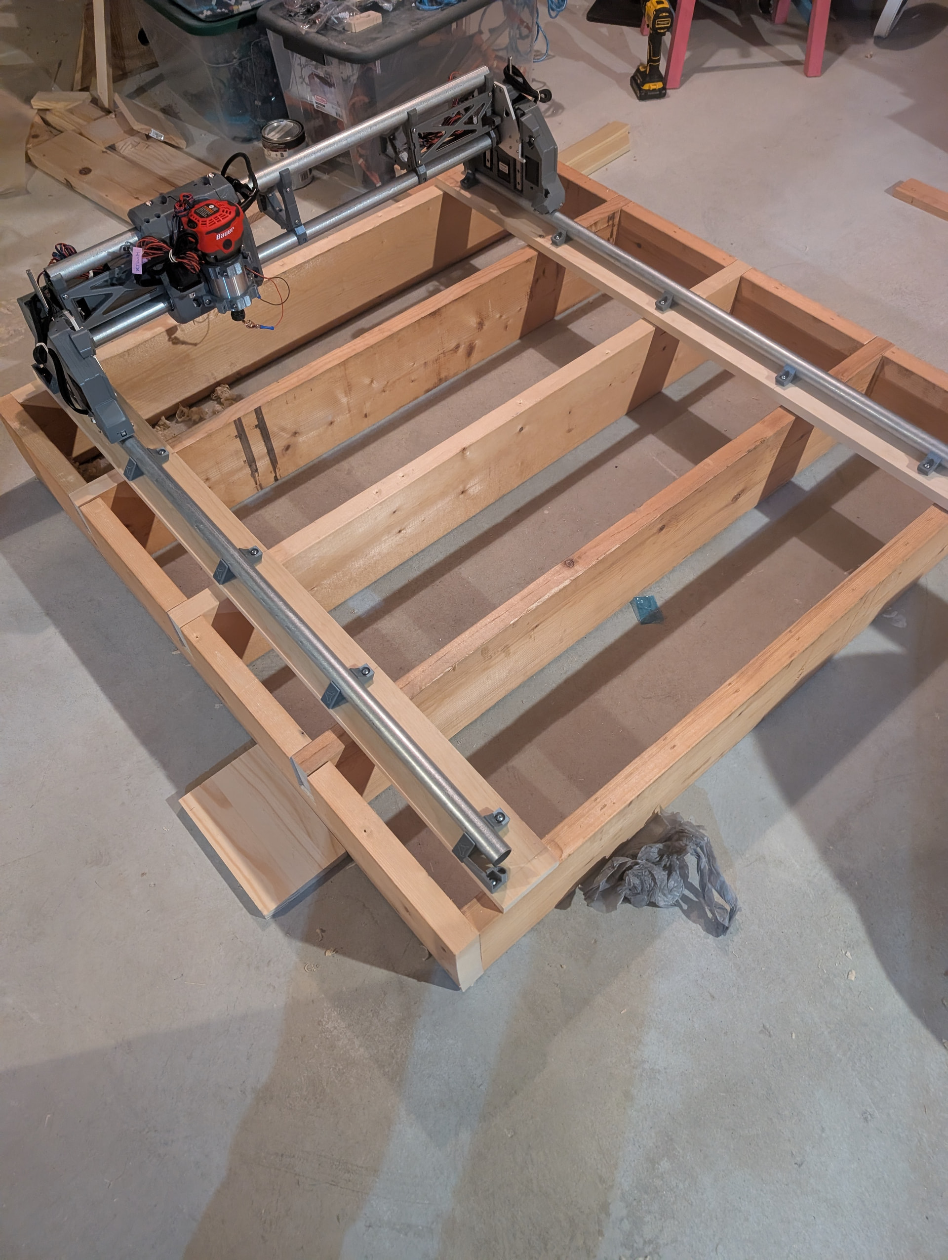

For me, I sadly just came to the realization, that yes… there was a reason one side of the gantry had a single set of bearings, and the calculator didn’t double the length of Y rail you needed.
Turns out Ryan designed the LR4 with a single Y rail to avoid binding, and I just tried to magic one in on full autopilot.
Oh shoot. Luckily that is a simple fix.
Hahaha, yes. Of all the things that could have gone wrong, a pretty harmless mistake.
The only serious downside of cutting a second Y axis rail, is the temptation to build a second LR4.
What is this downside you speak of?
Congrats on getting your build assembled and running! Seriously sturdy framing you have there.
