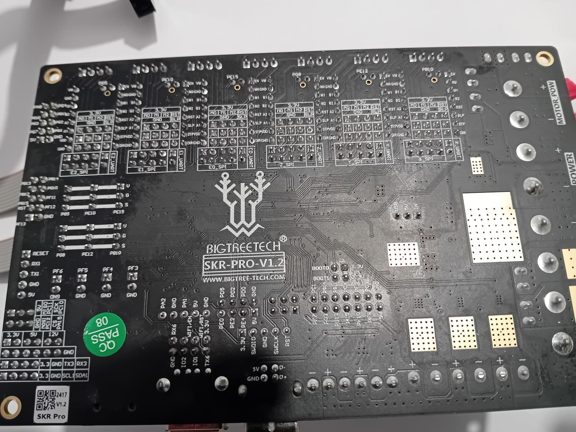

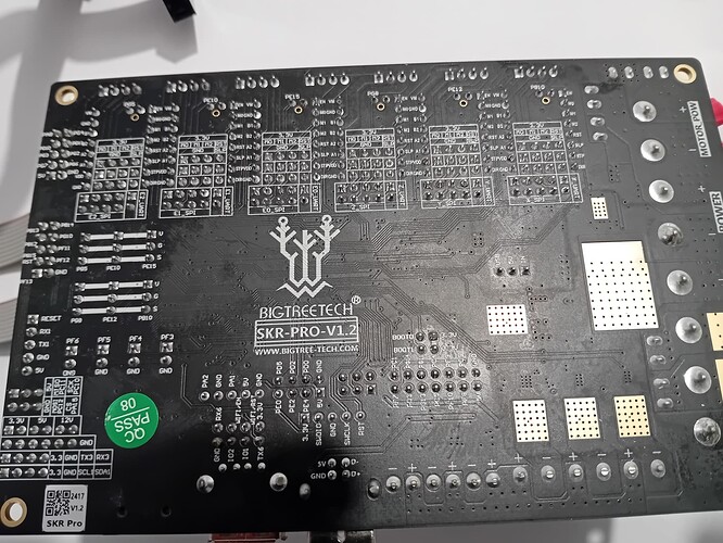

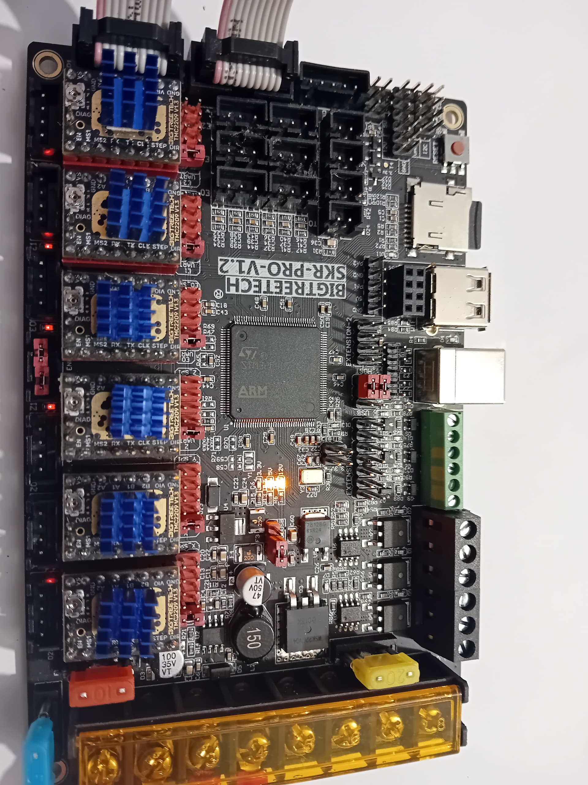

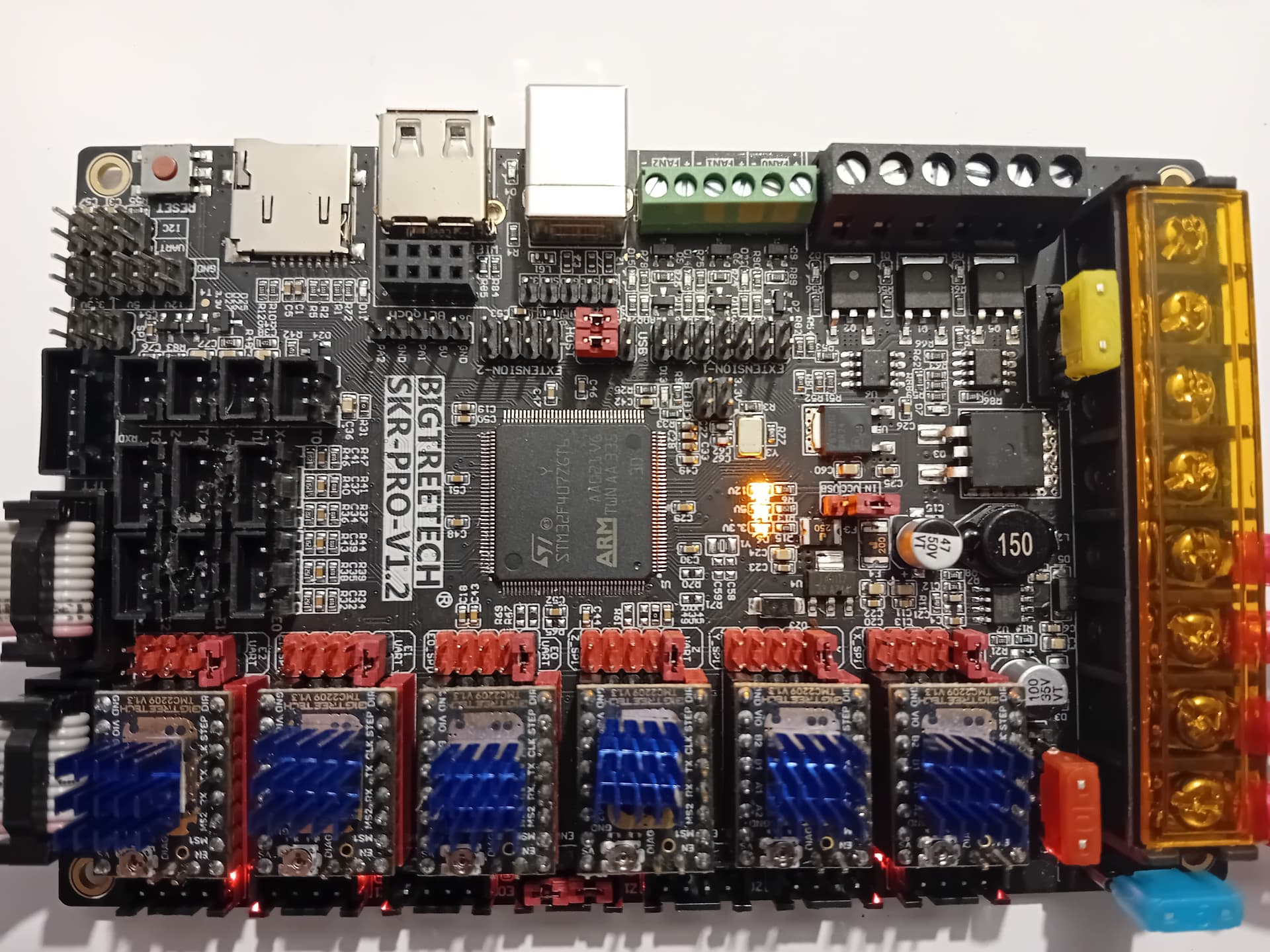

Can you start out with a good high-resolution picture of the board, top and bottom? If possible, take a picture of the board top when power is on so we can see the status LEDs. With and without the SD card if possible.

When inserting micro SD card into SKR the blue light flashes quite intensely and extremely briefly which seems to trigger the TFT on state.
I will take some photos shortly.

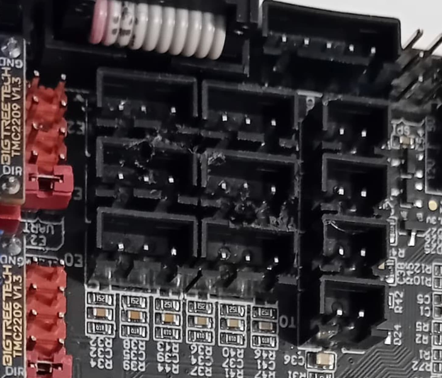

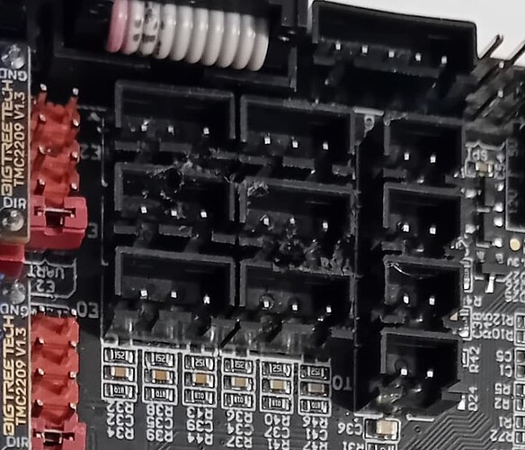

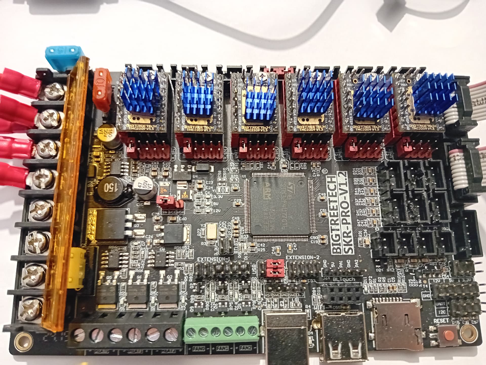

Why are these connector shrouds melted?

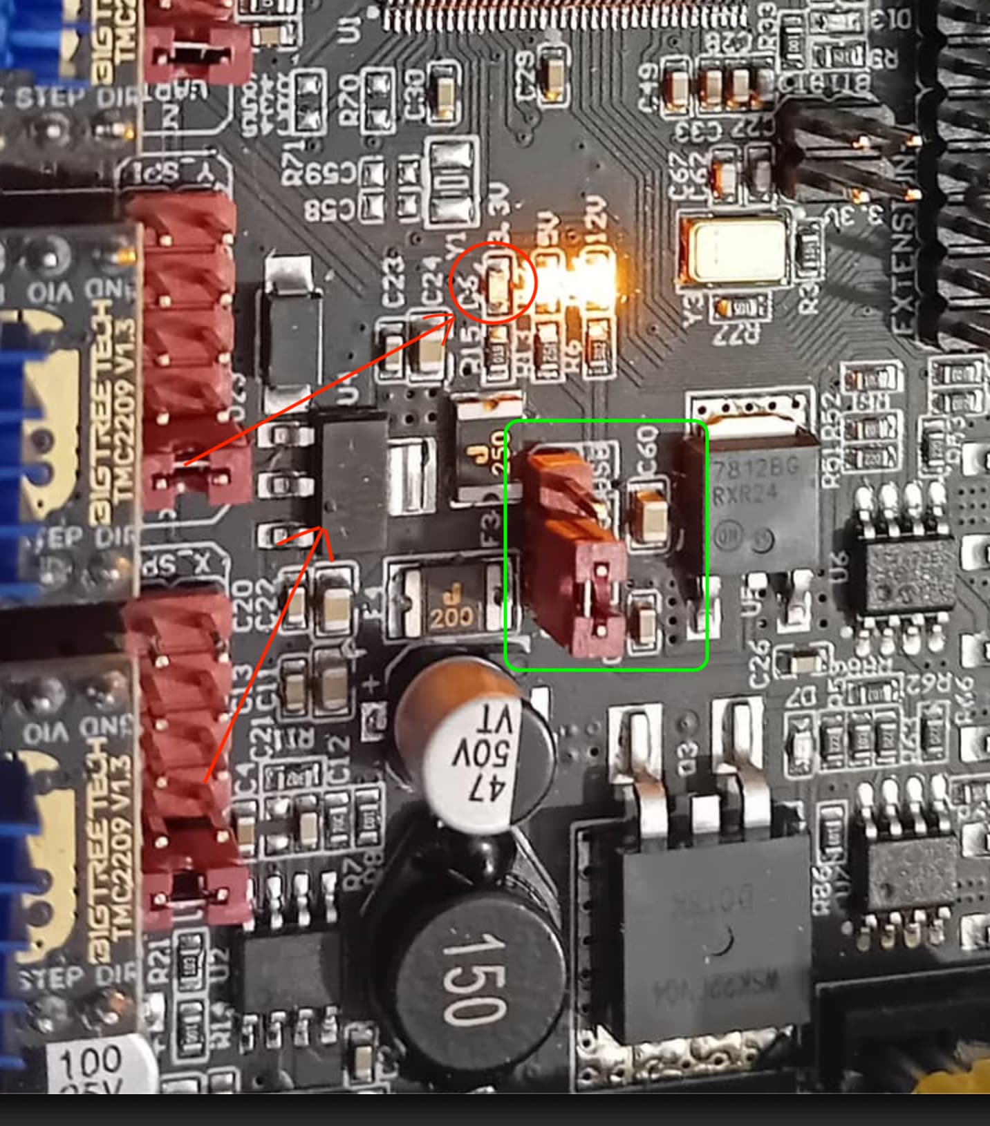

When the SD card is in, 3V3 is not present.
Note that the regulator I’ve annotated has a little spike in the case.
It may be damaged.
One last thing you can try is to move that jumper I highlighted in green over to the USB side, then plug in a USB cable while your SKR is off. Does the PC see it?
I suspect not, and I suspect this is a blown board.
some hot glue i had previously to fix the dupont connectors while I was waiting for JST connectors to ship. Did a bit more damage than I expected to the plastic.
I have tested with this jumper changed and indeed the PC does not see it.

You are correct that 3.3V is not present with SD card in. This I have only noticed now and verified reproducible.

When 3V3 isn’t present, the processor on the SKR is dead.
If you want to troubleshoot further, I’d measure the 3V3 and 5V rails with and without the SD card in.

The 3V3 regulator will blow if you short 3V3 to ground. Fun fact, the V+ pins on the end stop connectors are 3V3. So shorting V+ to G on the stop connector will damage the regulator. (Note that shorting V+ to Signal won’t damage anything, though shorting 5V to signal will damage the CPU pin. This is why the connectors are 3V3.)
Most likely, the V+ pin was shorted to ground, or to signal while the stop switch had signal shorted to ground. This would be the most likely point of failure.
Given the initial condition, however, it js possible that something conductive got into the SD card slot, where it shorted the 3V3 to ground when the SD card was out, and the damage to the regulator took a while.
Probably a replacement can do the trick. If you could solder in a new one, they’re cheap. Possibly an external variable resistor could be connected to put voltage into the 3V3 bus (the V+ connector on an end stop lug would do it, lol.)
The processor is likely not damaged, as it didn’t get overcurrent, but without 3V3, it doesn’t get power.
