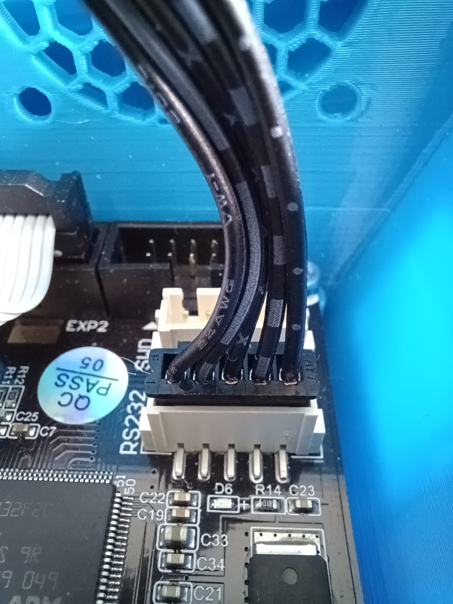

The wires on my TFT 35 screen are in different order compared to the connector in the build guide.
This is how the connectors fit on the screen and on the board for me.
Is it ok like this?
Don’t worry about the labels on the wires themselves, but do make sure that they are oriented correctly, as per the V1 build documentation (note the 5V pins on the black wire in the picture)…
https://docs.v1e.com/electronics/skrpro/#screen-tft35-v3-e3
On the SKR board, it looks like the 4 pin connector is reversed 180 degrees (wire with dots should be in the 5V slot farthest from the single wire, wire with long stripes should be beside the single wire)
I got it working, thank you.
