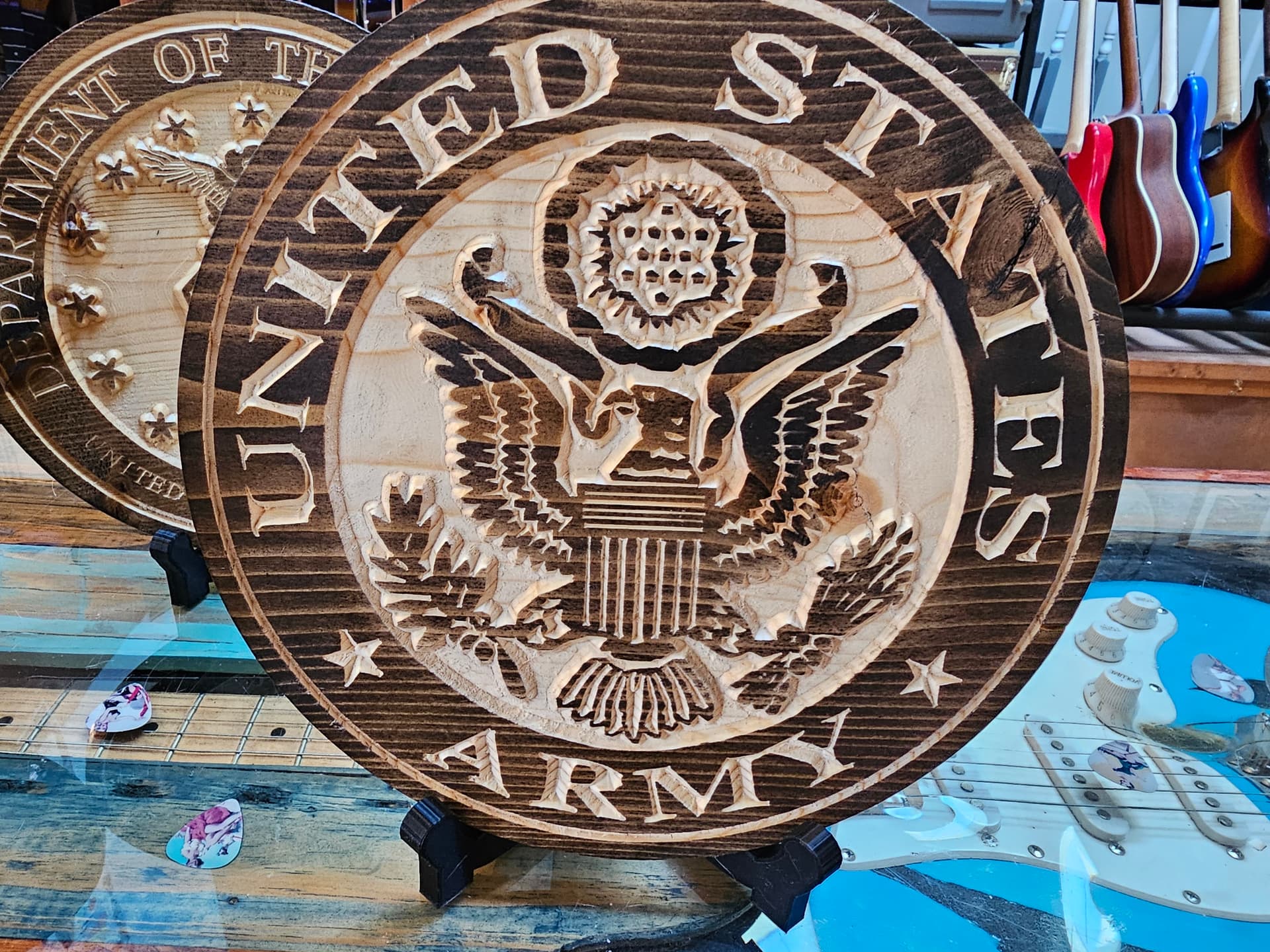

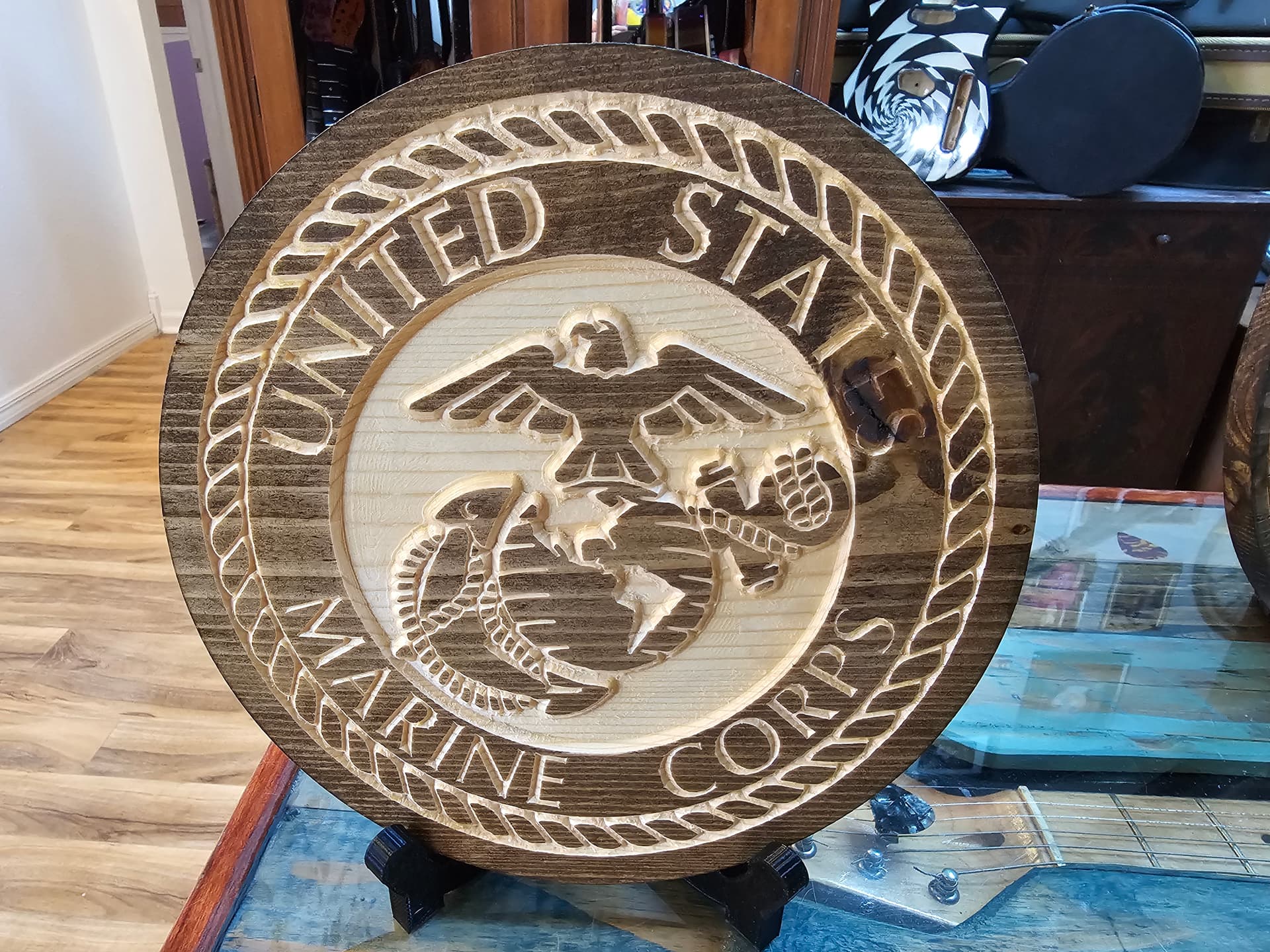

Testing 1st vcarves
Test cuts on some mdf, added some contrast on the 2nd. Mdf on mdf doesn’t show detail very well. But I’m pretty happy, good enough to try it on some actual wood. 10" plaques.

I’ve been playing with it for a while on an xcarve, but finally put all of the mpcnc parts together. It’s been getting some light work as I learn the new machine and I’m running it right now about 6 hours a day to make these. It’s about 2.5-3 hours on the clearing and then an hour or 2 on the final carve.

Vcarve pro, 1/8th inch clearance and then 90v. I’m not pushing the machine hard yet so I’m not messing with speed until i really trust it and doing shallow passes on clearing.

I actually timed 1 yesterday, just under 2 hours to clear and about an hour on the vbit. Theyre a 10" circle, depending on the design there is a lot of wood to remove.
I’ve been doing 1/4" depth on them, switched to an 1/8th on the last one. Faster obviously, and I think the end result looks better.

A redesign to bring a bit of uniformity to the project, and I’ve got the main military done. I’m moving on to local agencies now.
