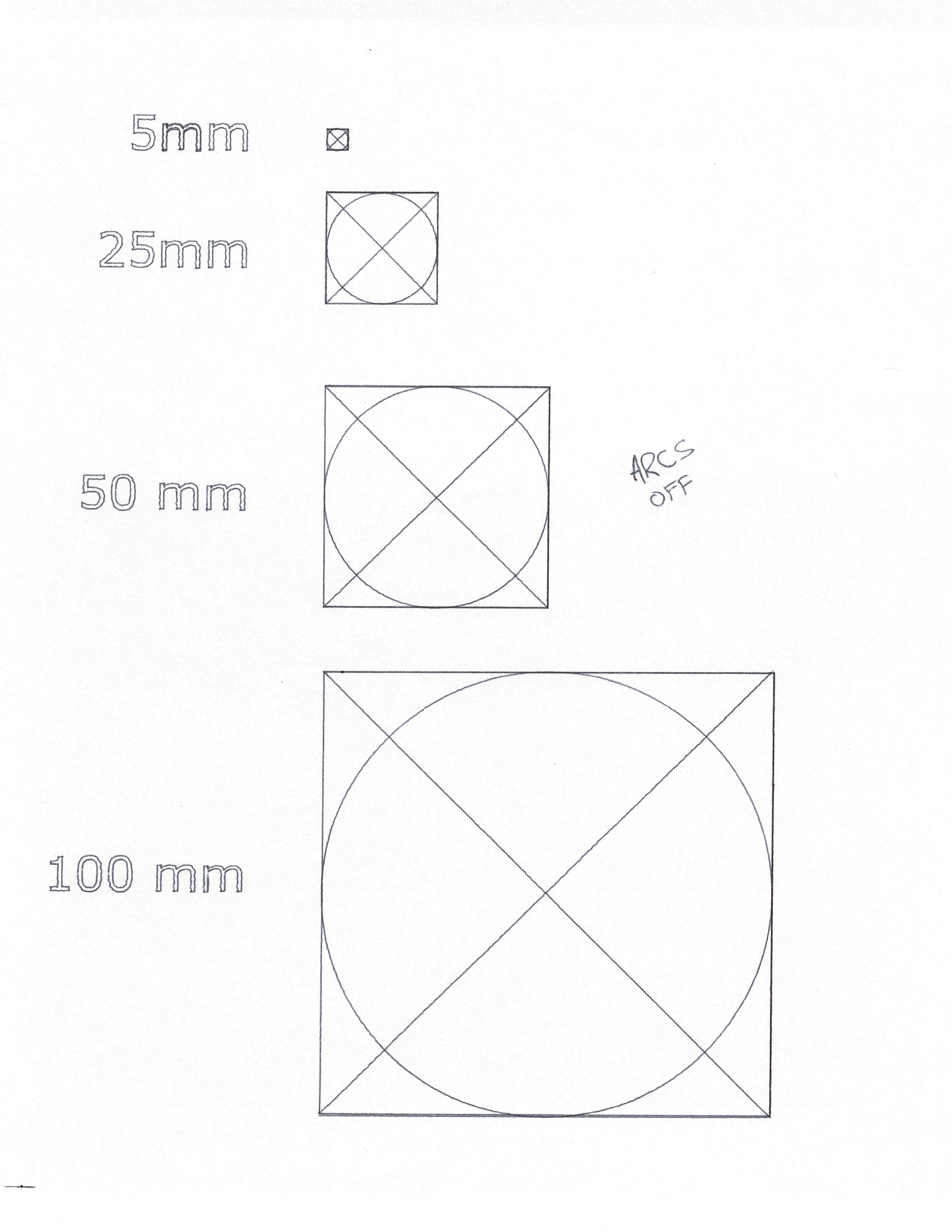

I’ve used my mpcnc to cut large things (on the scale of inches), but it seems to be not so good at small things. I mainly see the problem with small text. I’m attaching a jpg of a test pattern which has shapes and text. The shapes look pretty good - parallel sides, correct size. The text seems a bit squiggly. I went back and adjusted the gantry as described in the assembly documentation - make sure all bearings are touching, etc.
Please look at the output and tell me if you think this is as good as I can hope for, or is something clearly amiss?

If you have arc commands on turn them off, or if they are on turn them off. See if that helps.

In estlcam, arc comands are on. I’ll try turning those off.

I would say your lines are excellent for a working length of 14", when 4" is about as tall as you should go without other means of support.

After you try without arcs, try 12. Only change one thing at a time please.
Arcs usually only work for very large arcs and saves a lot of lines of code, but for small arcs usually better without.
this is the image with arcs turned off in estlcam. It already looks better. The text is less squiggly.
I’ll also try speed reduction.
I suppose the last option is cutting down the machine height. I suppose go back to the calculator.

Oh, this is a scan from a pen. I didn’t look closely at it because I thought it was the input file.
It’s not the pen mount’s fault is it?
Looks good, at that size it could be your surface, the pen mount, Pen mount tension (should be light try a felt tip), etc. I think it’s pretty good now.
I used a ball point pen with Ryan’s printed pen mount - which is also a spring.
I’ll try it with felt tip as well.
