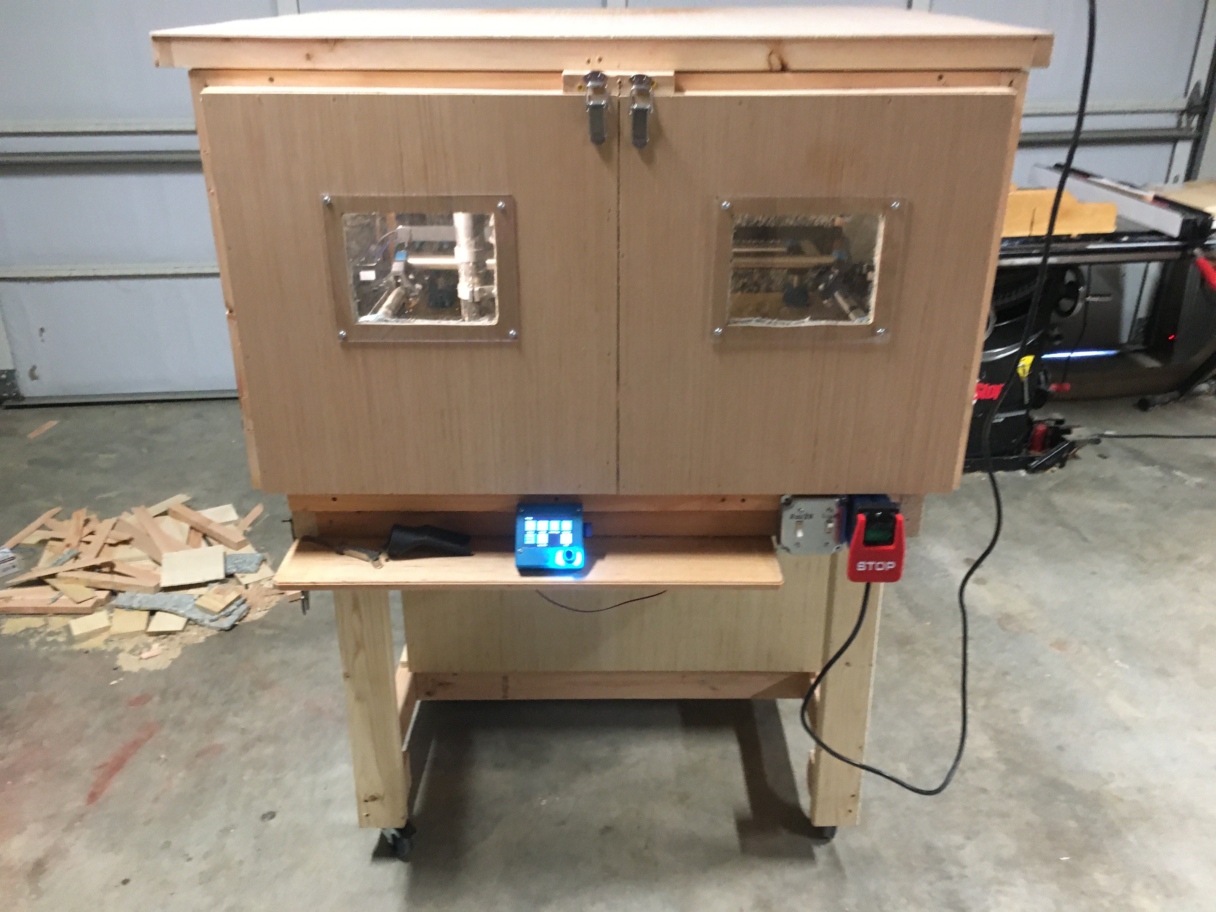

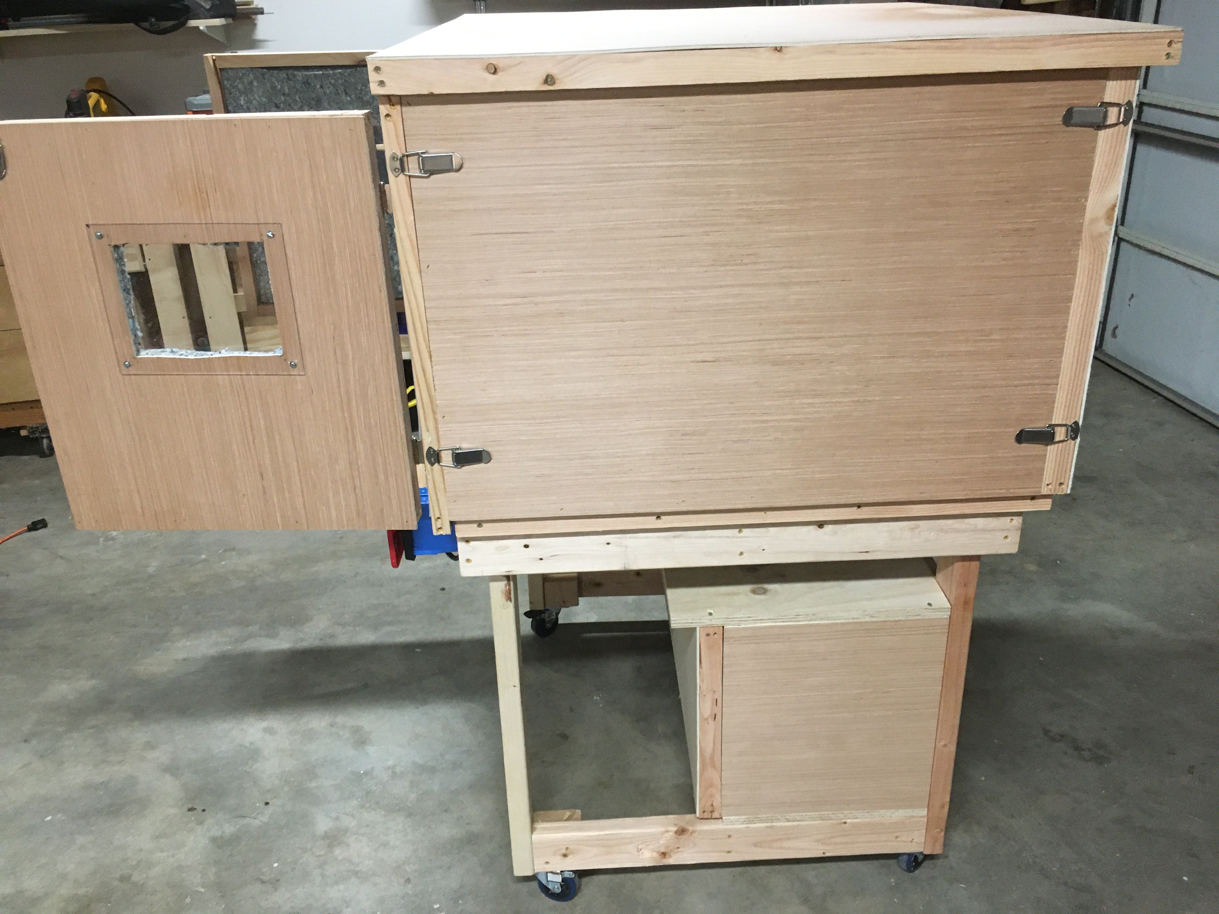

Well, I was slowed down a little in completing the cabinet build for my Primo. I fell and cracked a couple of ribs. Don’t wish that pain on anybody, especially when you cough. Wow!!! While still in pain 10 days later, it is gradually subsiding and I was able to slowly complete my cabinet.
I first built it with 1/2 plywood and 2" thick styrofoam, but it took 2 people to lift it off the machine, no good. I tore that down and built four side panels and a top that all latch together with a very light, 1 x 1 1/2 inch fir box frame with 1/4 skin and lined with carpet padding. I can remove any side or the top for access very quickly or tear it completely down in snap with no help. The two layers of 1/2 carpet padding reduced the sound much,much more than the styrofoam. I have since read up on the sound transmission issue and found that softer materials do much better for sound deadening.

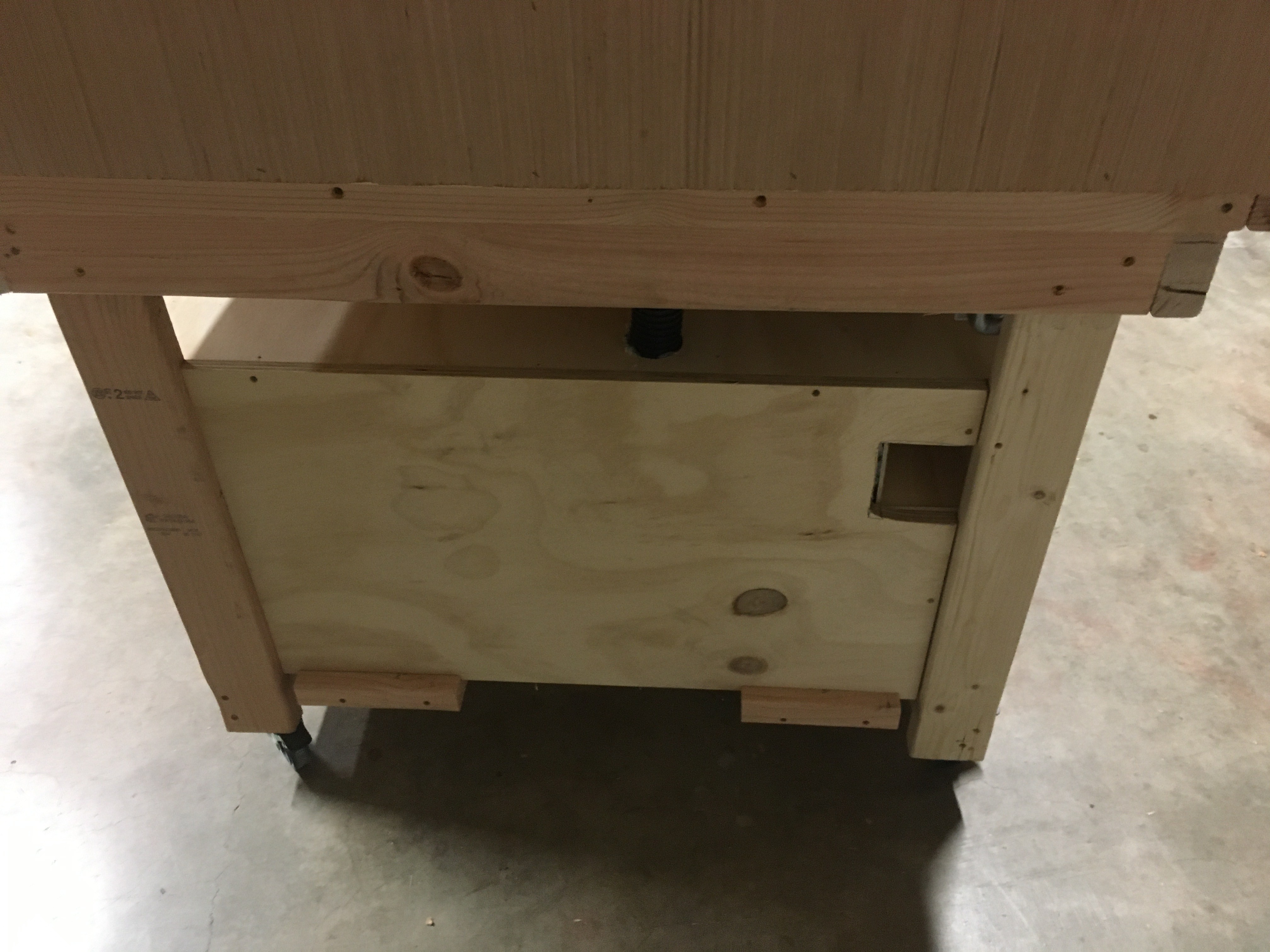

I also built a vacuum cabinet underneath and soundproofed it as well. Also put a baffle in it.
And I added Emergency switch, router safety switch, and light control together with a SCR to control on/off of the router and vacuum through the software

Nothing left to do now but put it to work. :grin:
That’s a nice clean build. I built my enclosure over a year ago and still haven’t gotten around to putting doors on it. Maybe I’ll finally do that in the next month or so.
I had dust collection on the Burly version of the machine, but nothing on the Primo yet. I was thinking about just hooking the dust collector up to a 4" port on the side of the enclosure. That would only grab the light stuff floating in the enclosure, but that’s what’s worse for your lungs.
Wow, impressive!! The cabinet was too heavy, so you just built a new one. Took only two broken ribs… all the best to your health

Just when I think I got the right idea for table/enclosure I see this. I really like that enclosure. Great job!
