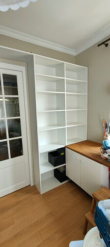

Template for stair treads / shelves
This is a template/helper for cutting shelves/tablets/countertops, even if you cabinet/wall is’nt perfectly straight
I’ve been wanting to build this jig for quite some time now…
I needed to cut a few tablets to make shelves for the office, so I guess it was a good time to make this :slight_smile:
Cut it out of 18mm MDF and 10mm plywood
Knobs are 3D printed and I used M6 bolts and inserts for fastening
Center piece can be any 10-15mm scrap to fit the length you need
So… How does it work?
Perfect fit every time :slight_smile:

The jig did it’s job alright
Very happy with this…
