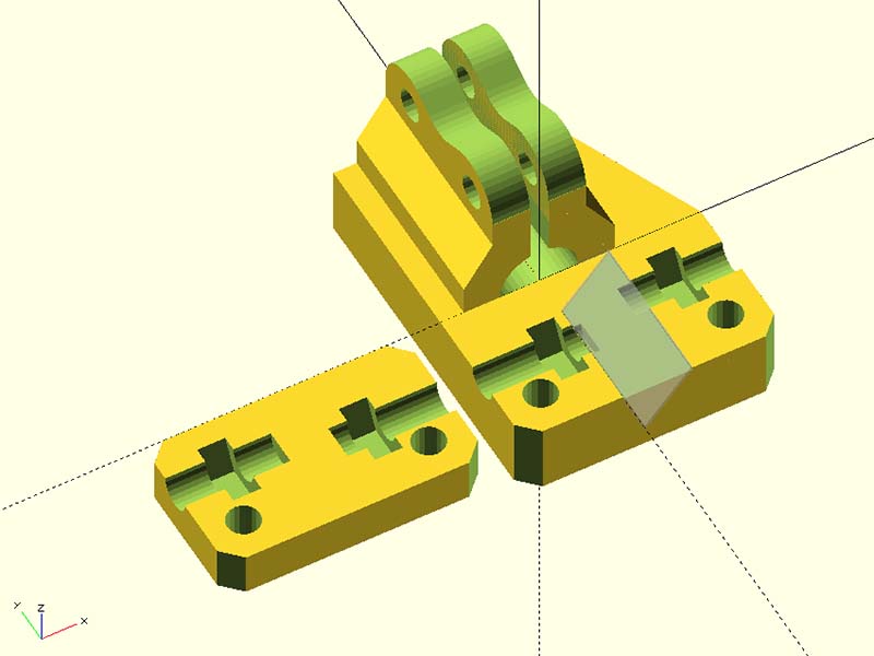

I made some progress on my quick mount adapter for this. My main problem was making the mount shorter and closer to the blade. The top of the adapter needs to have a lip to rest on the top of the quick release mount. I had the bright idea to make it a two part mount so I could drop the main red part down lower & have better stability. I still need to add the quick release files to the assembly to see if I need to adjust it down any more, but looks like it should work. I will bolt the blue & red part together with M3x50mm screws. I cut slots around where the bearing inserts to make it easier to insert them. I probably will use a metal 8x5 coupler but used https://www.thingiverse.com/thing:964680 for now. The pineapple coupler was too wide.

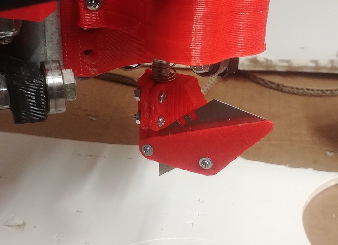

Good to hear. It’s been a rewarding project for me too, learned loads. Your blade holder is on my cutter now, and looking good. It’s a big improvement. It’s more rigid and has better blade positioning support. The end of the rode is about 40% closer to the blade tip, which is a big deal for rigidity. I also like the integrated blade guard for the back end. I’ve scratched the redesign job off my list!

Since I put the rigid alu coupler on and installed the new blade mount, my blade tip x/y tolerance has improved a lot. Watching the bushings updates closely, but I’m pretty happy with the accuracy now, so it’s not as urgent. I do want further improvements so please keep going with this.

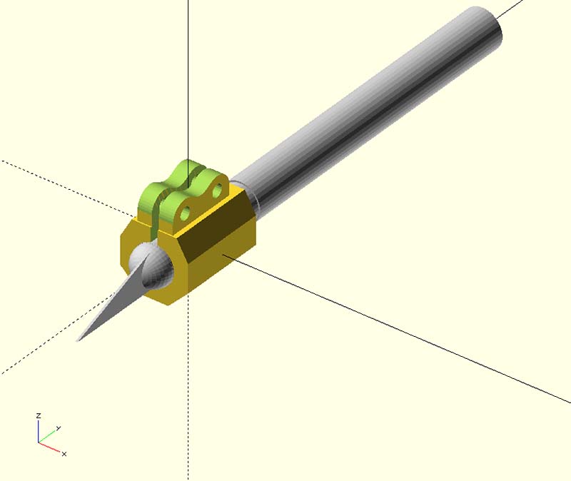

Glad it is working for you & I have had to print very little to test it so far. While walking thru some hobby stores today, I had the idea that an x-acto knife might work with this, but not sure if it would be as strong a blade cut as what you are using. I did 2 design versions, one with the knife and one with just the blade. Using just the blade is probably a better way to go as the part is smaller and you would not have to use a non-standard 3d printed bushing. The diameter of the Number 2 knife with number 2 blade I was using, http://www.xacto.com/products/cutting-solutions/knives/detail/X3202 is a measured 11.15mm OD. Actually the #1 knife measures 7.96mm OD which should be close enough to 8mm, but I was not sure that would be strong enough. Anyway, here are a couple of screen shots of the design for reference. For just the blade mount I would add just a simple cover with 2 screws to hold it in. For the single blade mount, I added the notch in the center to hold it in place. I just realized that using the whole knife would make the tip of the blade offset from the center, but using just the blade would not.
Think I have simplified my mount adapter, at least cut down considerably on the amount of plastic to use.
Good thinking. It’s great when you challenge yourself on a project to see the ideas flood in. On this occasion I personally have my doubts. You mention why the whole knife option won’t work - there needs to be a zero offset.
As for the blade only, we’re on the same page, however I think for a couple of reasons an Olfa snap off might be preferable. This is something I’ve mentioned in my blade holder update notes on the Thingiverse page - the idea being to copy the TOCK approach and use Olfa blades.
I’ve found cutting thick material presents a few challenges. The angle of the blade w.r.t. the material has a big impact on success. See this post for some experiments with blade angle. What I found is a shallower cutting angle is more efficient.
I guess there are two reasons for this: more blade in the material, and the shallower the angle, the bigger the component of transverse movement or slicing action. If you think about sticking a blade in to thick cardboard with the blade edge perpendicular to the direction of travel, you can imaging it will be quite tough to move because there will be no slicing at all. Same is pushing a knife straight down through a tomato without any lateral movement.
X-acto blades offer a very steep cutting angle (closer to perpendicular) so while there are advantages in terms of reducing over-cut on thick material, there would be much more resistance on the cut. With Olfa snap-off blades, you get super cheap - I find changing the blade often is needed more than you might think. The challenge might be that without any holes or indents in the blade piece, having it mounted securely. Perhaps a spring clamp like your rod clamp in the blade holder?

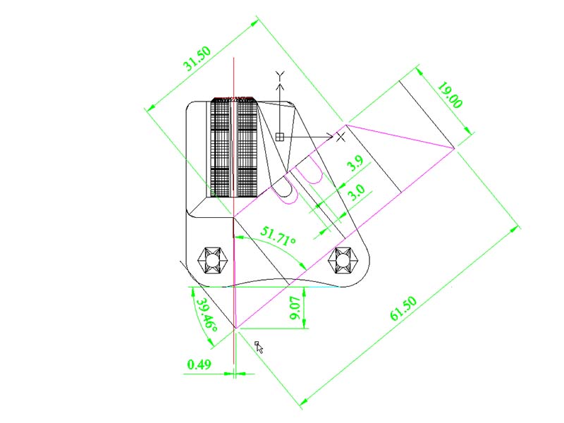

I took some dimensions off the cutoff blades I have, but not sure they are the olfa blades. I attached an image to show those dimensions and different angles of cut height depending on the mounting orientation of the blade. A limitation I see with those blades is depth of cut. At 40 degree cut which is close to what the other blade is there is 5.35mm depth where the box cutter blade is 8.59mm. Do these olfa blades come in different widths? I could probably make the dimensions for the blade variable in the openscad design.
I also attached an image showing the key dimensions of the box cutter blade holder (using Stanley blade as reference). I left the dimensions and angle of cut the same as the original design, but could change them easy enough. Using the Stanley blade there is probably .5mm offset from the centerline of the shaft which might not be enough to worry about. I would have thought those blades would be a nice 45 degree angle instead of the odd 51.71 degrees I come of with from measuring them. I am using a digital caliper to measure them.
What cutting angle would be optimal for cutting cardboard or foamcore? On that TOCK you referenced, looks like he is cutting that cutoff blade to a 60 degrees or so and sharpening it to get a longer depth of cut.

It seems there are at least two different angle systems in blades from Olfa. There are the ones we’ve been looking at, and also an ‘art blade’ steeper version. This second one has a 30 degree angle according to the shop page. I can get these on ebay UK, 10 for £5, 6 usable tips each. They seem like a better choice even if you mounted at different angles because there is overall less blade in the way. I do not believe there will be a blade strength issue at all with these by the way.
Regarding your question about depth of cut, the pointier blades seem to have a slight advantage there too, being 9mm each of blade length, and less re-orienting to maximise cutting depth.

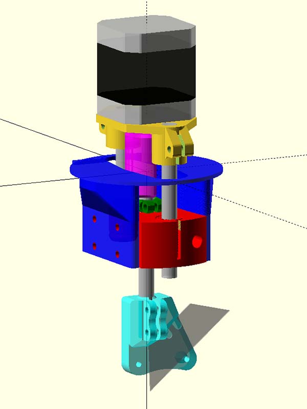

How about something like this? I have adjustments for the blade size and a few other dimensions. I have it set to use an M5 screw & Jam Nut as it seemed like a good size to use. A lock nut or regular nut will increase the height more. I have the shallow cut blade shown, but could use the steeper cut blade also. I show 2 views of it in one image. The m5 screw might not be necessary as I have the cutout for the blade at .3mm depth which should be the half the blade thickness. The cover itself might be enough to hold it. I guess the M5 screw would give the blade less chance of coming out.

I think it should hold. I take it you put the cut out only on the holder side so the cover will bend / clamp over the remaining 0.3mm when screwed on? Thinking about the TOCK use of Olfa blades, with the blade vertical as you have it here, as you pointed out before there is very little cut depth available, which may be less of an issue with the TOCK because it oscillates.
Thinking a bit more, I think the 30 degree blade will actually work much better in the tangential knife than it would in a drag knife. Also because of the cut depth, I think I would be inclined to try your design modified for it first. I’ve ordered some of the blades - should be with me Friday.
On bushings/bearings, I’ve ordered a 45mm LMU8 for the bolt, and when it arrives I will go in search of a nicely fitted rod to try to minimise the lateral play. It occurred to me that the lateral forces on the shaft might be quite wearing on the PLA bushing.
What are the width of those blades, 9mm? The one’s I am using are 7.21mm & I add .2mm for clearance. I was thinking of using set screws along the side also, but dismissed that idea thinking that was not enough support. I then realized that might actually be a better idea & looks a lot better. The nut & screw are sandwiched between the cover & the holder. Here is what I am thinking. This is using 2 M3x12 screws with jam nuts.

Seems like a great idea worth trying. Any scope for sneaking in a 3rd hole next to the rod clamp. You would need to re-work the blade cover piece to go up there. Only because with two holes in a line tightening the side screws might cause the blade to want to tilt and hinge up the blade cover.
