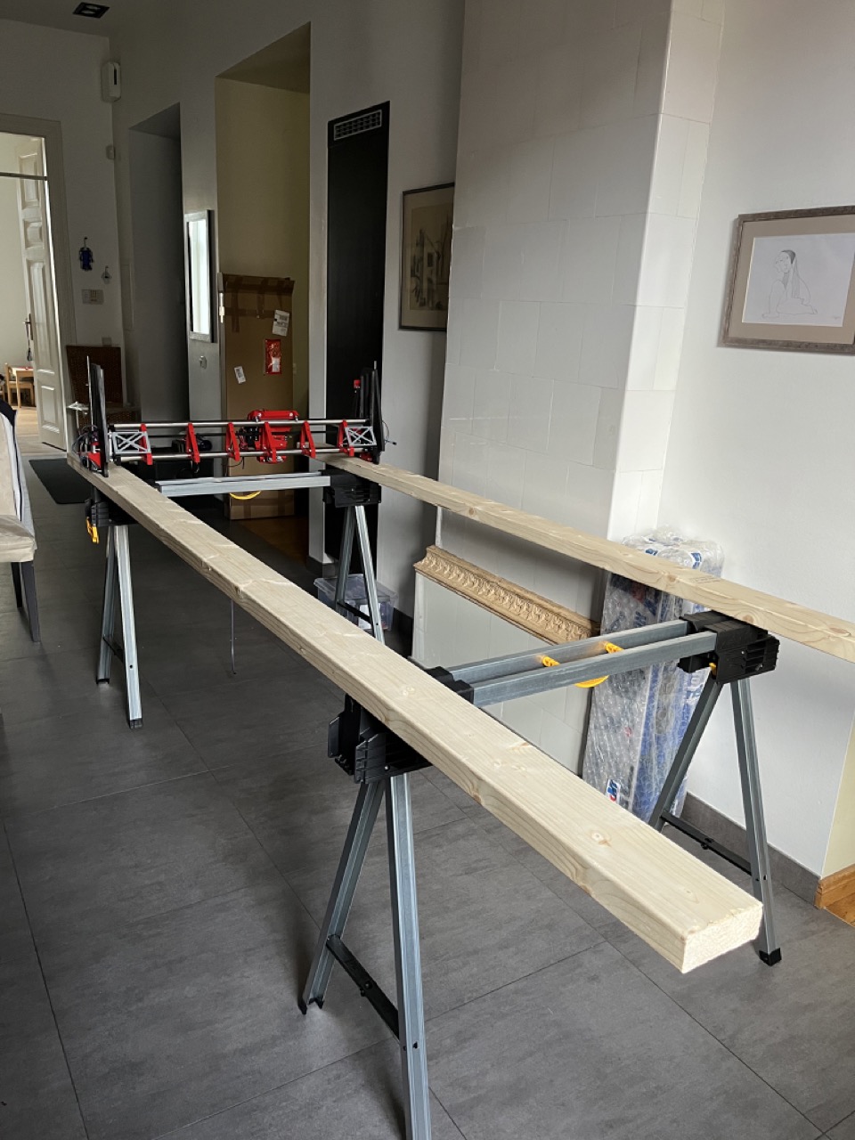

This is what our kitchen looks like right now and my wife is already giving me the looks :smiley:
Today I bought a pair Kreg KWS500 saw horses, but they were so wobbly I returned them to the shop and replaced them with these dewalts which were more than 2 times cheaper and a million times more stable.
I need to build the table before finishing the router assembly. The plan is to create a pair of plywood rails and throw some replaceable MDP boards in between them. No idea how long this is going to take…

So my kitchen cnc is getting some progress :slight_smile:
I was lucky enough to find a dealer in Germany who has the same board, so my waiting time is now down to 5-7 days. On the bright side, while waiting for the new board, I have plenty of time to clean up the cable mess. I made all the cables more or less the same length and added JST connectors everywhere, so now it is impossible to blow up the board by misplacing the cable connections.
The table is not yet finished, but good enough to make some first cuts along the sides. I will need to cut the struts for the cnc and some cross rails for the table to make it more rigid. Overall I’m pretty happy with the table, as I can disassemble everything in a couple of minutes and throw it in my van and take the cnc to our country house or wherever else I please. Or just put it away in the storage when I’m not using it. The ability to lower the center part is also nice if I decide to cut very tall foam blocks.
One downside of such table is that every time I assemble it, I kinda have to check for proper squareness. To make this easier, I cut the boards between the rails in a shop with a very accurate cnc machine. There are 4 boards 90x60cm. I know each of them is exactly the same size and 100% square, so as long as there are no gaps between the boards and the side rails, my table should be square as well.
