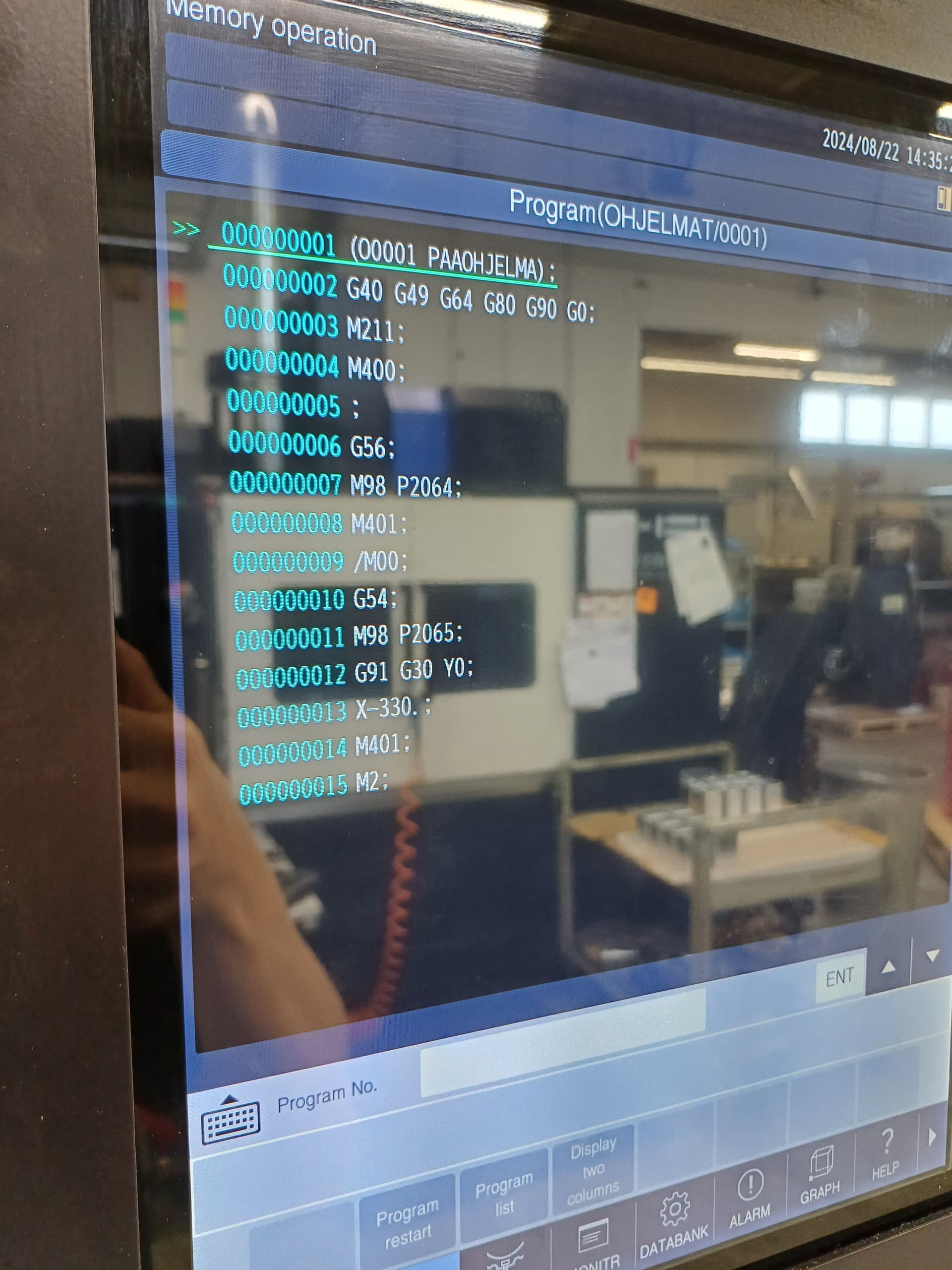

That says go, at the same time, to X0 Y0 and Z0. Z0 is all the way down, you don’t want that. You want Z up so usually +10 from where you currently are when you finish a job.
Park is Z all teh way down so when we power off it doesn;t drop.
Exactly M98 is subprogram call and M99 is subprogram end
So you can make one program that calls another program. But I have never tested does this work in Marlin.
If you change M00 to end, steppers stay energised and gantry will not fall?
Thanks that’s what I needed to know I just started learning gcode the past month or 2 , I didn’t realize there were commands such as END, and I will look more into M98, which sounds like what I would want also. This way some repeated work won’t have to be done each time.
Feel free to try. I havent try it with Marlin. But I don’t see reason for that. For example. If you want to move the router away from your workpiece at the end of program. As many have said You can modify the basic end of program like G00 Z+10. Y+900(means raise z10mm move y900mm). Before M30 or M02 (or M00). Or you can modify it like you need. And you can save these information into estlcam so everytime you post new program tje same end you have made appear into g-code file.
Marlin does not have M98 or M99. But it does have M32 to launch another gcode file as a subprogram.
Apologies if this is off in the weeds from your original question, but https://youtu.be/fGtbkVJBXyE?si=_nYAI3zjYi8zyxOO showed me that I could just choose a parking position and save it permanently under G28 or G30, then I just wrote a quick macro to move to 0 0 0 in those workspaces. (Not sure if your controller supports that, I use the glorious v1e Jackpot board.)
Edit : if you’re using Marlin, G28 and G30 do totally different things, so never mind in that case!!
