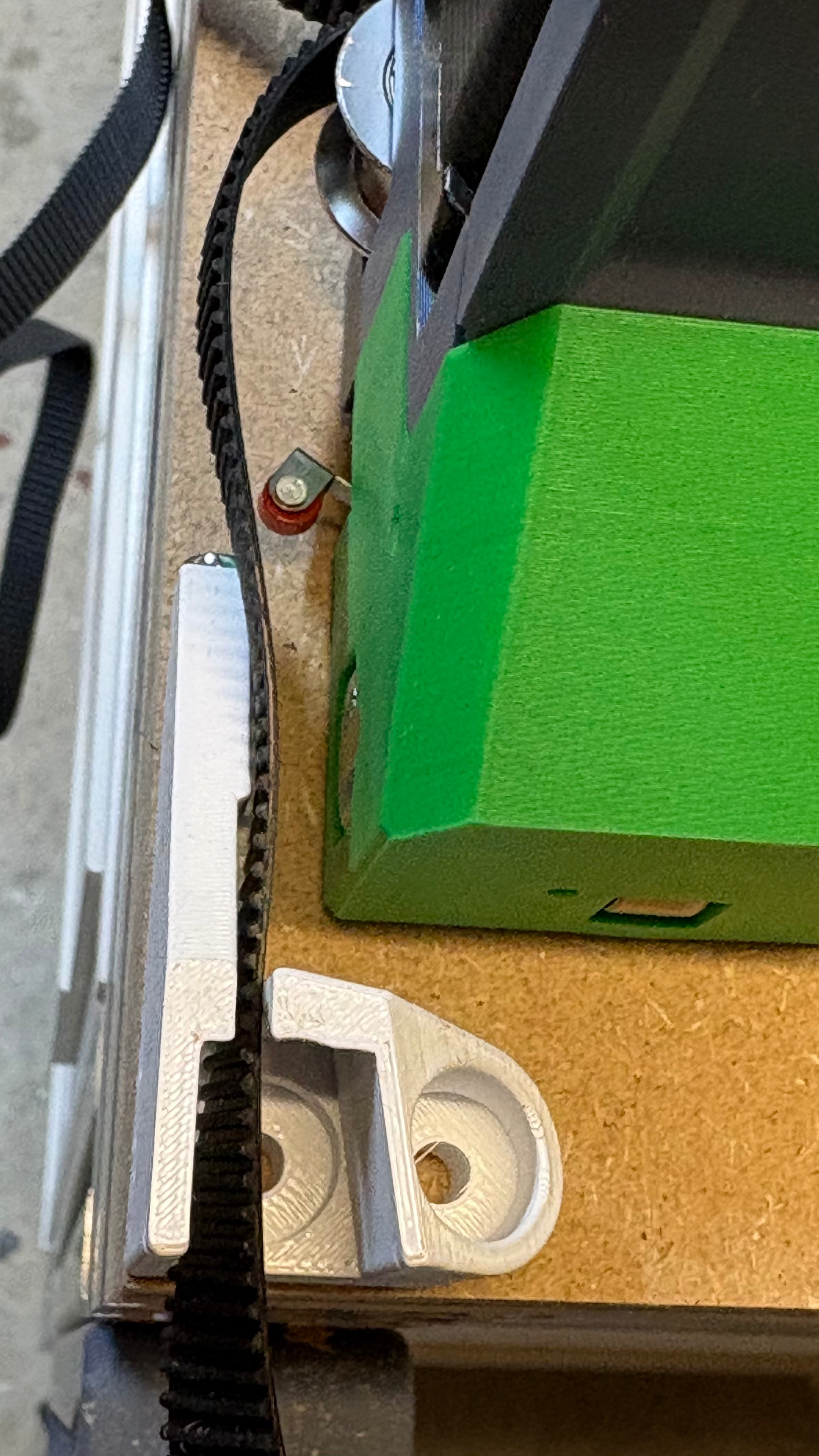

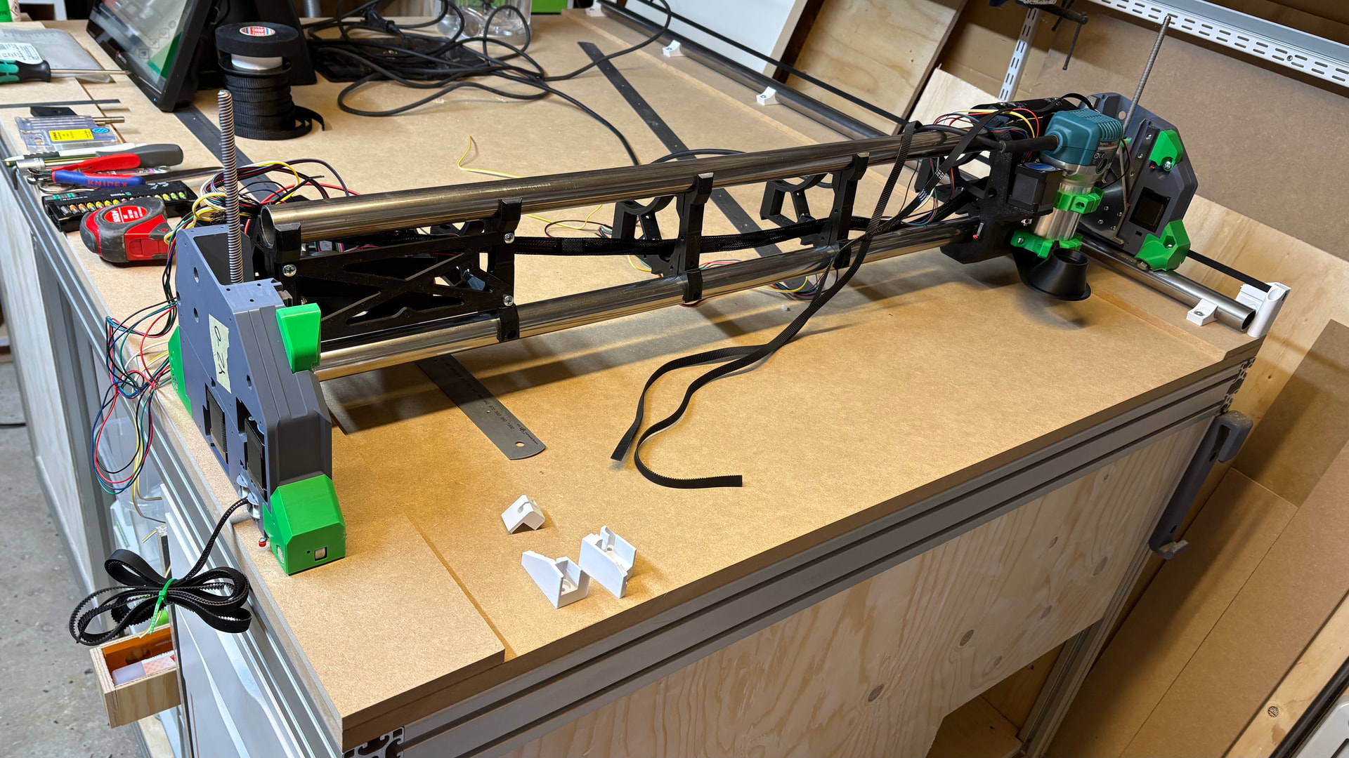

I’m in the process of mounting the Y on two strips of MDF that will be secured on my workbench.
If I align the belt holders to the outer corners they seem a bit to far from the YZ-0.
The calculator for the LR4 gave me the following measurements:
Table X: 1200 mm
Rail X: 1074 mm
Cutting Area: 908 mm

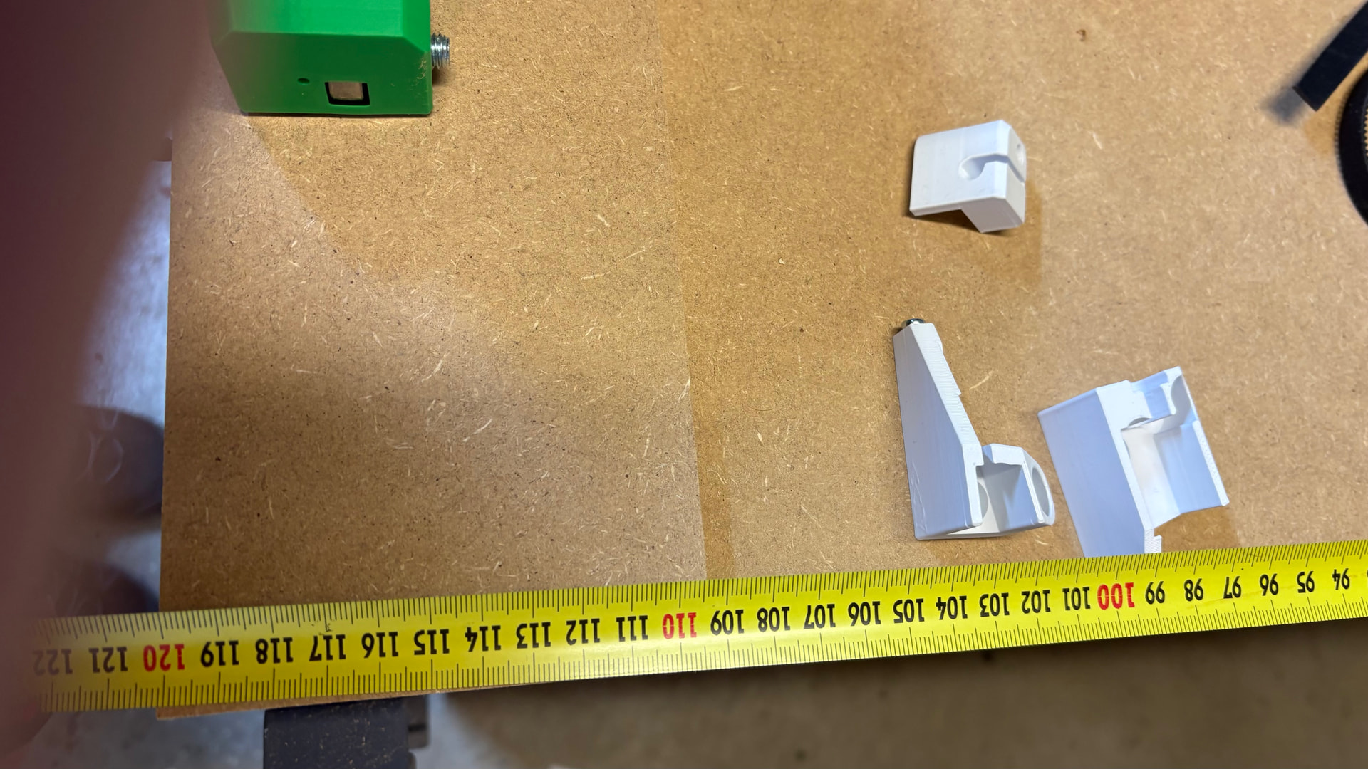

My table is exactly 1200 mm (X) and my X-rails are exactly 1074 mm:
Am I missing something or should I just secure my Y MDF (the one without tube/rail) a bit narrower? I will have a permanent screw on/off solution but it needs to be precise. Also, I bought the aluminium plates from Ryans “partner” in Germany and they state that the plates are 6 mm instead of V1e that is 6,5, but that is only total of 1 mm. I’m missing 8-10 mm
Also, where I live the sheets are standard 900 mm. I would really like to have that cutting area.
Would a alternate solution be to add washers between the YZ and the X-core (with longer screws and such)?
What is your measurement between YZ-0 and beltholder?
Help is much appreciated!
Jörgen

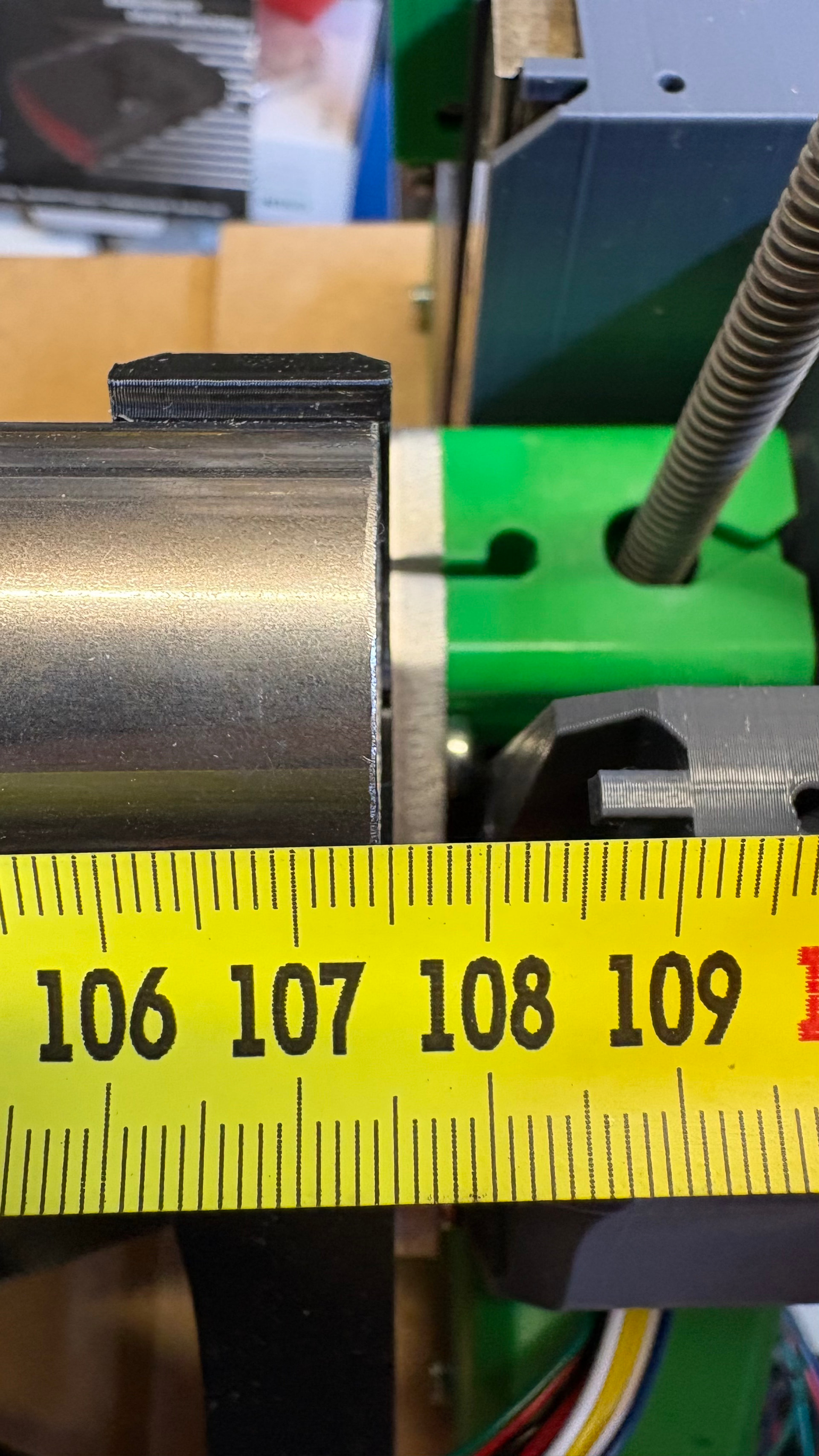

Here is another way to illustrate the “gap” of 6 mm:

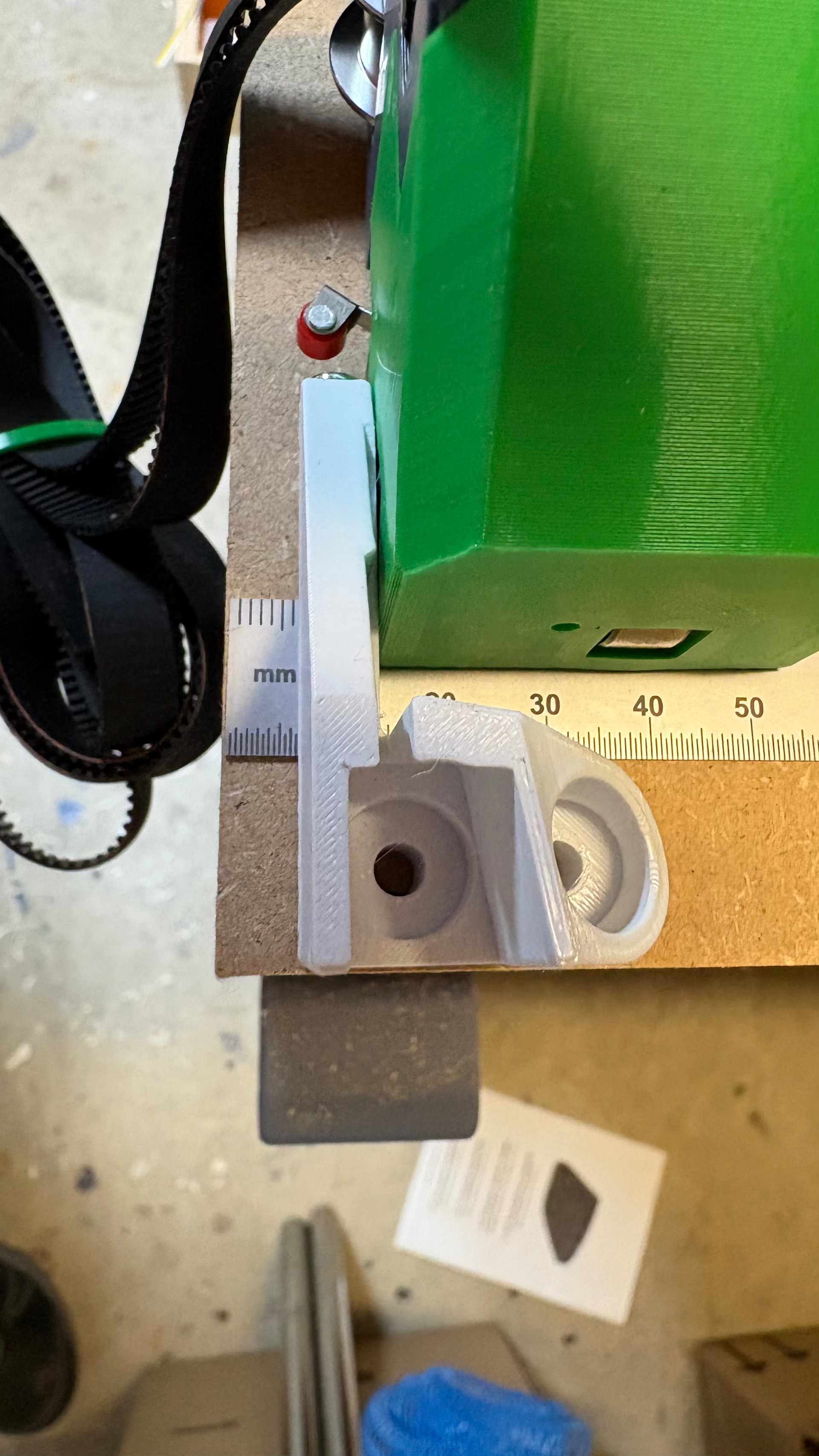

Where do I place the Y min belt holder? In the corner or just tight to the YZ-0?
TIA,
Jörgen

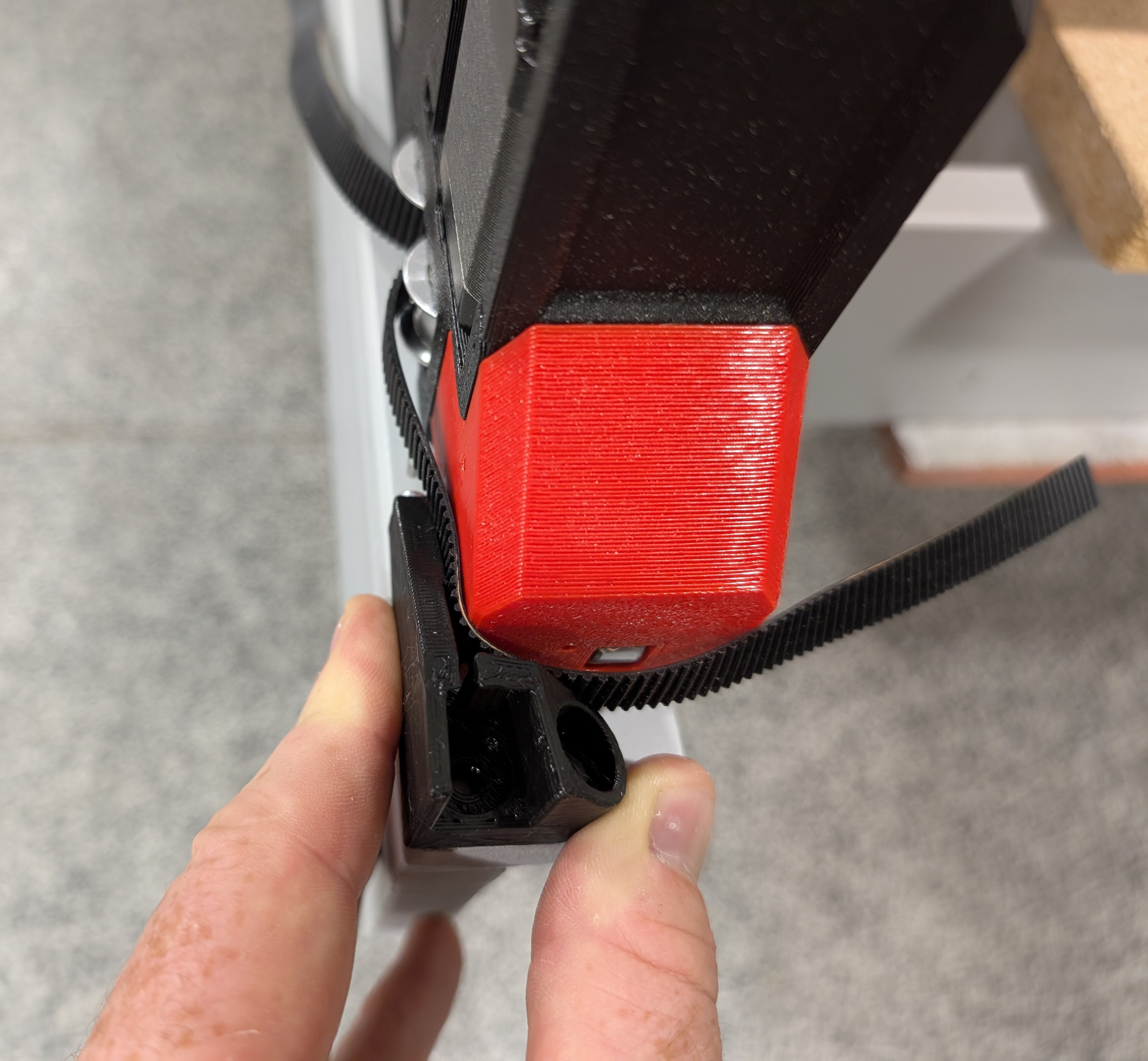

Remember there’s a belt as well, you need to leave room for that.
Thanks.
That is absolutely true. As shown in the instructions:
”Setting the Y min distance can be done from the calculator, or
  • Using a piece of belt on the table to set a one belt gap width, making sure your end to end brace gap is set to the calculated width so nothing changes when you add your strut plate.”
But I’m not nearly as close. In the instructions the piece is placed in the corner. Even if I leave plenty of space for the belt I’m not close.
I’m surely missing something here…
/J
The calculator adds a little extra fudge factor room for you, in case some thing are bigger or don’t line up perfectly
It’s not expected that both sides will exactly hit the end of the table.
You should line up that side and mount it like the instructions say, by looking at where that side lands

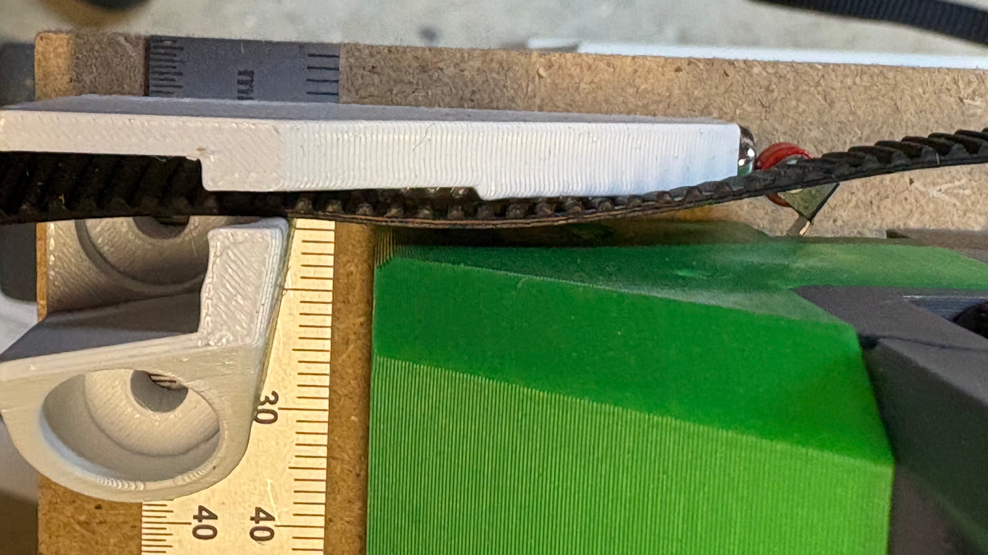

Do just like the picture in the instructions with the belt and the clip to find the correct position.
Use a pencil to mark the outside edge of that clip position onto the table.
Use a square to extend that line to the front of the table.
Use that line to line up the bracket and mark the screw holes to mount.
Hi and thanks for replying,
I agree that that will probably be how I will get going. Still, I’m curious on how the instructions and the mounting pictures sets the belt holders right on the corners. I also seen others do this. Feels like I really paid attention but still missing something…

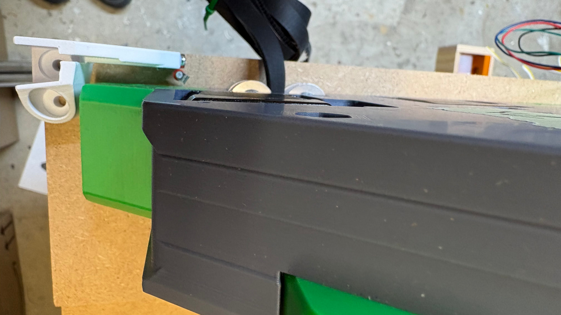

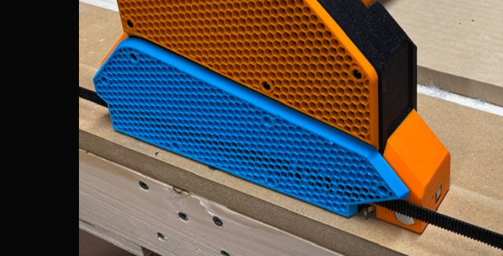

Actually, off the corner…
You can see that the table actually was a little too narrow…
Which I think is what led to the extra mm being added.
The right way is to line it up with the way the machine is built, not alter the machine.
An extra few mm on the edge won’t hurt anything.
