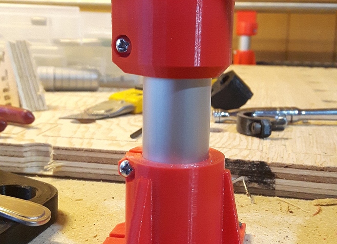

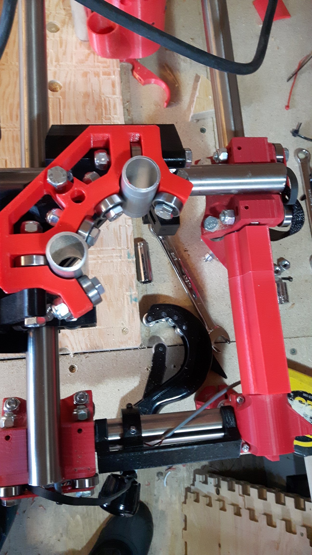

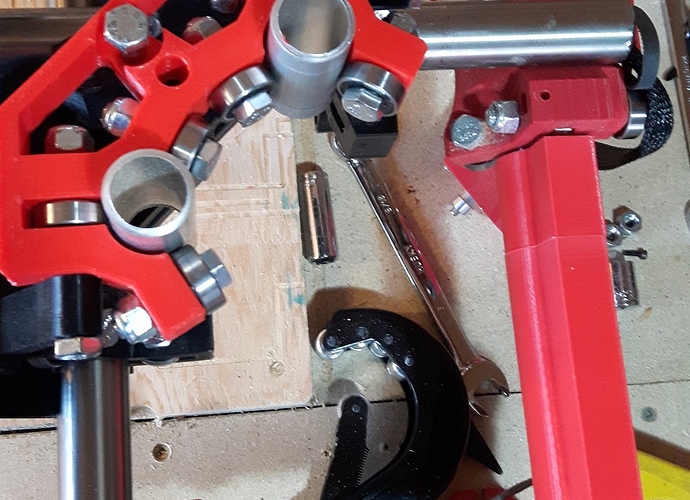

I remixed my XYZ pieces, the spacer and nut trap so that the Z bearings aren’t spreading as much and my MPCNC is square at rest now (see attached photo). Was not able to square it before. I think the torsion on the center assembly was part of the cause of the issue.

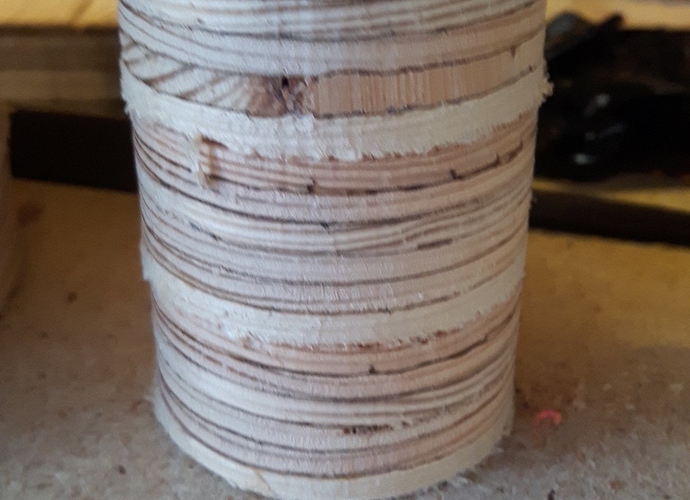

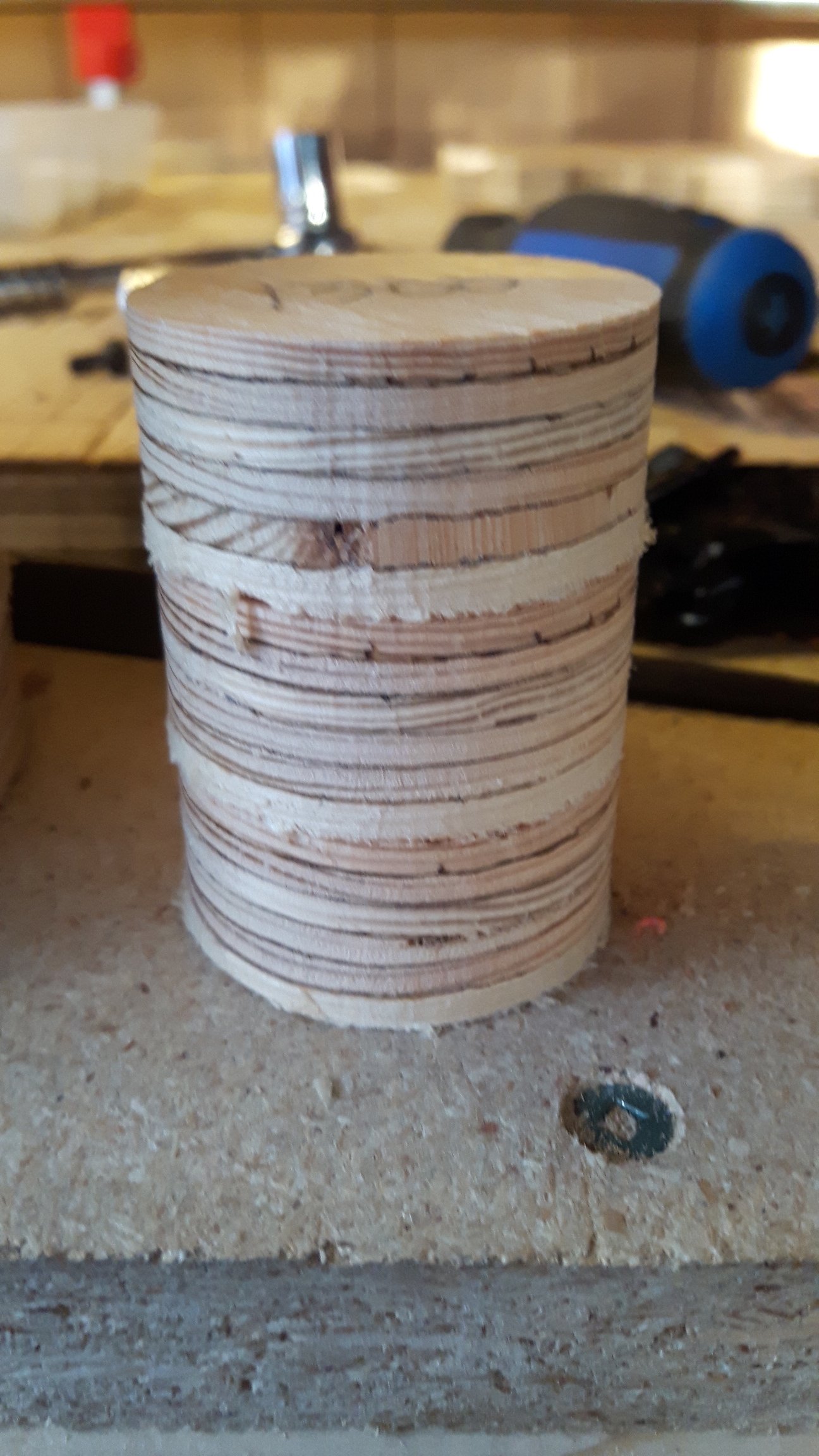

I can now cut circles at 1100mm/min pretty cleanly (see attached photo). I can even cut at 7200mm/min but it’s rough looking, but the bit and setup can handle it just fine. Impressive. 3mm per pass on an 1/8 bit at 20000RPM.
All in all, much happier with the results.

When I had the original XYZ parts, the moment I inserted the Z tubes it would force my X and Y axis out of square by 5/8 of an in inch. So I remixed the XYZ parts so that the bearings were backed off a bit by placing the holes for the bearings so the bearings would just touch the tubes. Now when I insert the Z tubes, everything stays square.
The mid span supports are a huge benefit. I might even add more… I’ll post the stl’s tonight on thingiverse and add a link here. They just mount to the standard MPCNC corner mounts. No use in re-inventing the wheel.
