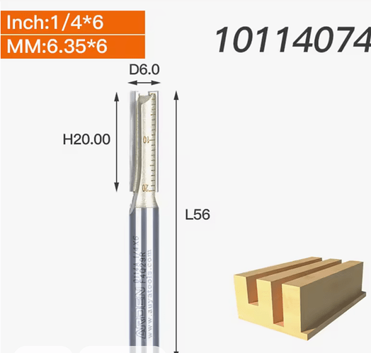

Just to be sure, this is the 2-flute bit in question that I have on hand - am I OK to proceed with this and 40% stopover? And what kind of feed rate should I use?
I think you’ll be fine at 40%. Feed rate depends a lot on your machine. Without knowing anything about it my first guess is 20mm/s and speed up/slow down from there depending on how it acts. Keep your router speed down lower so you don’t burn up the 2 flute bit.
