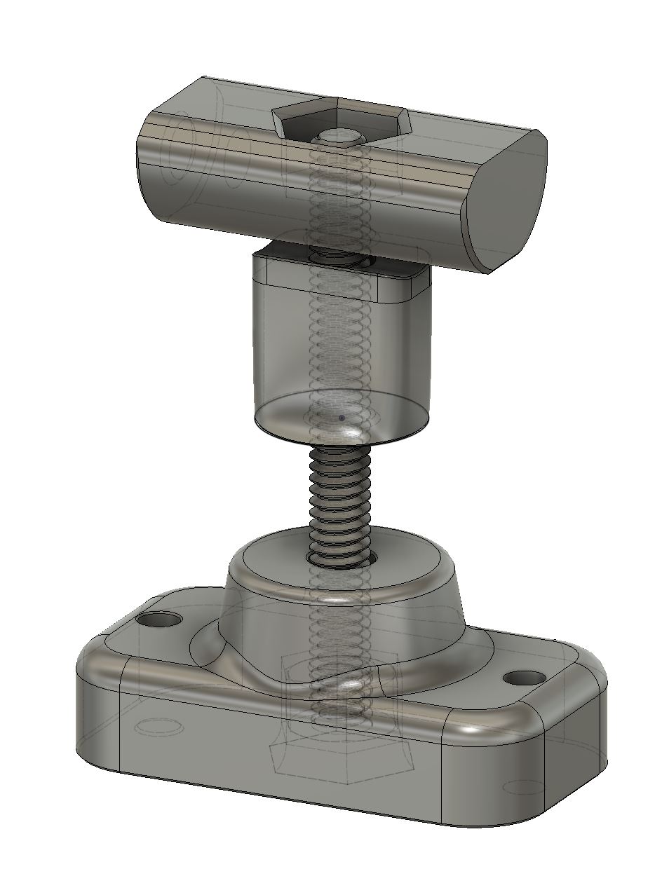

So I’m going to be building the Primo and (against suggestions) I want to go big with a printing area able to handle a full 4’ x 8’ sheet of plywood. I know I’m going to need supports for the long sides at the very least, but does anyone have the .STL files to print those supports?
I think this is the stl: https://www.thingiverse.com/thing:1160962 .
I don’t think I’ve seen a primo 4’x8’. I really haven’t seen one since the Low Rider was created.
There is at least one additional mid-span support on Thingiverse beyond the one Jeff references. In addition there are corner braces on Thingiverse that might be helpful in a rig of this size: One, Two, Three. I created my own supports for my Burly…just 'cause I could, not because there was anything wrong with the ones on Thingiverse. It uses 1/4-20 threaded rod, nuts and washers. A 1/4 dowel is used for positioning the nut trap, and it was designed for conduit. Files attached including the .STEP files.MPCNCMidSpanSupport.zip (593.4 KB)
