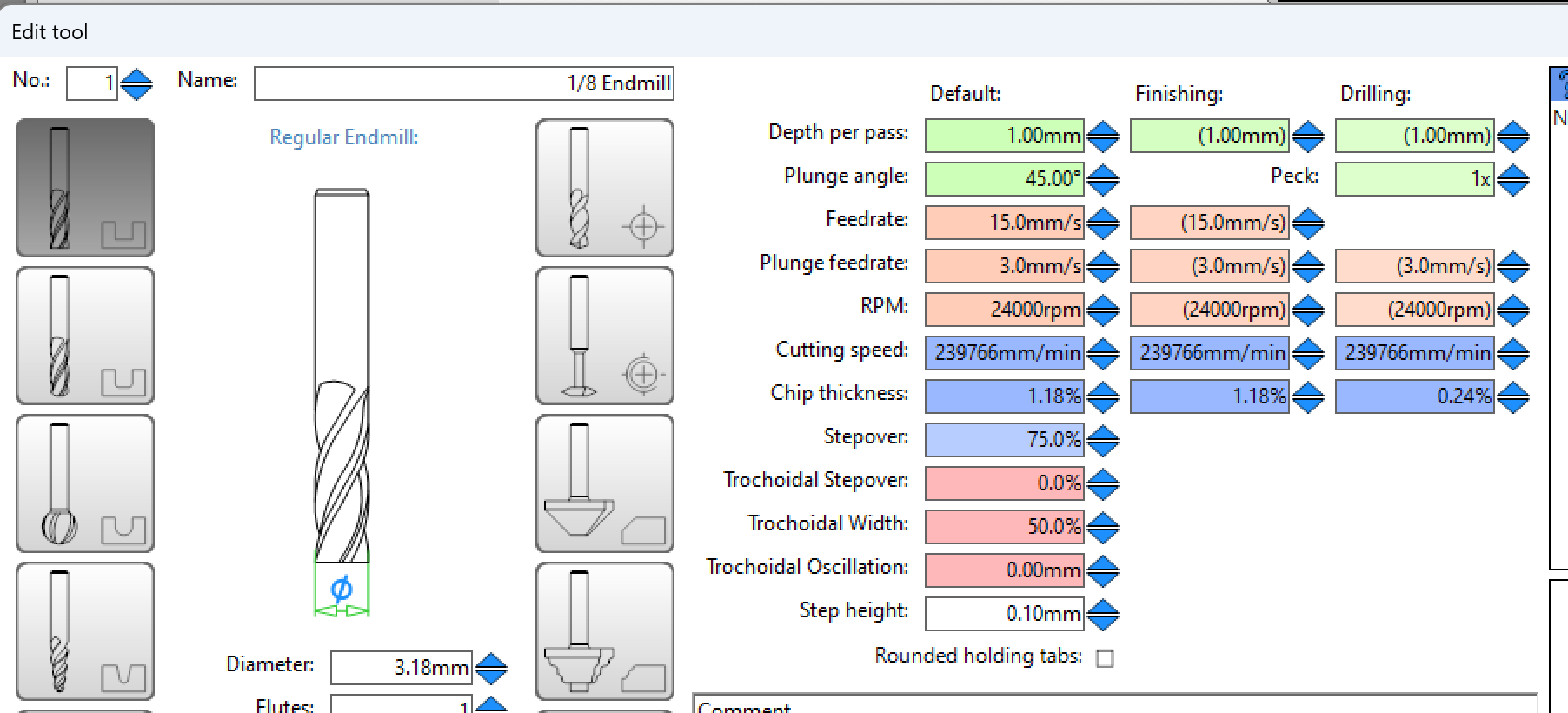

So I have an MPCNC I build awhile ago that I just upgraded in the following ways:
  • New Jackpot Board
  • ESTLCam 12 Upgrade
I was trying to basically do things from scratch but the cutting is so slow. I never really got this thing on rails so I would REALLY appreciate some hints.
I have the following setup:
In ESTLCam I have the following:
The machine starts and moves very quickly to the start position and then it goes at a super slow pace such that I could not really see it moving at all without really focusing on it.
The GCode starts like this:

G02 X100.2961 Y106.5022 Z0.1667 I-0.7950 J0.0000 F3.000 S24000

G02 X102.2041 I1.1528 J0.0000 F15.000
G02 X98.4676 I-1.8682 J0.0000 F15.000

Change this to millimeters per minute
It is currently sending your mm/s value as mm/min
These should be much higher
like 60x as high :slight_smile:
Thanks so much! I figured it was one of those settings but was not sure which one, not exactly intuitive to me at least.
