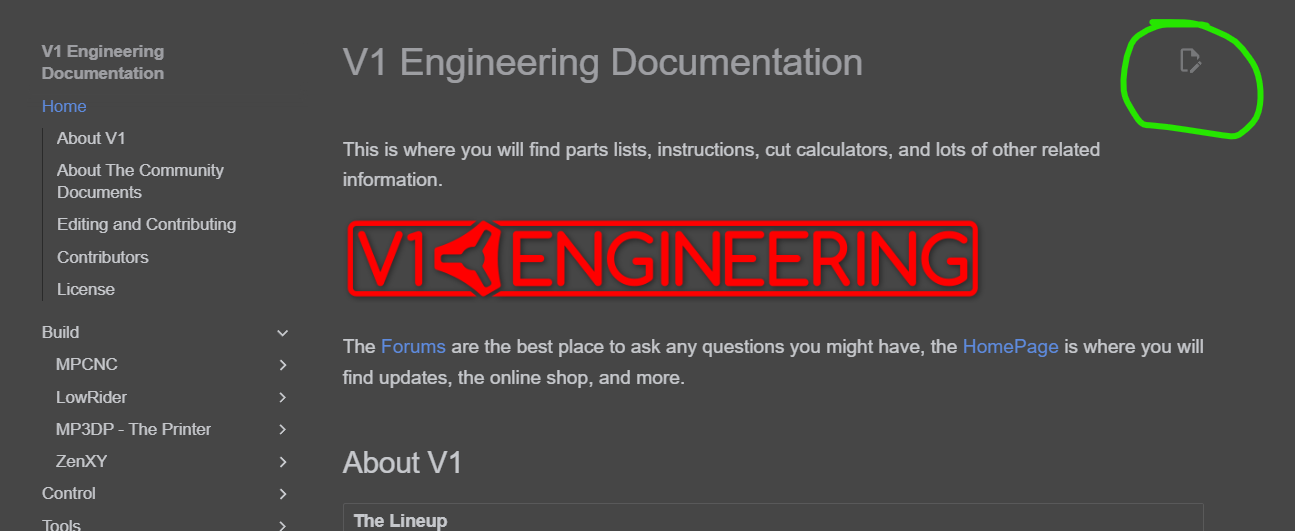

Related, is it possible to directly submit changes to the documentation by a pull request or something? I already have some notes to improve clarity from the little bit of assembly I was able to do.
Yes, it absolutely is.
See the page here: V1 Engineering Documentation
Scroll down and there is a good description of the community documentation.
One of the more difficult tasks in a community like this one is writing/reviewing/revising the documentation. We’ve all collectively built these machines and helped people build them. We lose track of what it was like not to have context and frame of reference when new to them.
Thank you for offering to submit a pull request to improve the documentation.

Unfortunately, I do have limited time, one man company. Currently, the images and instructions cater more to purchased kits. When self sourcing, I do highly recommend looking at a few of the images to get a sense of what you are looking for.
When I do finally finish the LR4 instructions I will revisit some of these finer details.
Otherwise you can get your changes in right now by helping out and making the edits in the instructions and submitting them for approval. This will help you, me and anyone else self sourcing in the future for years to come. This is a community project and getting a little help is so appreciated.
Simply log in and click the edit button on any page.
