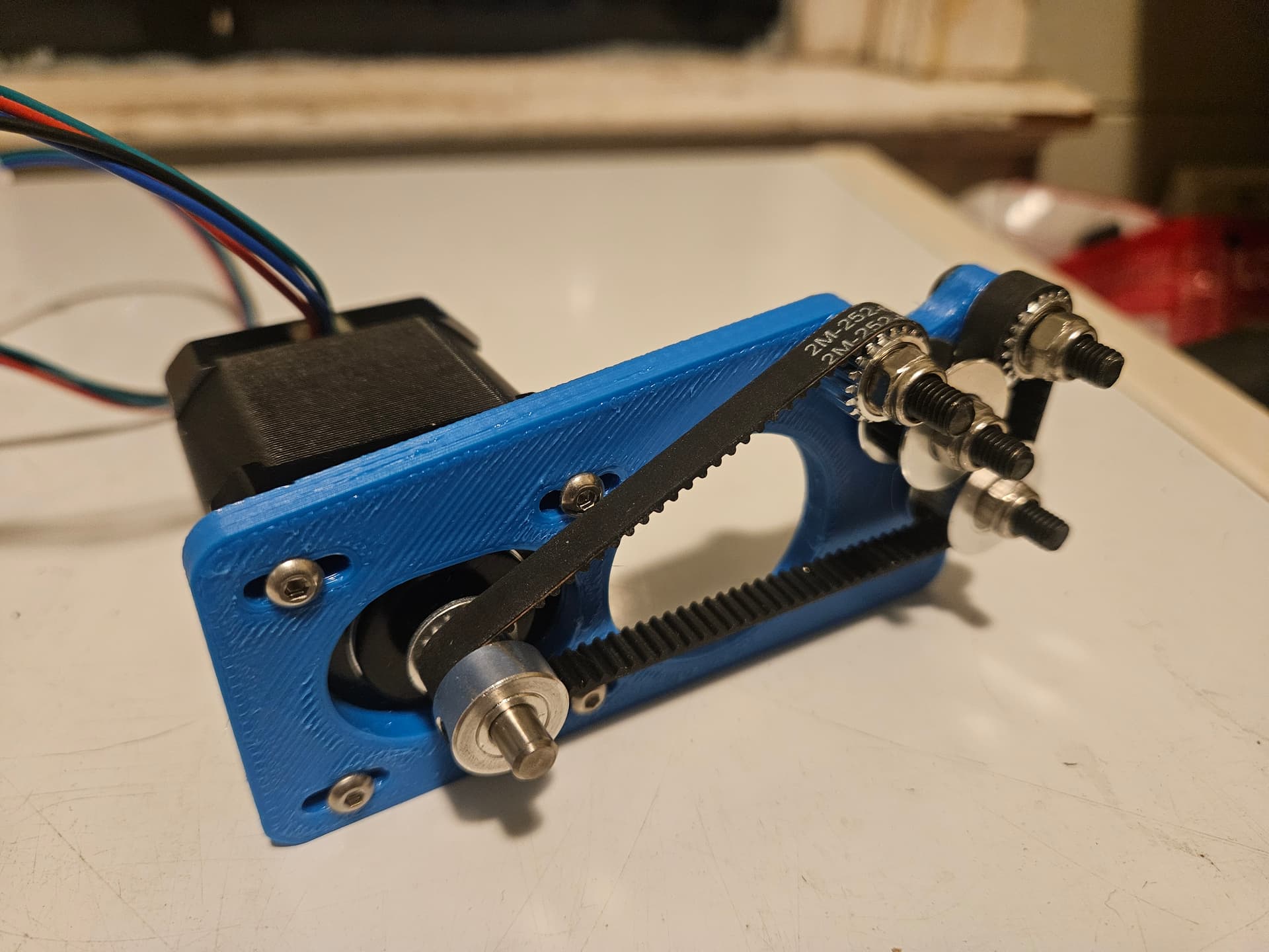

Well, the A axis drive part is ready.
Based around a 252mm GT2 belt loop, features a 16T motor drive gear and 20T pulleys. The guides were removed from 2 toothed gears to allow the belt to stand proud of the gear and be the interface between the drive and the work.
The motor mount allows for 7.5mm of adjustment for tension.
This should give me a surface speed close to the target of 100 microsteps/mm, but it will be off by the difference between the tooth circle size of a 20T pulley and the size at the back of the belt, but this is a pretty small ratio. The math based on the theory gives me 96.46 steps/mm. I can probably just leave it at 100 if I switch out the rotational axis for X or Y and it’ll be close enough, but it’s easy enough to correct for.

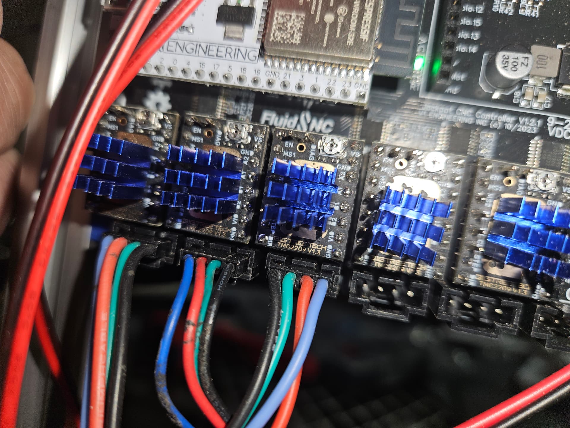

So I pulled the Duet and put my Jackpot on this. The motors are set up as XYY. I did have motion, but have not used it a while, and now I need to laser some stuff…
X moves OK, Y2 moves OK. Y1 doesn’t move, but does lock.
At present, I have not had enough correct movement to actually try the laser, so not sure if it is set up correctly.
I wanted to do some.laser engraving for a gift. Can’t believe howong it has actually been since I’ve had this working.

Your Y axis YAML is missing the 2nd motor definition (motor1:)
The comment is #Z, but it should be there as motor 1 in the config… pretty sure that’s the one that works…
You also need a
Y
Motor 1.
The entire second Y motor config section is not there.
I made the same observational mistake, the #Z comment masks this.
At this point, I want to see the $ss ouptut from the machine.
$SS
[MSG:INFO: FluidNC v3.9.6 https://github.com/bdring/FluidNC]
[MSG:INFO: Machine XYY Laser]
[MSG:INFO: Axis count 3]
[MSG:INFO: Axis X (3.000,1263.000)]
[MSG:INFO:   Motor0]
[MSG:INFO:  Neg Limit gpio.25]
[MSG:INFO: Axis Y (3.000,2483.000)]
[MSG:INFO:   Motor0]
[MSG:INFO:  Neg Limit gpio.33]
[MSG:INFO:   Motor1]
[MSG:INFO:  Neg Limit gpio.32]
[MSG:INFO: Axis Z (-1000.000,0.000)]
[MSG:INFO:   Motor0]
[MSG:INFO: Connecting to STA SSID:SupraGuysWIFI]
[MSG:INFO: Connecting.]
[MSG:INFO: Connecting..]
[MSG:INFO: Connecting...]
[MSG:INFO: Connected - IP is 192.168.42.88]
[MSG:INFO: WiFi on]
[MSG:INFO: Start mDNS with hostname:http://XYYLaser.local/]
[MSG:INFO: Laser Ena:NO_PIN Out:gpio.27 Freq:5000Hz Period:8191]
[MSG:INFO: Probe gpio.36:low]
Drat, I managed to bust the microswitch for Y2… well, easy enough to repair
A pic of the motor wire connections. The paler blue are the wire extensions to X and Y2, the darker blue are straight to Y1 motor.
I also tried swapping the TMC2209 drivers with a different channel to see if it would help (it did not.) Edit: Wow, I managed to move those heat sinks around a bit swapping them…
:man_facepalming: wow, is my face red.
Okay, so it is probably reasonable to assume that when you change something, and the machine stops working to blame what you changed. Maybe even moreso if you aren’t super confident in what you changed. I’m not super confident with FluidNC, so…
Nope.
I swapped the Y motors to eliminate mechanicalnissues and the problem stayed eith the Ymin motor. Oh? Start troubleshooting the wiring, the motor… that’s the only motor that does not have a wiring extension…
Hey what’s that? The belt isn’t tight around the motor pulley. It’s just close enough that when I try to pult pull the axis it locks, but if the motor spins… nothing. No power.
So apparently, when I swapped the board, I must have pulled the Y1 belt in the extrusion and loosened it. A quick adjustment, and voila!
Side note though, because I’d swapped the motors, homing failed, and I broke the lever arm on the Y2 stop switch. :frowning: quick to fiz, but annoying.
Apparently I have the laser configured correctly, and I was able to do.a quick engrave… then I want back to LightBurn and swr the max power to 255 from it’s old setup of 1000… fortunately no damage done from 98% power instead of 25%…
