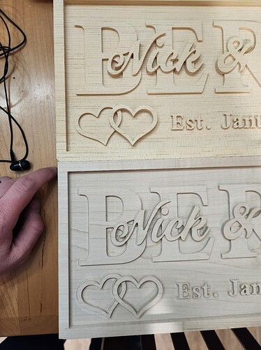

  6. Z-Height seems inconsistent even though I’m using a touchplate. I’m not talking about the issue above, but on a pocketing example, I get two different depths between tool changes. It doesn’t always happen, but when it does, it comes at the worst possible time. Here’s an example:
Not sure if the photo shows it clear enough, but both cuts ran the exact same GCODE. It’s a 1/4 inch pocket and the 1/16 finish. The pine practice cut on the top doesn’t show the 1/16 bit line, but the cut on the maple has the 1/16 bit almost 1mm deeper than the pocketing bit. Both tools used the V1 touchplate to set the Z-height. Is there that much slop in the Z-axis? I checked everything that I saw and nothing felt loose. Leadscrew is lubed and moves freely. Unfortunately the cut is too detailed and the maple is hard enough that I don’t think I can sand my way out of it and it doesn’t look good enough for me to give it as a gift. So now the bride & groom will likely be getting a gift card.

A LowRider is definitely better at that size, but your results look stunning and they are not a beginner’s project and you still did it. Your speeds and feeds are fine for an MPCNC in my opinion, I never went faster than 2000mm/min and 3mm deep in hardwood/plywood with mine and it was smaller than yours.
For the depth,
Harder materials are… well harder. What works for speeds in pine might not be as good in maple. My Primo showed similar problems even without switching bits in many of my early projects, the larger pocketing wasnt the same depth as the outline. The majn difference was that the machine was working slower doing the outline than the straight pocketing.
This told me that the machine was flexing doing the pocketing, which effectively lifted the bit. It was less obvious than your ~1mm, but definitely there.
The solution was to slow down.

Your projects look great! The out of square is from a motor step skip somewhere… Too fast

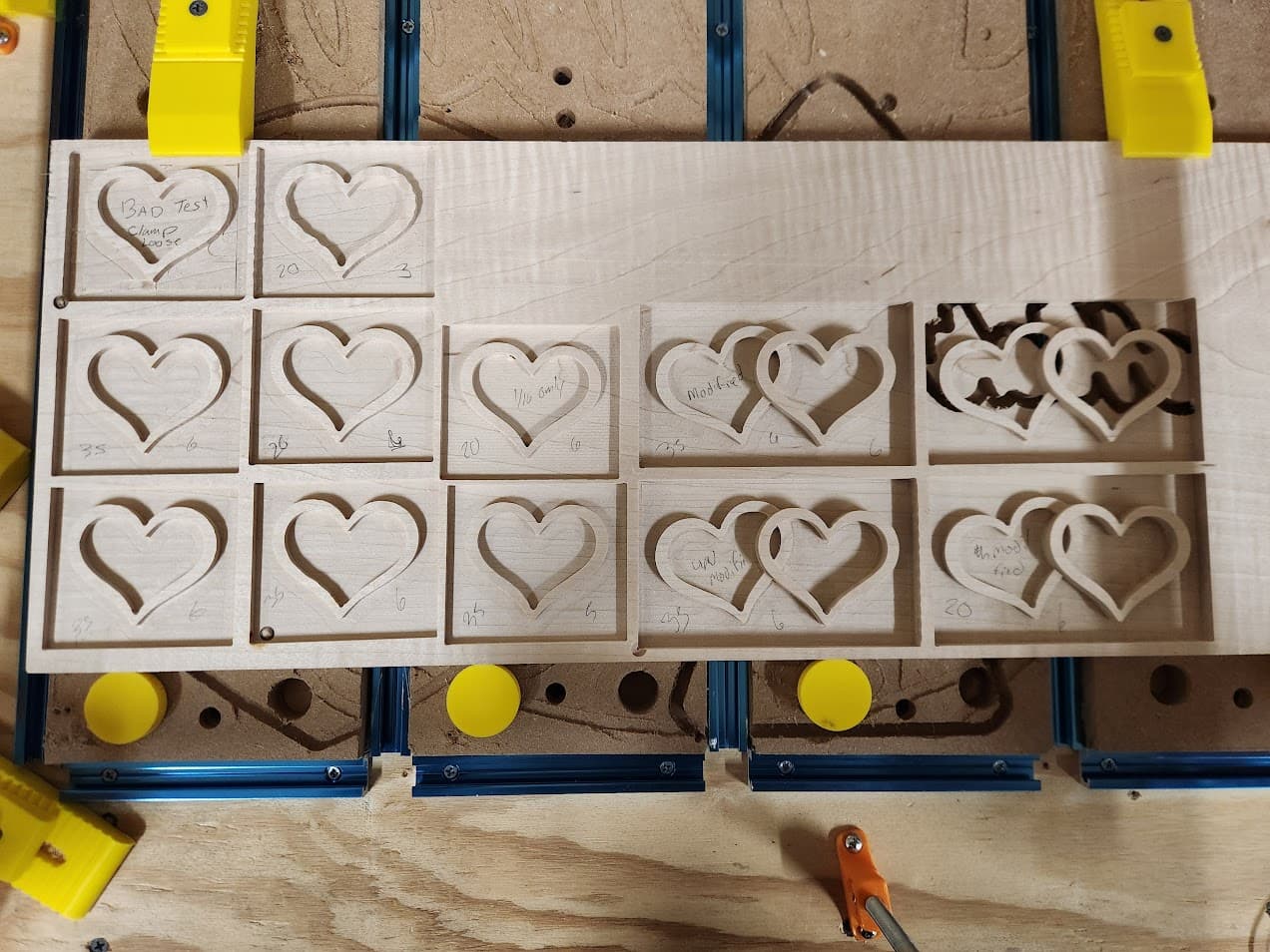

So after some reflection based on things said here and my own observations, I tried some test cuts on the back side of one of the maple cuts that had really messed up. First I think that some of my severe Z axis issue were indeed from getting the router caught on one the of the bearings. The downcut bit I bought for this is a bit longer, so the router is in a higher place than normal. And that explains why I didn’t have any resistance when I took the router out. User error, so I’m cognizant of that now.
The big issue is the finishing bit being a different height and I thought out it. The V1E simple touchplate has an alligator clip. It’s difficult to get it clipped on to a 1/16" bit. My first test cut, I ran the same parameters that I did as the sign that failed. There were no issues with the finishing passes being deeper. So my thought is that maybe the clip is moving while homing the Z position and causes some inconsistency there. I had an idea using a magnet to stick the clip to the collet nut instead and that seemed to work. I ran a bunch of test cuts with much better results. The only ones you can see are barely there, certainly less than the 1mm issue I was having.
The markings are what my feedrate was and what the router dial was set to. 35mm/s is what I was set to when I was originally doing the sign. It is easy to see where the 1/4" bit went around the heart. I am not sure if there’s anything I can do to improve that. One of the cuts I slowed down to 20mm/s and a dial setting of 3. You can see it had plenty of chatter, but it also didn’t alleviate that border at all. The only one that didn’t have that border is when I did the entire thing in 1/16" bit, but that you could see way more cut lines that I think would be harder to sand out than the border of the 1/4".
The far right test cut obviously hit into the mistakes I had made on the previous side. That one had the worst different between the two bits, but it still isn’t bad at all. And I can’t put a ton of stock in that because of what was on the underside.
