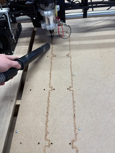

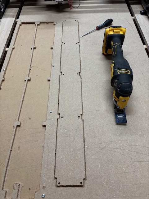

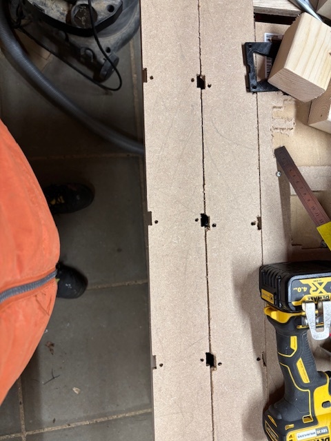

I recently milled the strut plates from my LR4. Today I took of the temporary printed once and wanted to replace them with the plates. I then discovered that the holes are not aligned with the notches. First I thought that the holes were milled incorrect, but closer inspection showed that the notches do not align. As you can see on the pictures the notches on the left side of the strut are about 5mm misaligned. It is cut with 3 passes, so it is consistantly incorrect each pass. On the estlcam software the notches are aligned.

they should be aligned, please double check your machine verify your feeds/speed or else, because they should match on the notches
Yeah, it seems like the machine cut the struts and the first row of holes right, and then it had a hickup somewhere, maybe a cord that got caught, a step that was lost, something in the way.
or maybe he did one as a part and the other as a hole/(cut from the inside), watch carefully the picture with both struts
All is aligned in the file and eslcam. Strange thing is also, today I cut another strut plate and it had the same issue. So it is definitely repeatable and not missed step or something. It takes the same path each pass. For the third strut that I cut I also slowed down the speed and used another but, hence the somewhat cleaner cut.

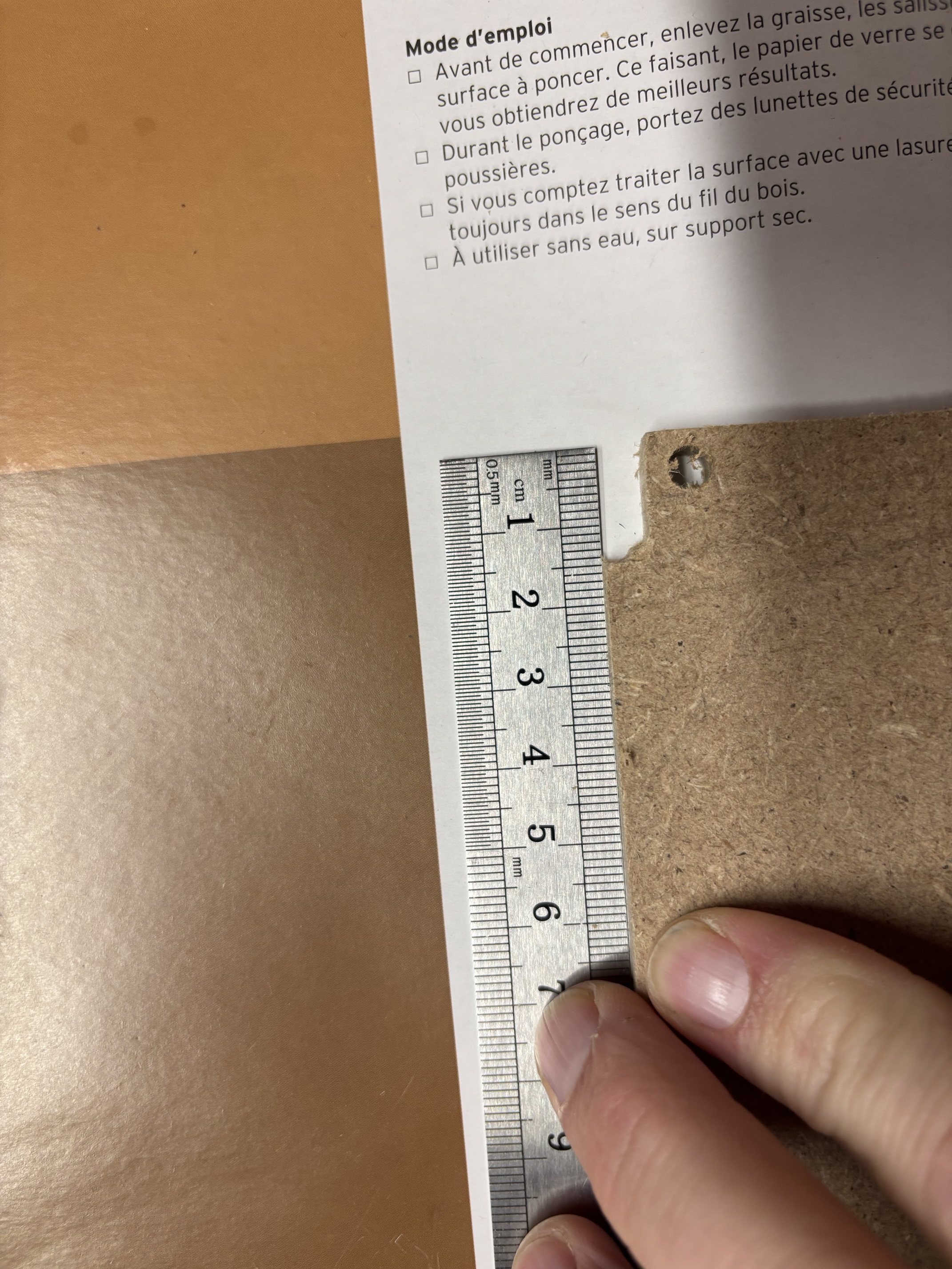

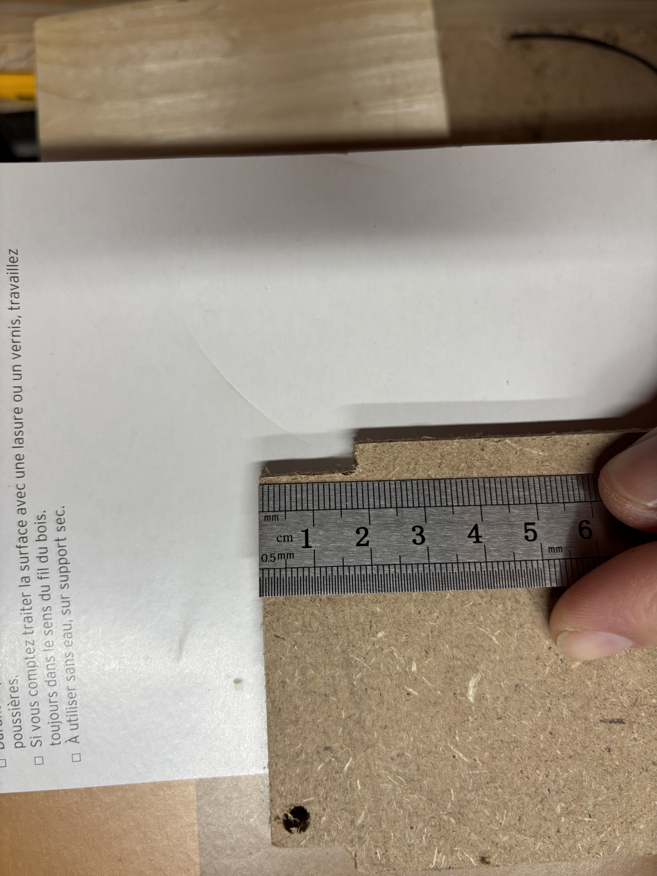

Ok did some measurements today. The holes seem to be correct, they line up exactly the same with every plate. Also the length and width seem correct. It is the notches that are off, but the amount differs per strut, so I think I can rule out the CAM (made same one twice). I now will put back the temp struts, check the wiring, redo the squaring and then I’ll draw the struts with pen insert first to see if there is an error somewhere.
Today I finally had some time to troubleshoot. After reading some other posts with issues, I first wanted to check the grub screws. And yes, some were loose. So I added some loctite and fasten them. Resquared the machine and cut one strut plate again. It looks to be so much better now.
