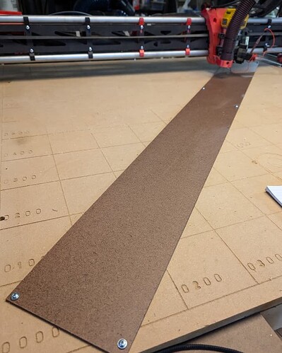

Strut cut on a 4x4 LR3
Being that the struts are the length of the gantry toobz, at approximately 55” and my cut area is 48”x48”, does anyone have suggestion/insight for achieving the profile of the struts?

Or alternatively you can make the y bigger temporarily
Orient the cut on the diagonal?
I did mine diagonally. The flipping method looks promising. I had to convert the SVG from the LR4 generator to DXF via inkscape, before I could import into Fusion for rotating and to make sure it’d fit on my (~4x4) table, exported to DXF 1 at a time, and back to Estlcam (which I think can rotate anyway, just wanted to double check that it’d fit.)

It is possible to rotate with Estlcam. I used it when I cut the LR3 struts diagonally.

I just did mine in 3rds.
See here, He flipped them with the help of locator holes.
I myself used the bolt holes already there. I then changed positions easily, with 4 reference points.
Zeroed it at first, but then in Estlcam I kept using the lower left bolt hole (In the area I was cutting) as my zero.

Guess i did not save the project, but here is how it was done (just recreated it quickly is all)
Remember to drill the first 4 holes deep into table for Reference!
I need to add, i manually removed z probe,etc in file 2 and 3, Philipp was key here, you do not want to change zero at all from file 1 to 2 to 3
