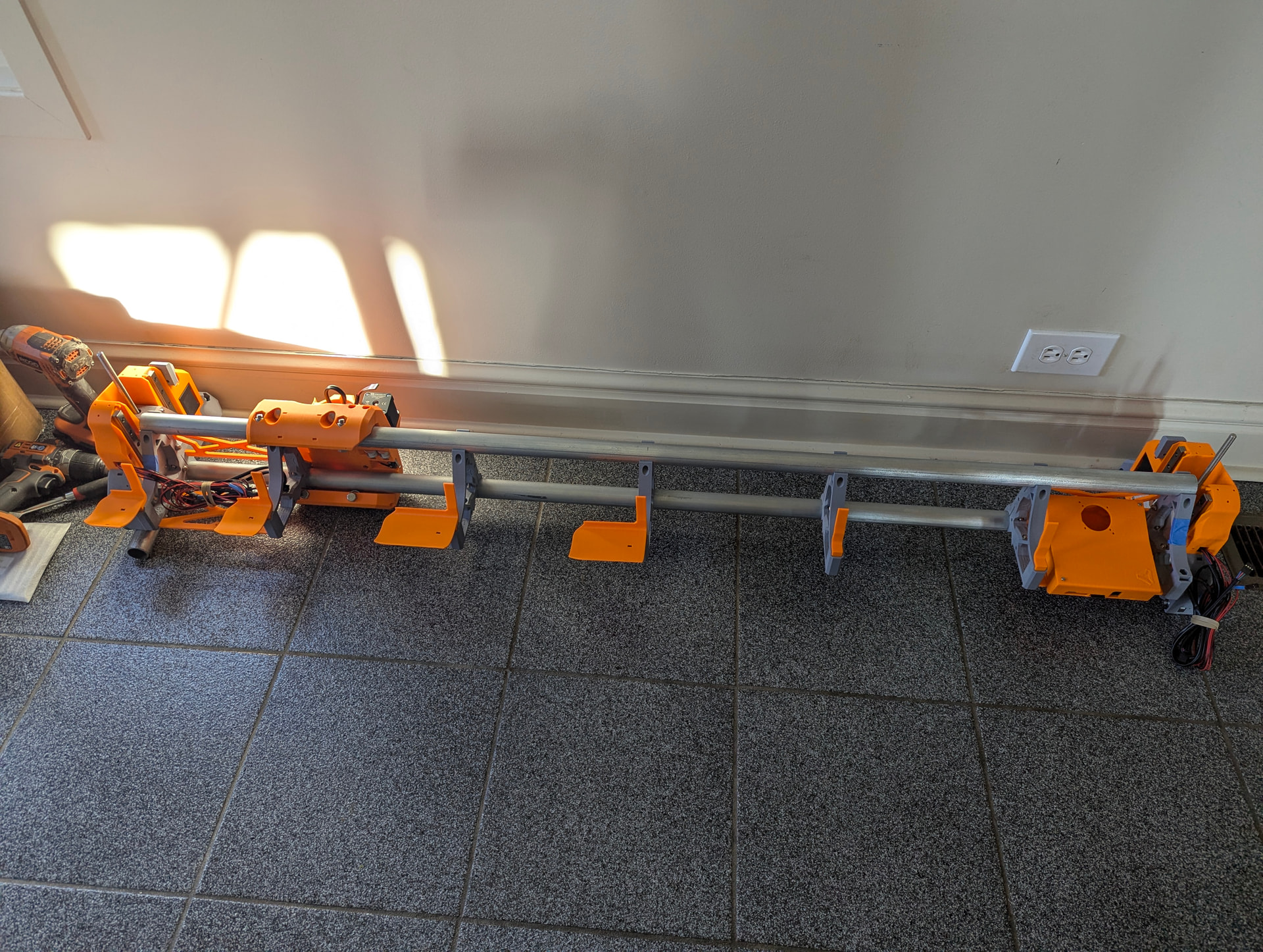

I just built my LR4 in December and I made it approximately 32" W x 42" L, similar to what you seem to be leaning toward. When in use, the whole thing sits on my table saw and outfeed table. It takes me about 1 minute to stretch and remove the Y-belts. I don’t unscrew the tensioners. The board then sits against a wall and the gantry sits on a work cabinet in my garage. It takes maybe 2 minutes to put it back together and it runs square without any fuss.
My LR4 uses a 36” hollow core door as the main structure of the table. The door sits on foldable saw horses. I get about 2’ x 5’ for a cutting area. The table is very light.
When I store the machine. I jog to mid range for X and Y. The Z I jog to near home. I do the Z axis this way so that the gantry does not drop when I pick it up. The Y belts are easy to un-hook, roll up, and store on the gantry. I pick up the gantry and store on a 3’ shelf. The door is light and easy to pick up and store against the wall.
It takes me about 5 minutes to store or setup the machine.

Those of you who have created a storage solution for the LR4, would you like to post some pictures?
I’m going to hoist mine to the ceiling as my garage has over 11’ ceiling. Plan on modifying a winch system from an overhead storage system. I don’t have legs on my torsion box it will sit on metal sawhorses so there will still be over 8’ of clearance when lifted. My table is 9.5’ x 5’ in case you were wondering. Not sure if that helps but maybe help with some ideas.
