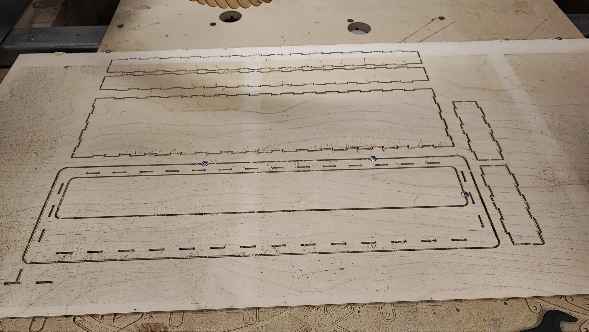

One of my regulars (he is bringing my kids through college…) wanted to have a box that he could put into the door of his camper for storage, cutting a hole in the plastic cover. He couldn’t find the proper size and asked me to 3D-print it and I was like: No, I have a better idea.
I created it with a FreeCAD plugin that lets you do boxes, even with the “overcut”. I only had to export the DXF to fillet the corners and program the hole, but that’s it.

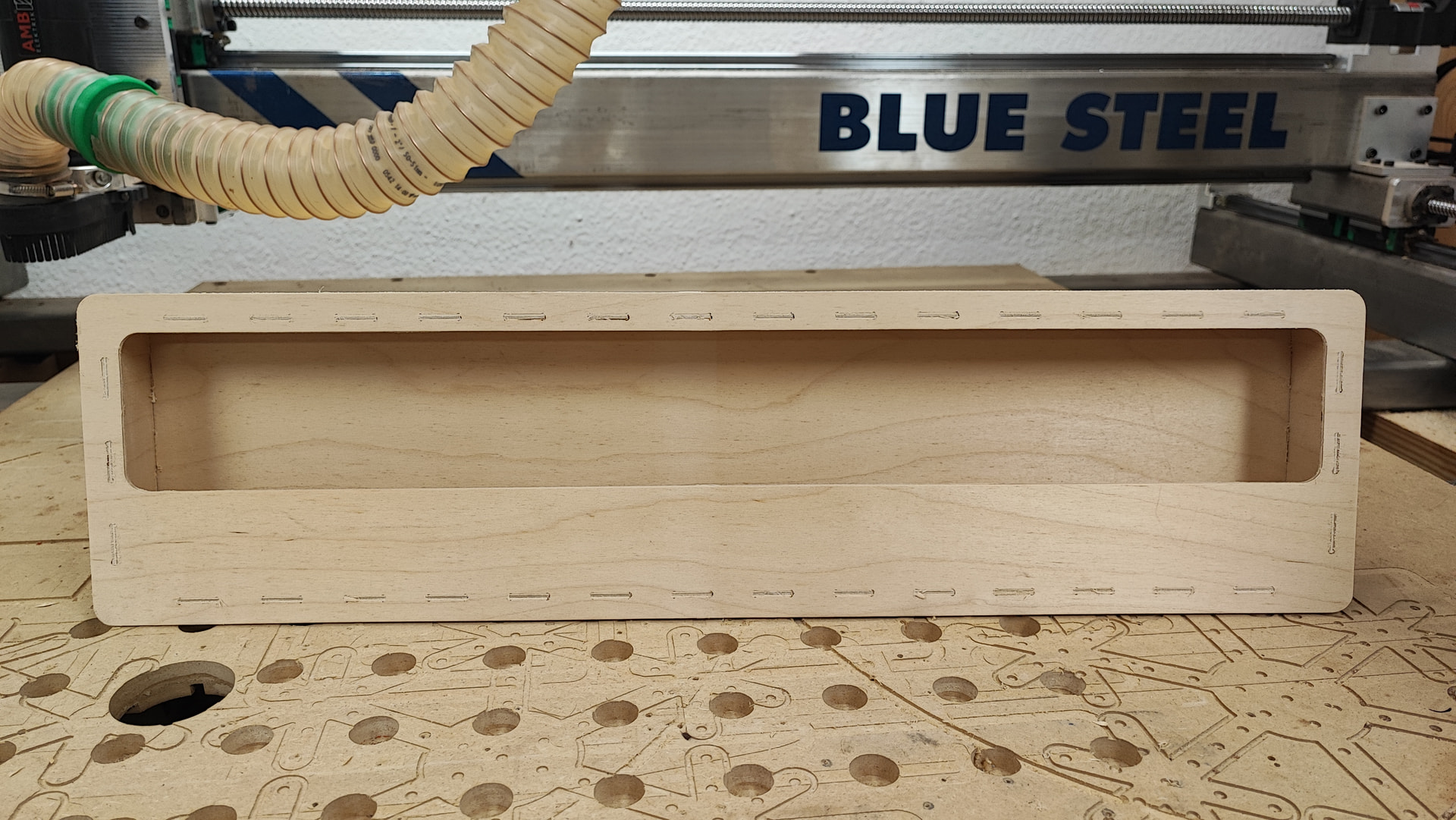

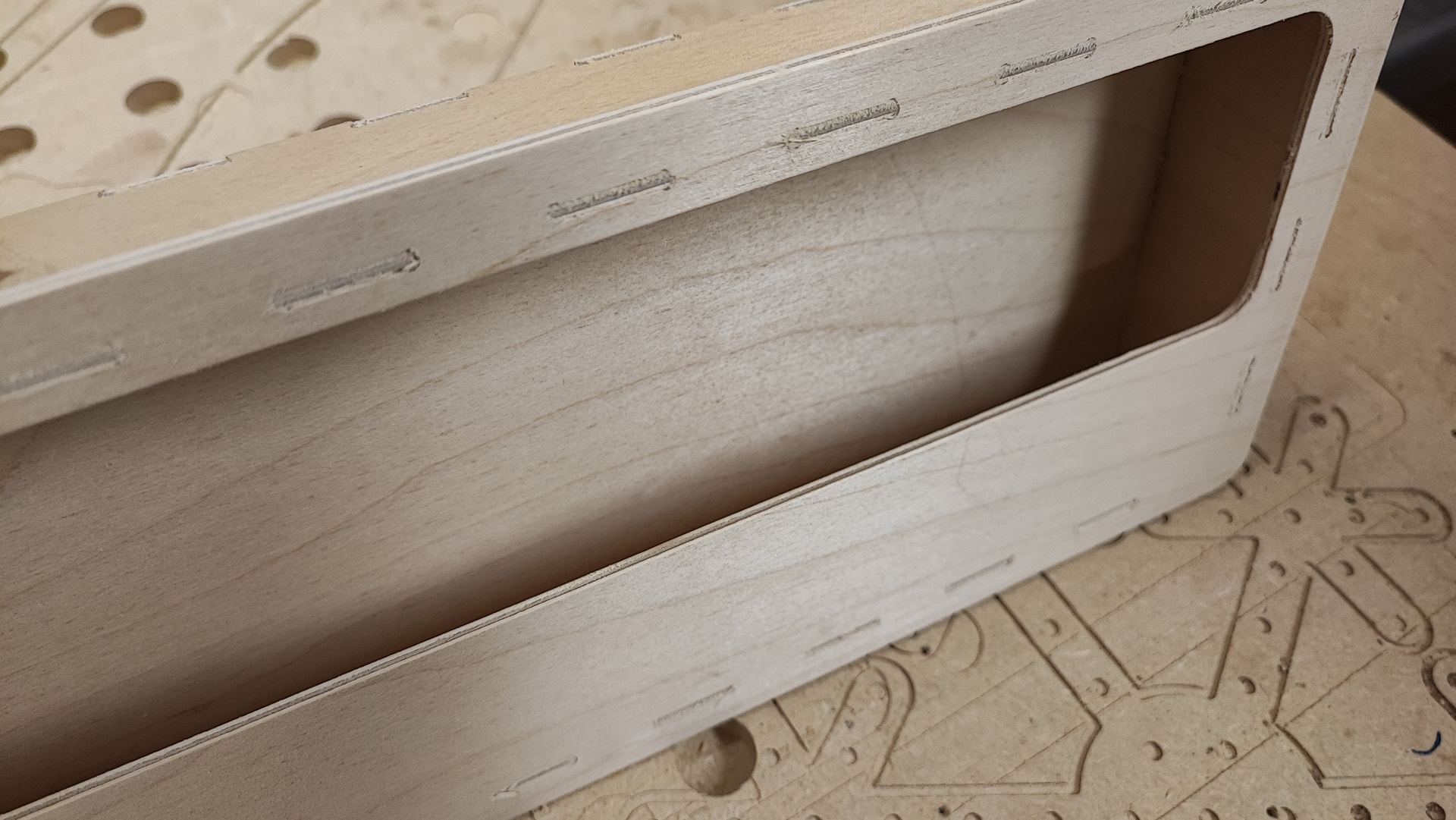

It’s made from some scrapwood from a wardrobe, 3mm plywood, perfect for what he wanted. The hole thing is holding without glue!

That looks really cool. There is something special about tapping this together with a wood mallet. I cut some yesterday and fun. I’m thinking my next box either pre-finishing the sheet or at least finishing before assembly since it’s all sanded.
I also noticed, while it sure does not matter strength wise, I love how your grain direction is correct in my old school brain :laughing:
Last old brain comment. I love that in the real world I could never exactly copy this without a CNC. But my LR4 can’t cut dovetails my old school (very old school) way.
Nice job!!
