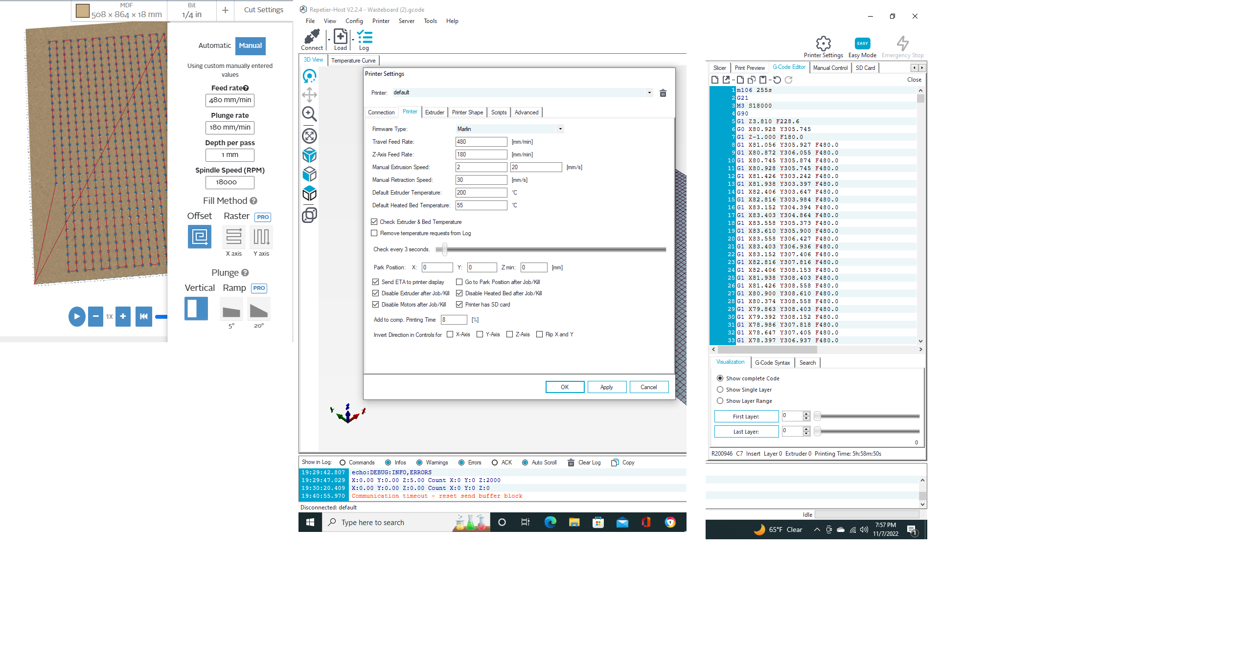

I have checked everything and I’m having few issues, First the cut stops in the middle of the work. please see attached photo which shows my setting.
I’m trying to cut a wasteboard but the machine stops in about 20 min into the job.
Second issue I have is that, one of the Y access stepper is moving slightly faster than the other one. What would cause that? All of the rails are clear of dust.

What machine, where did you get it, what control board, how are you running the file (computer/USB, or memory in a screen), does it stop in the exact same place, what program is that generating the gcode?
Most importantly, any issues with the test crown?
I will make two guesses, whatever program you made the gcode with is using an unrecognized command and freezes the board, or your laptop goes to sleep.
Need more details to even attempt this one. The test crown should have shown this before you made any cuts, gcode should not be able to make your control board do this so it is a control board/firmware issue.
Im using rambo 1.4 purchased from V1, hard wired to my computer. The computer sleep mode has been disabled and Im using Easel to create the G code. I am running a 25ft cable from the computer but that shouldn’t be an issue. As for the test, the crown runs fine without an issue. I have followed all steps to the T. The cut stops at random, so its not exactly at the same time frame.

I will try the short wire run today to see if that is the issue, is there a freeware the community uses to draw up designs since you mentioned the code could be causing the board to freeze up. Also, I did do one run without the vacuum, and it still froze up.
There is instructions in the Docs on using Estlcam and how to set it up. It can be used for free for some time. GRBL and Marlin are related, the headers and some arc commands are different and may be what is causing stalling.
Open the gcode you are trying to use with notepad or notepad++ and post it here, several of us can probably tell you what is wrong.

Reviewed some issues on the Repetier forum. Seems this happens somewhat often, depends on computer make/model, and OS, and is independent of sleep mode.
Some users have reported duplicate/shared COM ports have caused this issue. Some have resolved it by manually assigning an unused COM port to the board. Some have resolved it by using a powered USB hub between the computer and the control board.
It appears to be print buffer over run. An old time printer problem.

My original setup (I had to add an extension USB cord to my 25ft cord, so it’ll reach the computer) I eliminated the extension USB cord, and the program ran perfect (Thank you @JohnSherman for suggesting looking at that first.
