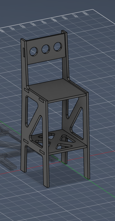

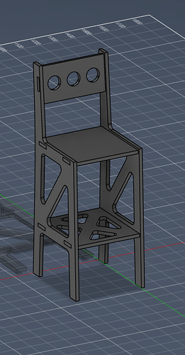

He pointed out pretty quickly I had nowhere to sit in the workshop and a lot of scrap wood. After a couple hours in Fusion we had a nice design:

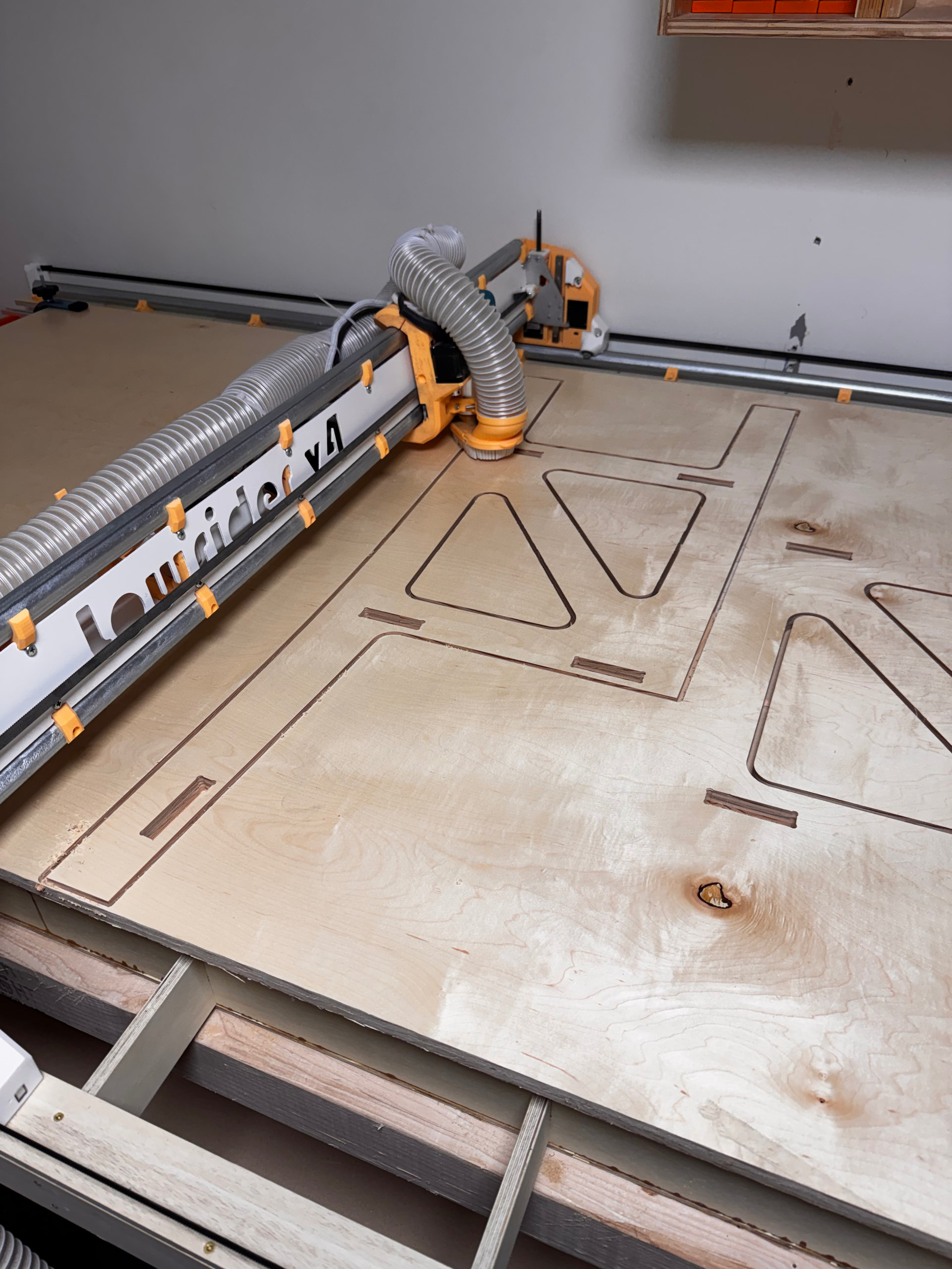

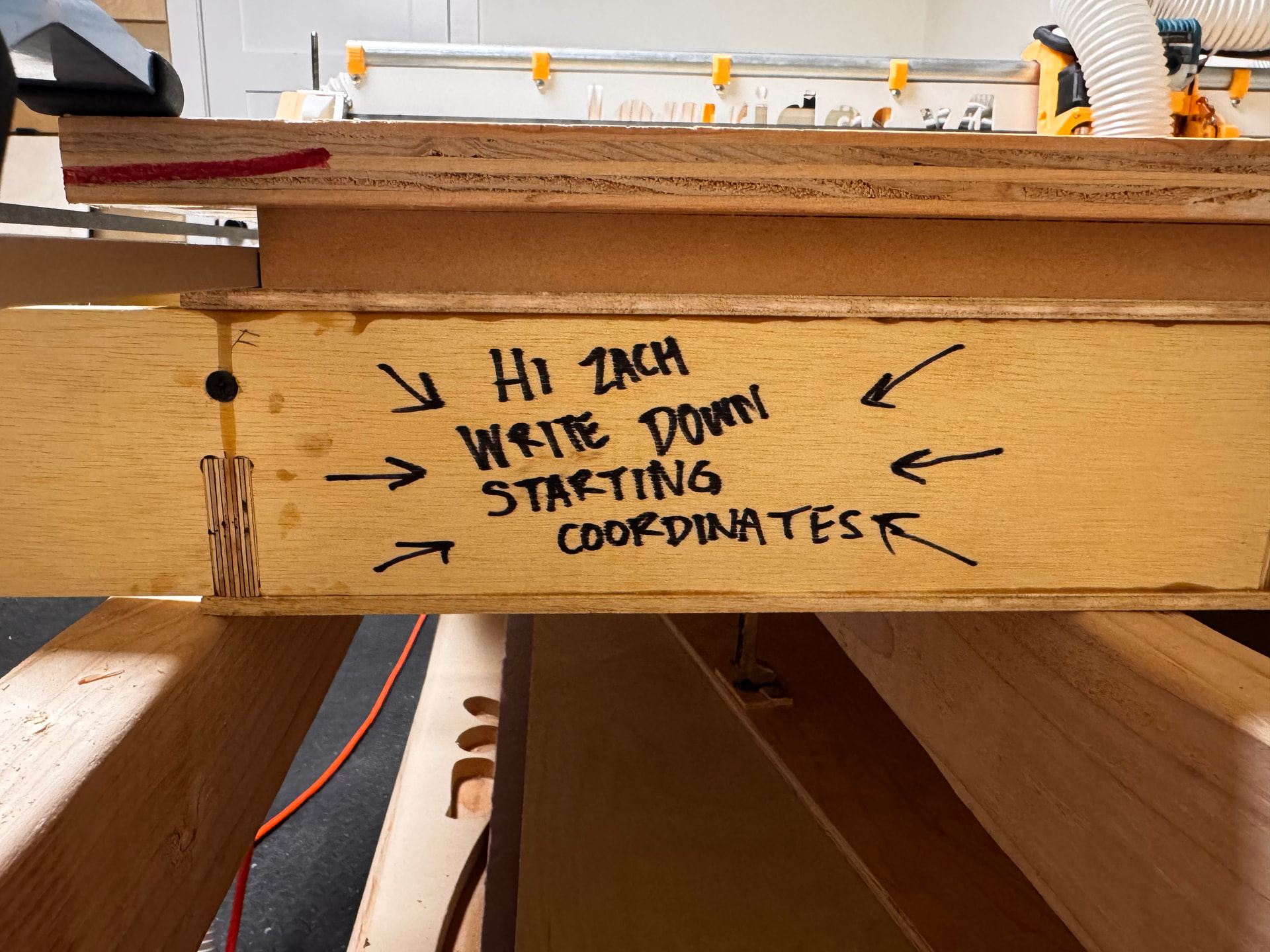

And then time to cut! Pretty quickly, I realized I’d forgotten to put tabs on some critical pieces. Rather than do the “right” thing and go back upstairs to amend my drawing, I downloaded the GCode and added some strategic M0 instructions to let me fish out the interior pieces and then continue the cut.

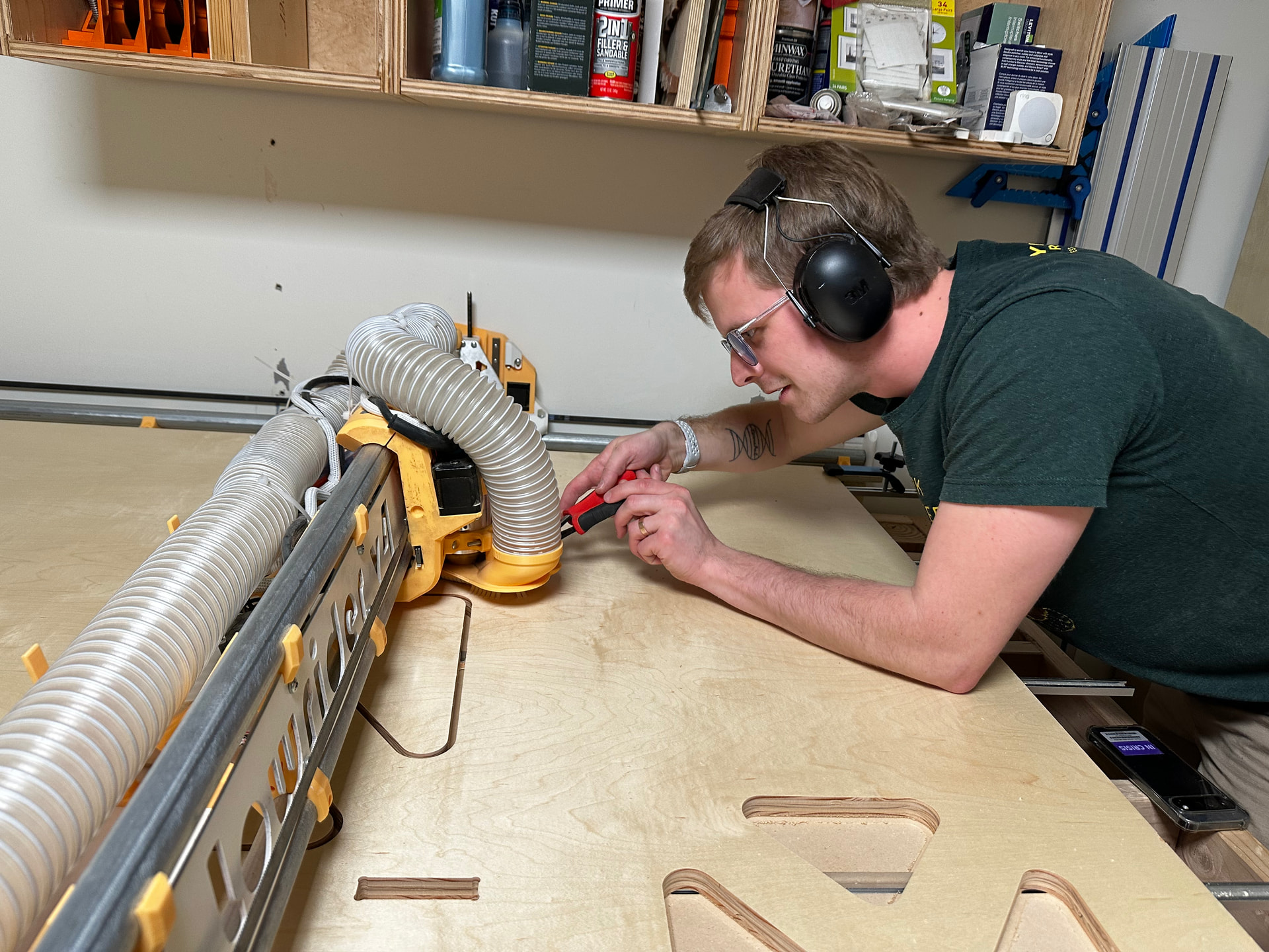

Time to write myself a note on the table – if I have to run the same cut over and over, best to start from the same place!

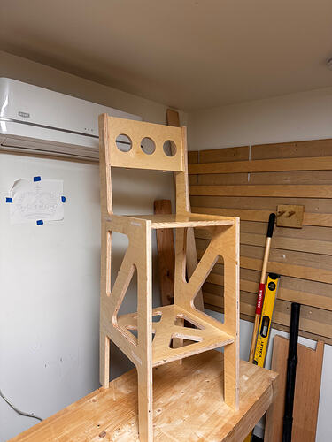

2 hours later, it looks just like the model! A bit wobbly: should have included a cross-brace. I’m hoping gluing makes it steadier. In any case, it’s just for the shop, and I’m quite happy with it!

A very nice chair but is it stable enough in left right direction?
Not as much as I like. I should have included a cross brace below the seat, but I’ll try and find a way to stabilize it enough without that.

If you put it in the front or back only it doubles as a storage. You can just include a can holder. :slightly_smiling_face:
A piece across the back should keep us circumferencely challenged people safe​:person_shrugging:

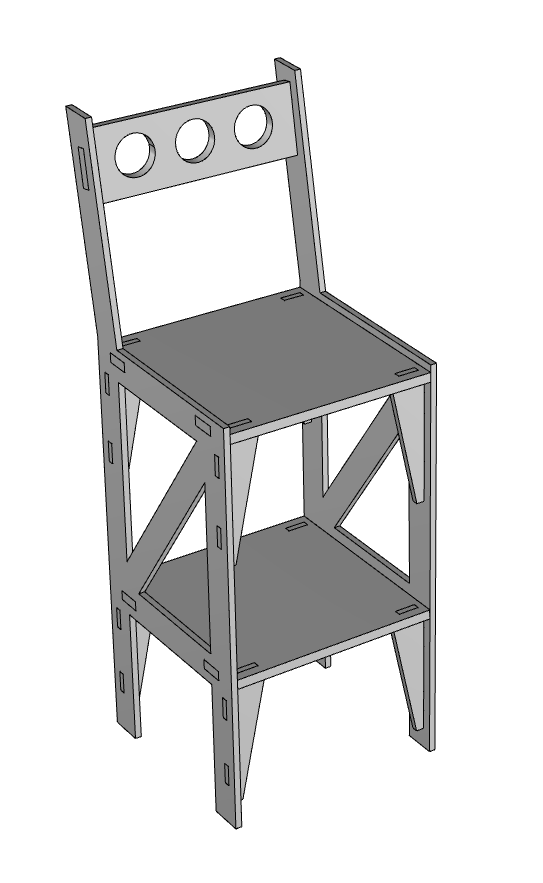

perhaps this a option?
Heck yeah, chairs are deceptively hard to do. After whatever you use for a brace I think that chair will stick around a long time. I really like it.
