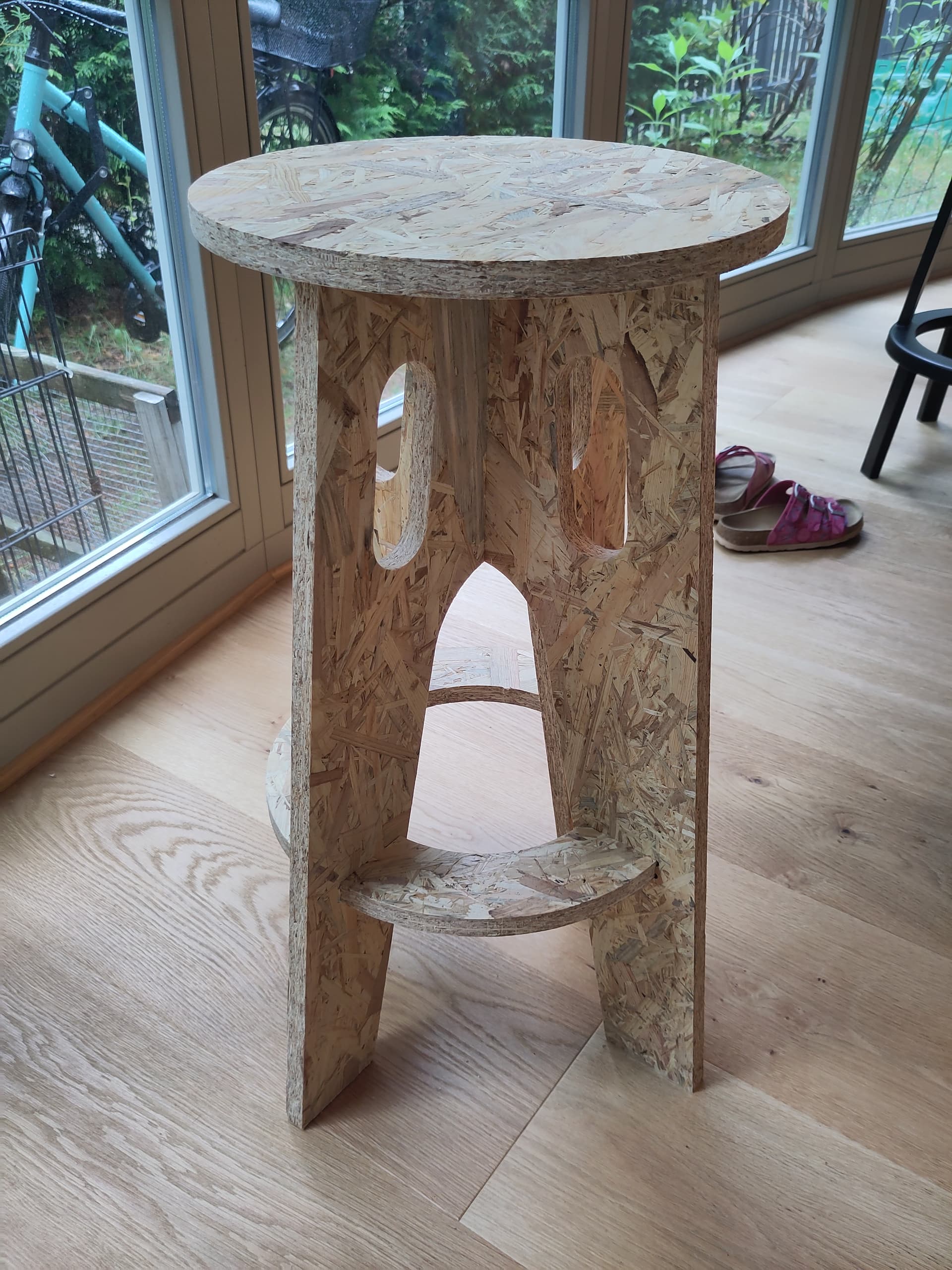

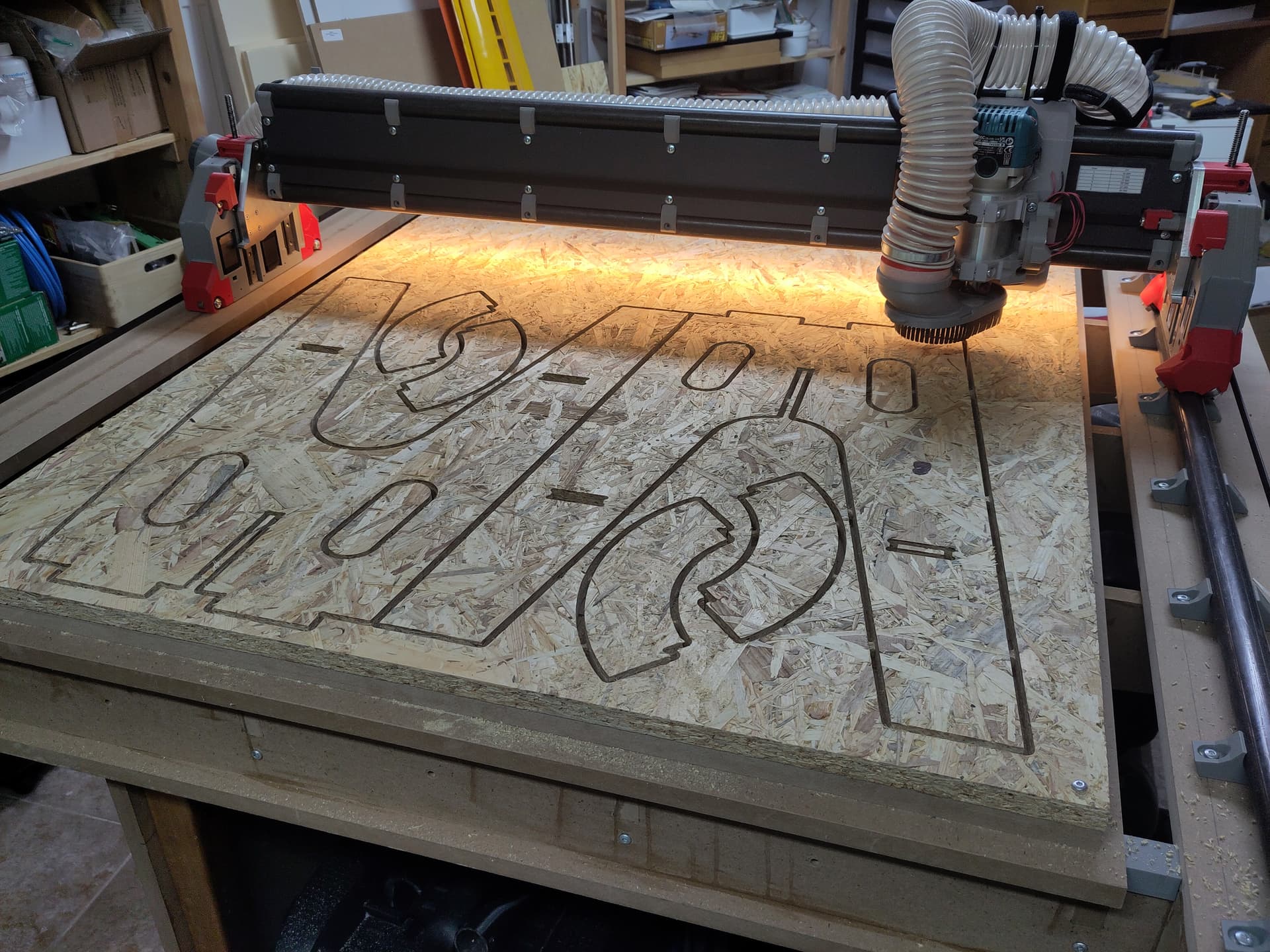

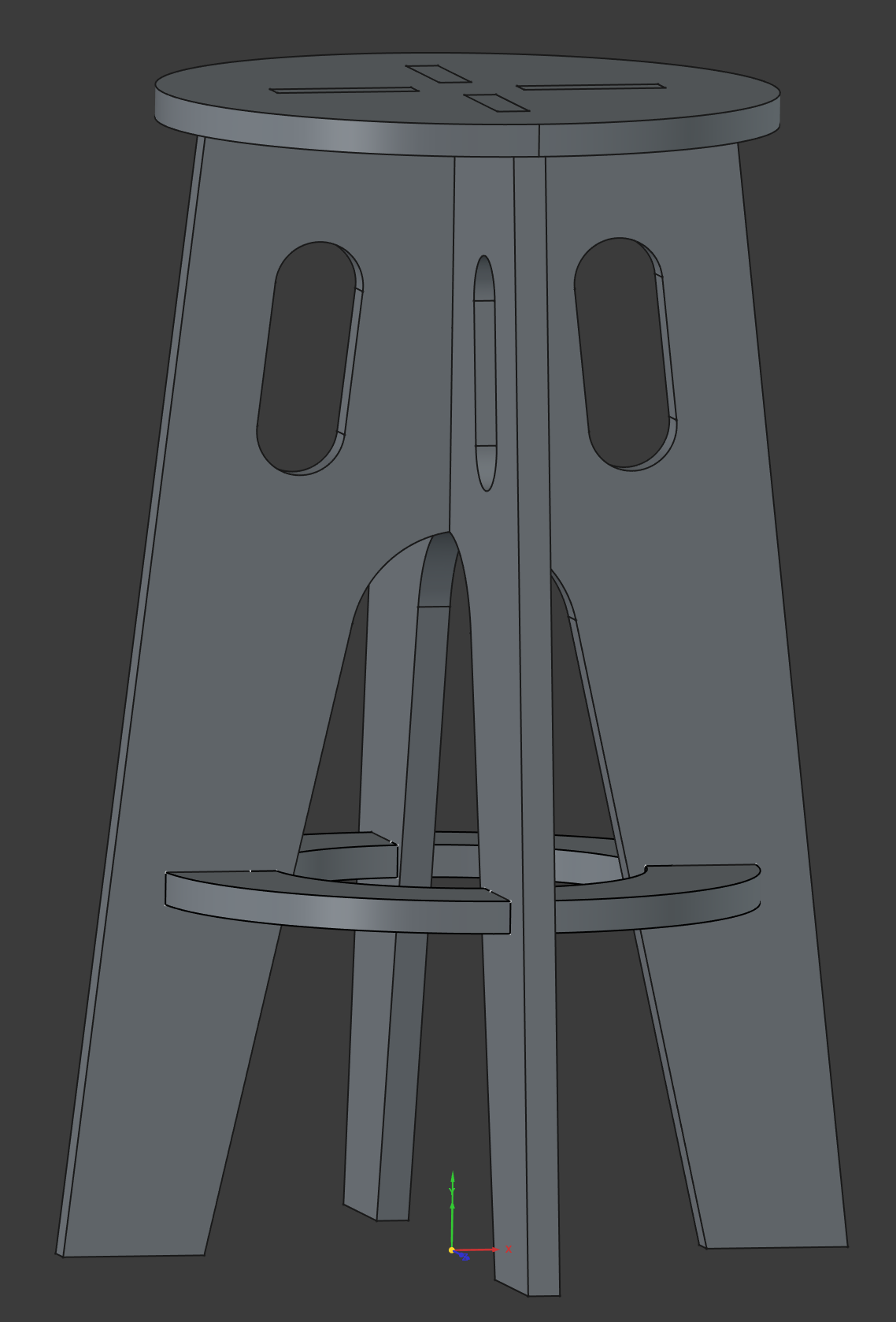

Here is my first proper cut on my LR4. We needed a fifth stool for our kitchen. I took the rough dimensions from our existing stools and designed a simple interlocking stool in FreeCAD. Cut from OSB with a 2-flute, 12000 rpm, 1750 mm/min (values from Sorotec calculator set to hardwood).

That looks great!
How did your design come out, anything you would do differently next time? Looks well fitted and sturdy to me.
hopefully you are going to cover the top of the stools. I can feel the splinters from here!
