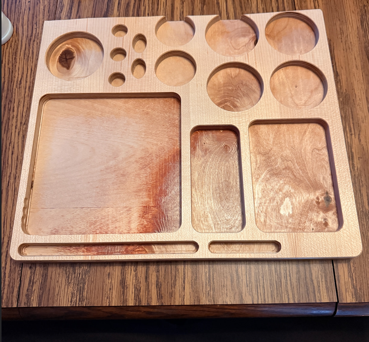

So it’s been a while since I’ve used my LR4, and to get back into it, I figured I’d make a little tray to organize my paraphernalia! Turns out this was actually my first time doing 2.5 milling, and I learned a ton! So much so that I wanted to make a post to share my piece but also my journey- nothing went well, it took lots of tries, but I recovered from many errors and ended up with something imperfect that I’m happy with!

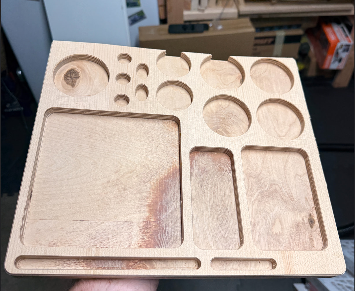

  2. I worked with the full Y dimension of my stock, but forgot that the bottom ~30 mm is unusable… so the top of the tray got cut off. This was a scrap piece so the top also has that curve to it.

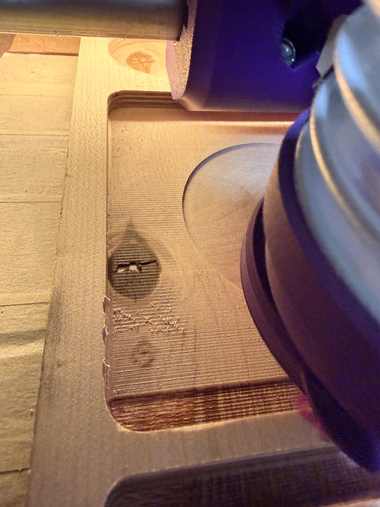

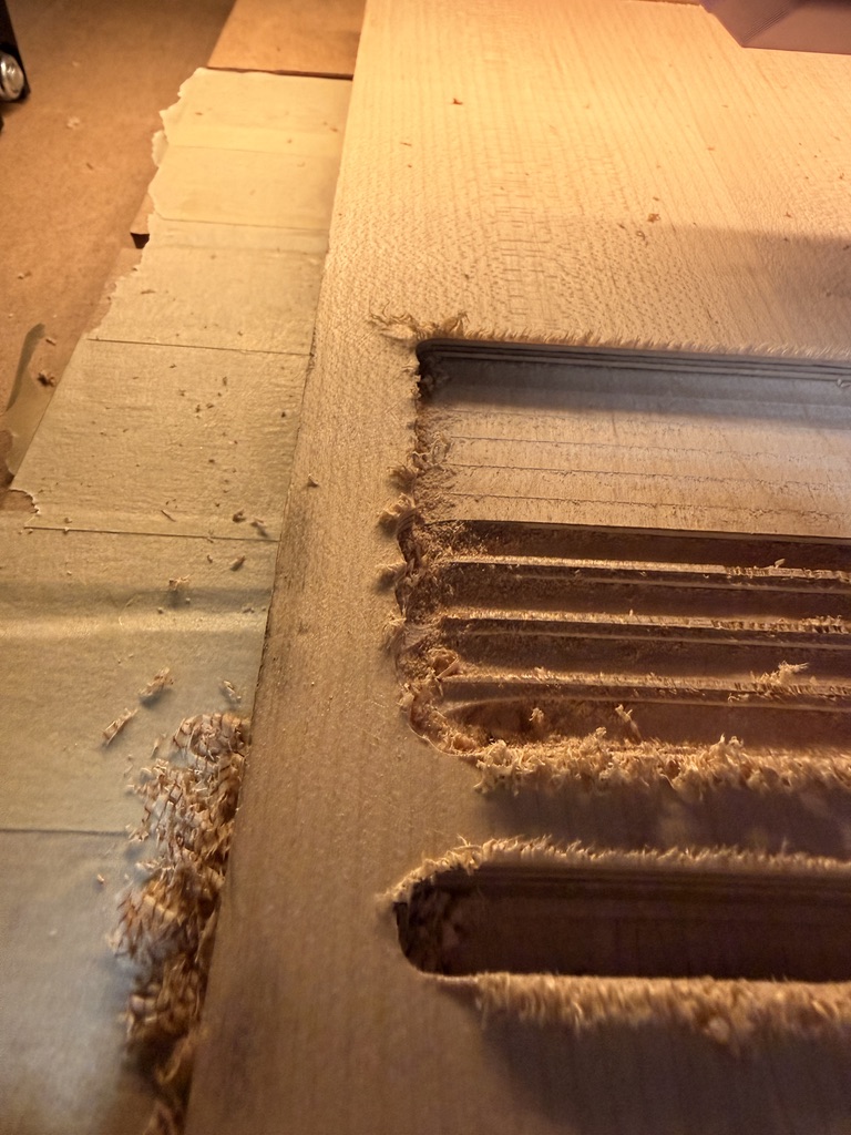

  3. Being my first 2.5D milling project, I had to learn about finishing passes. I did a lot of trial and error, mostly because I was trying to use a ball nose end mill, which kept leaving a V/U shape in the wood. Luckily my brother came over and pointed it out!
    1. I switched to the downcut bit from the V1 store. I did a finish pass of 0.3 mm, peeling, 15% step over, 45 mm/s (started slow and worked up) and it left the wood silky smooth!!

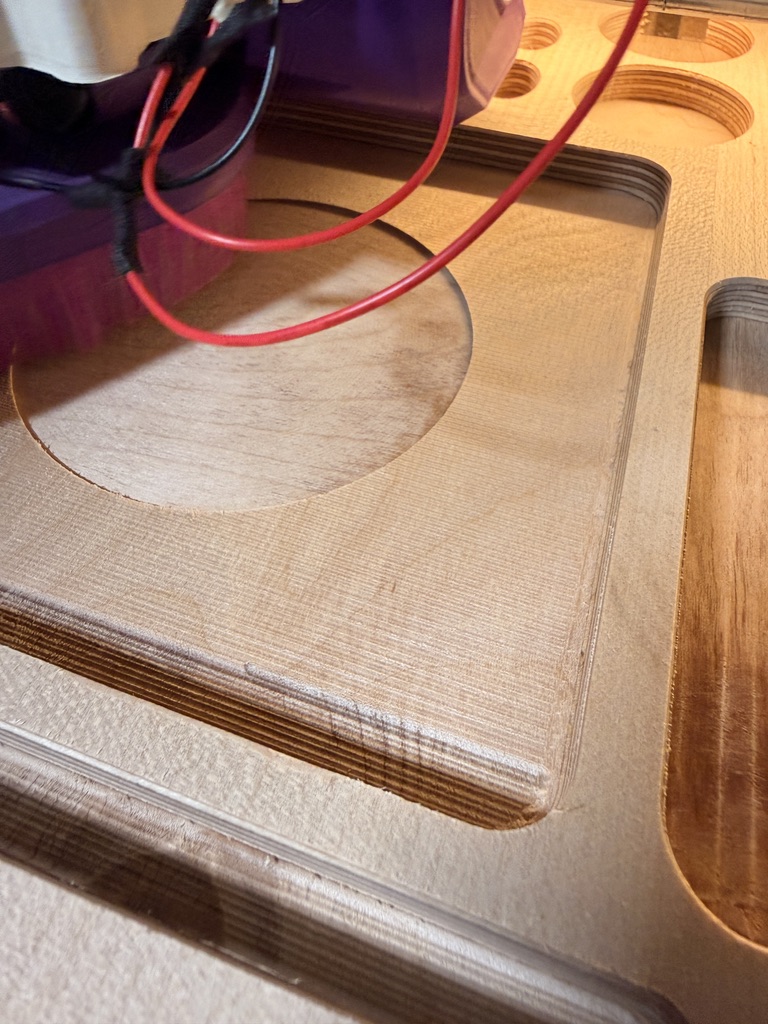

    3. Here’s a shot of me covering up the sins of the past. The circle is the peeling cut. I had to do a finish pass of 1.5 mm because I had to keep cutting this part deeper when I was trying to get the ball nose finish pass to work

  5. I did a pseudo chamfer by doing a 2 mm deep carve with 45 v bit, along the line after all the milling. It worked well enough and left a pretty clean line behind.
    1. Because the top part got cut off, I manually did a similar chamfer on my bench sander. It definitely looks freehanded, but it does look and feel a lot better than without!

So yeah, it’s lopsided, rough, and the stuff doesn’t fit as intended… but it looks awesome! And I made it on the computer, and then made it a real life object, that’s literally magic! Most importantly, I learned a tonnnn in the process :smiley: . Plan is to use it for a while and scribble down notes to make an even better one later :slight_smile:
