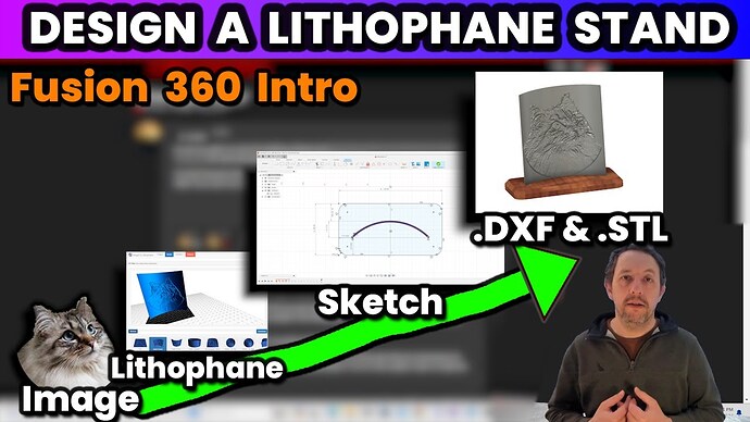

@Peacester showed me the neat FREE Image to Lithophane tool at https://3dp.rocks/lithophane, his topic inspired me to take a deeper look.
Originally planned to spend ~30mins making a quick design and 10min video… Ended up with this several hours later… :man_facepalming:
Here’s a basic stand video and files that hopefully helps people new to Fusion 360 who are looking to do this type of project.
Goal was to provide a Fusion 360 intro for a common project scenario, sharing a few ways in which you can use Fusion 360 to carve out the profile of any 3D model from a flat piece of stock.
stand.zip (16.2 KB)
0:00 Intro — WHAT, WHY and HOW to use Fusion 360 to create .STL and .DXF files for a basic stand. We’ll design the stand with material cutout for matching the bottom profile of an existing .STL model to be slotted into top of the stand. The resulting .STL and .DXF files can be made real using a CNC, laser or 3D-printer to help support a Lithophane of Mercury (our Cat).
1:00 Use FREE opensource Image-to-Lithophane tool to generate .STL models with embossed shapes.
3:20 Generate a high resolution and low resolution Lithophane models. We’ll use low res model to help Fusion carve out a profile in the stand.
5:25 Fusion 360, insert .STL file as a mesh, then convert to Solid Body. Solid Body objects are easier to modify than meshes.
6:40 Examine model being supported, figure out plan for Stand sketch and model.
7:50 Slice/Split Lithophane model, so easier to focus on creating profile being recessed into Stand.
9:00 Sketching profiles by manually eyeball tracing a geometry shape using lines, 3 point Arcs, etc…
10:10 Sketching profiles by Projecting specific geometry features (surfaces, edges, points) using lines, 3 point Arcs, etc…
12:40 Plan to sketch profiles by Projecting entire Solid Body’s geometry features onto Sketch plane.
14:40 Plan to split/slice Cat Lithophane body into 2 parts. Will hide embossed area, just work with section that will recess into stand.
16:00 Creating Offset Construction plane to use as tool for splitting.
16:50 Note on triangles/surfaces were simplified by split operation. Helps Fusion 360 performance/responsiveness.
17:30 Actually sketch profiles by Projecting entire Solid Body’s geometry features onto Sketch plane.
18:35 Start sketching Stand outline.
19:10 Using Dimension Constraints to setup size/layout. Mindfully create so design works even if some dimensions are changed (e.g. Length and Width).
20:40 Virtual construction lines for helping align/center objects.
22:00 Creating Symmetrical constraint to center cutout profile within stand.
23:30 Short note on over constrained models.
26:20 Vertically center cutout profile within stand by using dimension constraints that reference other dimensions, and using basic math/equations.
27:00 Short aside… Clarifying terms, what are Constrained versus Driven Dimensions.
29:00 Vertically center cutout profile continued…
30:30 Sketching rounded corners.
31:15 Fixing symmetry dimension constraint broken by adding rounded corners.
33:00 Make the model “Parametric”, so easier to edit, by adding parameters that change Length and Width dimensions using Solid » Modify » Change Parameters.
34:45 Adding Offset profiles for gap tolerance.
36:00 Exporting Fusion 360 Sketch to .DXF.
36:20 Creating 3D model by Extruding Sketch profiles.
38:30 Use Offset extrude to help raise Stand body, so the Lithophane is recessed/embedded (with contour gap).
39:30 Extruding more material that joins existing to help fill void/hole.
42:42 Changing material and color appearance.
44:00 Exporting models as .STL. Can export entire group, or individual models.

Guy ask for some input and you make a 36 minute video showing him step by step how to do it. Can somebody give @azab2c an award!??
Seriously. Above and beyond! Taught me some good things about CAD too
Most welcome. Just shared how I’d do this, late at night… Am no CAD pro, so am hoping others here will call out bad/misleading advice I shared. Hopefully more experienced folks here, and there are many, will help share more efficient CAD methods/considerations to help elevate all of us.
Or maybe, non CAD approaches too… e.g fwiw the interesting image-to-lithophane project is open source, so, someone could fork and mod the project (looks angular and three.js based to me) to just auto generate downloadable .SVG representing the footprint profile for the current lithophane.
Off camera, I tried out a few other things like using Merge to cut the lithophane body out of the stand, potentially without needing to create a sketch even.
For this project, that’d be a faster/simpler approach than what I showed. But trying to use Push Pull operation to add 0.5mm gap tolerance ended up with unwanted artificats/behavior…
For this project, could avoid using Fusion’s push/pull and it’s quirks for this profile, and, instead use EstlCam’s features to achieve desired gap tolerance.
