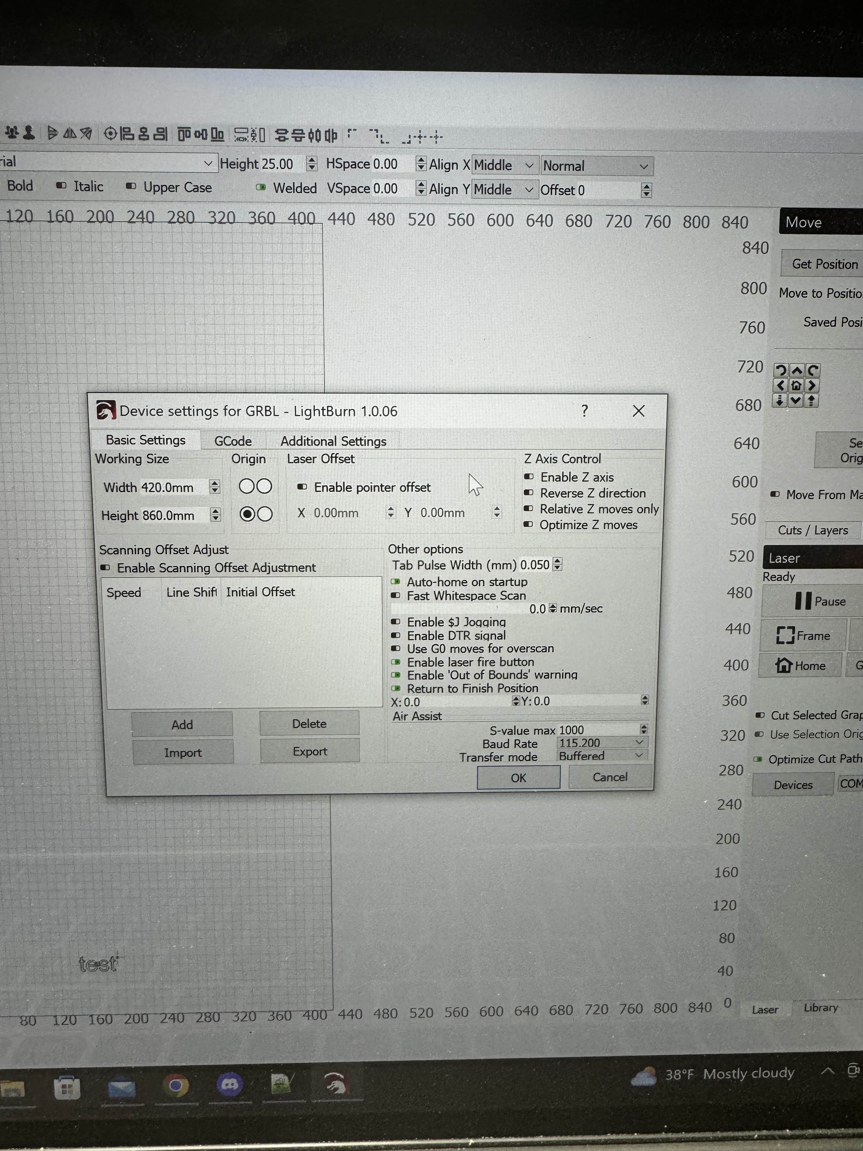

Thank you Britt I’ve gotten it to home now. I can get the laser to fire and move the machine around. I’m having this weird issue when I run a test burn. I’ve got the machine settings plugged in with my x and y dimensions and my origin as front left (this is on a LR3). It homes correctly and in lightburn the display looks correct with my origin and everything but when I hit frame or run, the machine runs off to the back right and then errors out telling me I’ve hit the soft limits. Even if I change my machine origin to the back right it still does the same thing (I was hoping i could trick it to thinking it was opposite just to troubleshoot)
Have you had this issue? Thanks again for your help.

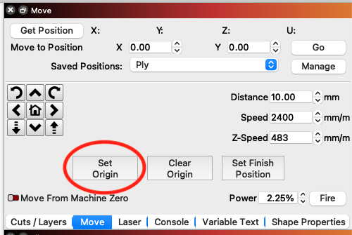

Did you click the ‘Set Origin’ button before running your project?
LB
I have yes
Did you change the machine size in the lightburn settings?

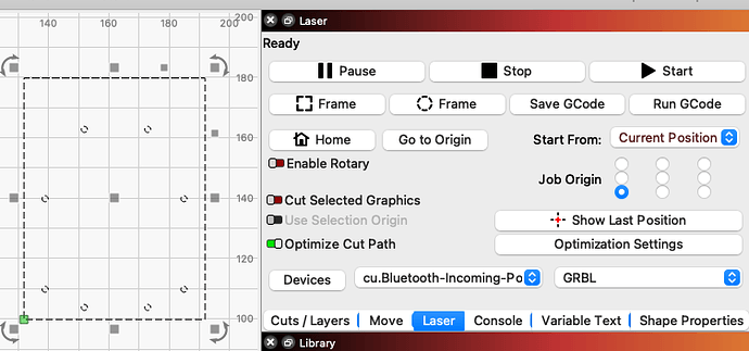

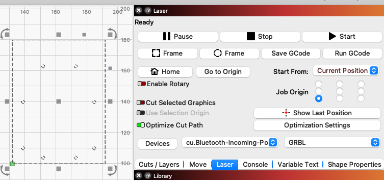

You have the Job Origin set to the lower left and Start From: Current Position?
Does it show the little green box in the lower left of your project?
The green box only goes to the lower left corner when I select absolute coordinates. Current position puts the green box at the lower left of the text box I’m test cutting.

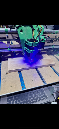

I just successfully cut it with me manually jogging the laser over to the middle of the board and setting the clicking set origin when over the workpiece.
I’m getting somewhere. Does the job origin always have to set to current position? I thought I could start from 0,0 (home) and go from there but that clearly isn’t working for me.
