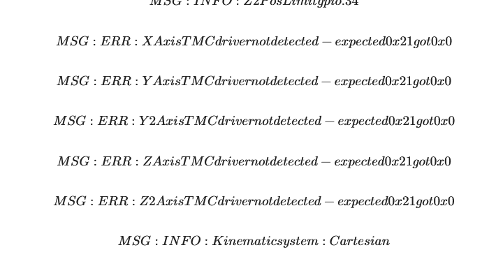

Hello,
I’m having some difficulties with my new Jackpot 3 controller in my LR4, which is an update from the SKR pro board.
I wired up the board, and tried to get connected - it kept on saying that it couldn’t connect to the board with wifi. So I went on to the forum and saw the issue where a few boards went out with that issue and could be fixed by going onto the fluidNC site and updating the firmware. So I did that (just the update) and had the same problem. I then did the re-install, which flushed the settings, but I could finally launch the web UI. I then went to the V1 releases website and downloaded the 3.9.9 w/ UI v3 JP3_LR.zip file, and used the installer’s file browser to install the files from the zip file.
I now am able to see the endstops working when using the calibrate function, but I can’t seem to get any of the steppers to move. Every time I try to jog it, I get a 500 internal error. I suspect there’s an issue with the yaml file, but with my limited experience I don’t know what I’m looking for. The error file is below, and I have enclosed the yaml file.
Hope someone can help!
Cheers,
Dave

\[MSG:ERR: X Axis TMC driver not detected - expected 0x21 got 0x0\]
\[MSG:ERR: Y Axis TMC driver not detected - expected 0x21 got 0x0\]
\[MSG:ERR: Y2 Axis TMC driver not detected - expected 0x21 got 0x0\]
\[MSG:ERR: Z Axis TMC driver not detected - expected 0x21 got 0x0\]
\[MSG:ERR: Z2 Axis TMC driver not detected - expected 0x21 got 0x0\]

Try powering it up without the USB cable plugged in.
Still no luck.
This part of $ss, says your drivers are not seen, with power only at boot does your board still say this?
It is usually easier if you post screenshots, or use the little
icon to get that text to format in a way that is easier to read.
Sorry about the formatting…

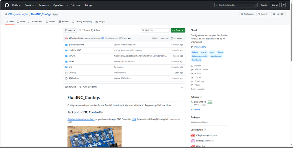

Anyway, I reinstalled the fluidnc firmware, then installed the lowrider config files from V1 github. I don’t know what I did differently, but now it’s working. I think I might have taken the config files from a different spot - the screenshot below shows the location of the files that I used, but it looked slightly different from the first time I did it.
Anyway, all good now. I like the new board, the steppers are really quiet! Also, controlling it from my phone or tablet is a definite bonus.
