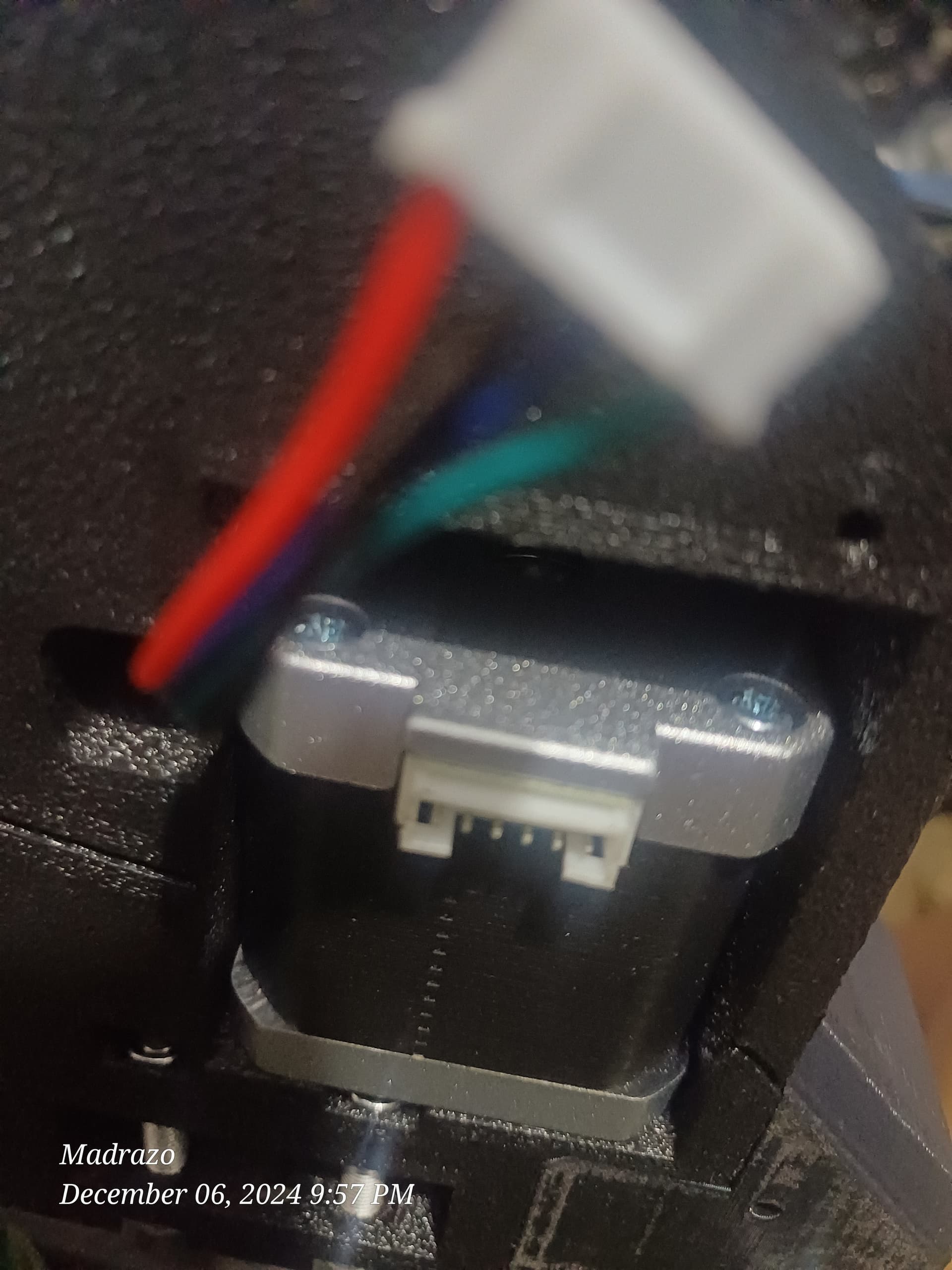

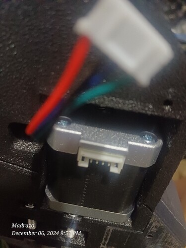

Steppers dont fit my LR4
Has anyone used steppers with a connector on the motor assembling? i can only get them to fit with the wire connector facing out. The metal tab interferes.
There is a case of someone who has those same motors, like me, and what we basically did was lower that part with a dremel so that they could fit. The motors Ryan sells fit perfectly.
Yeah, you can rotate them the way you did or dremel your way around. :smiley:
Yes, but in the Y motor I think that if you rotate it it could interfere with the Y belts. I haven’t tried it but I think I read it in another comment from the other guy who did the same thing. I think that in the Z one you can rotate them easily.
Thanks. I’ll give it some dremel action.
