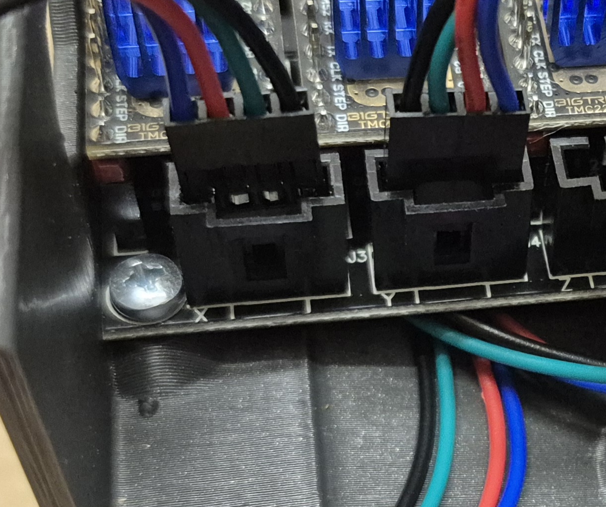

Hey, I have one last problem before I can start the machine for the first time.
I haven’t found any schematics for the Jackpot controller and I’m unsure how to connect the steppers. I have stepper motors from StepperOnline.
Since I can rotate the connectors, I can connect them either way, as shown in the picture. Maybe the cables in the connector need to be swapped.
Does anyone else use steppers from StepperOnline, or is there a pinout for the Jackpot controller?
No need to try to guess the correct way.
Fire it up, and test the motion.
Do it with small controlled movements, and if they are moving in the wrong direction
  1. power off machine
  2. Flip plug
  3. Try again
Don’t try to home or make any large movements until you know they are all correct. Like, a few mm at a time at most.
If something is off, it will be noticeable

As long as the motors move, flipping the plug (after powering down the controller) will reverse the motor rotation.
In my experience, the colors on the motor wires are not consistent, so you cant assume which color pairs make up a winding. If you unplug the motor from the controller (again, after powering down) and short a pair of wires together and the motor gets harder to rotate by hand, you’ve identified one of the winding pairs.

Not sure if I understand you correctly here:
Do you mean, that when powering your jackpot board you cannot move the motors by hand? That should be normal. When the jackpot is powered, the motors are enabled, which means the motors will be held in place. You should be able to move them via the webui controls.
Do only move them in 1mm steps and stop if they do not move in the right direction or if the motors on the y or z axis are moving in opposite directions.
If that’s the case, power down and turn the motor connector 180 deg. This will swap the motor direction.
