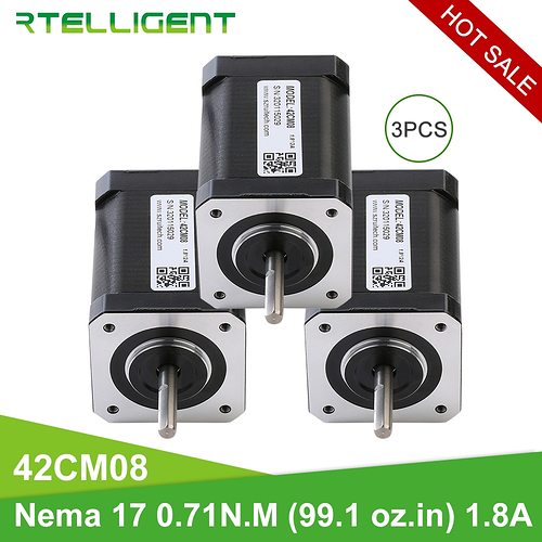

Hey guys I am looking at putting the parts together for my first MPCNC and wanted to know if these steppers would be okay?
Should the Z axis motor be smaller to cut weight at all?
That’s a lot of torque, most of us use motors at about 0.5NM. Fortunately more torque isn’t usually a problem. The tech specs look OK.
We are already carrying around 2kg router around on the gantry, I don’t think that the weight of the stepper motor is really all that big a factor.

These were the other motors I had found:

I’m using 84 oz-in motors for my Primo.

All in all, I found that the driver/controller has made far more difference in the steppers performance than the motors themselves, provided that they allow and can take the set current. Since we don’t push the motors to their limits, the actual rated torque won’t be what’s used, just the portion of it that we drive the current for. Also, torque goes down as speed goes up, since the motor starts to act as a generator, producing its own voltage backwards, fighting the driver current. (This is why higher voltage power allows faster movement.)
