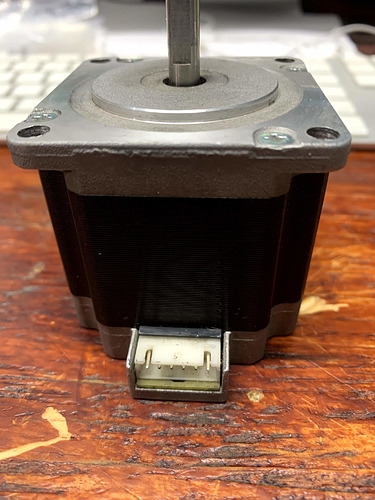

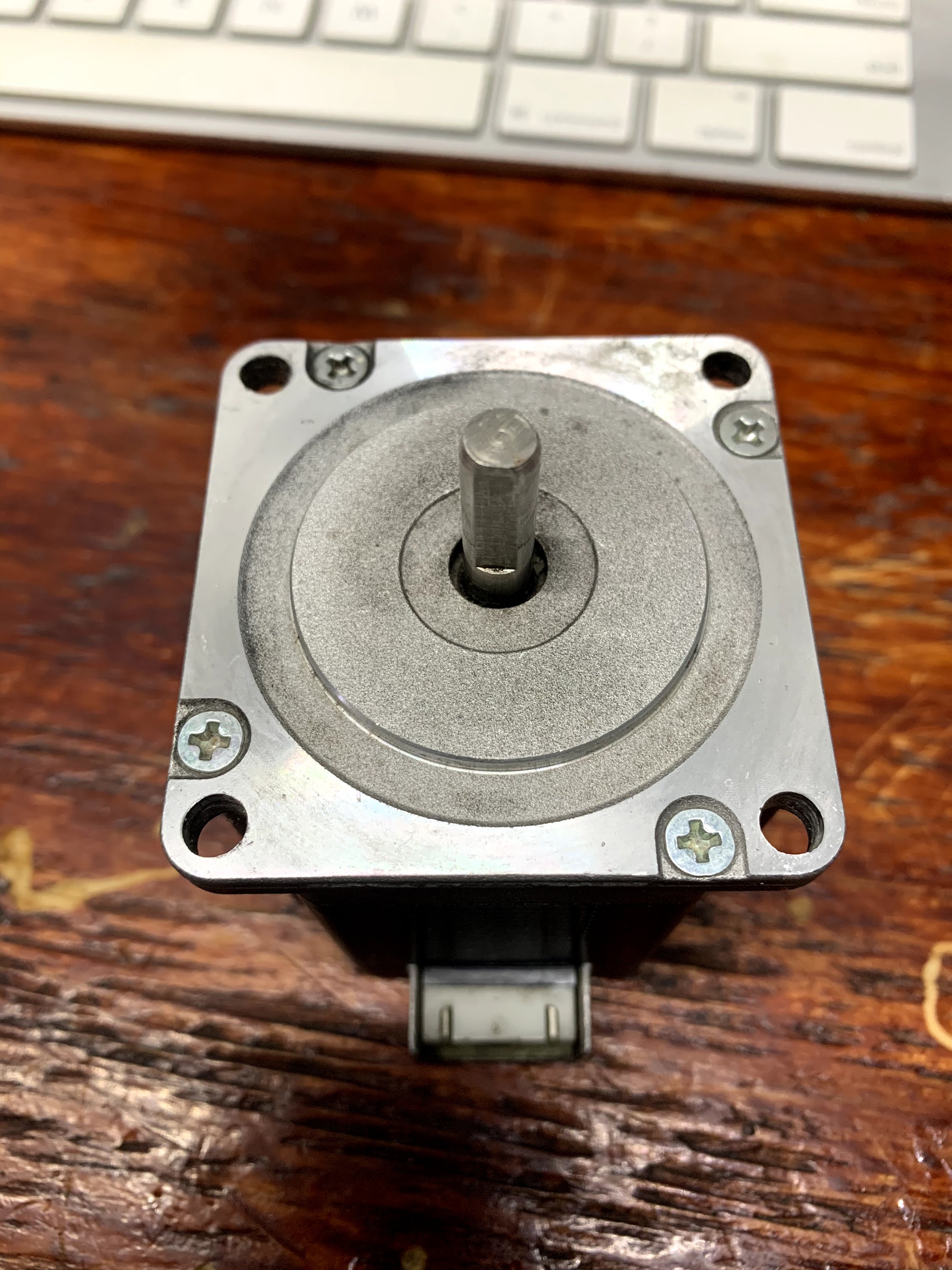

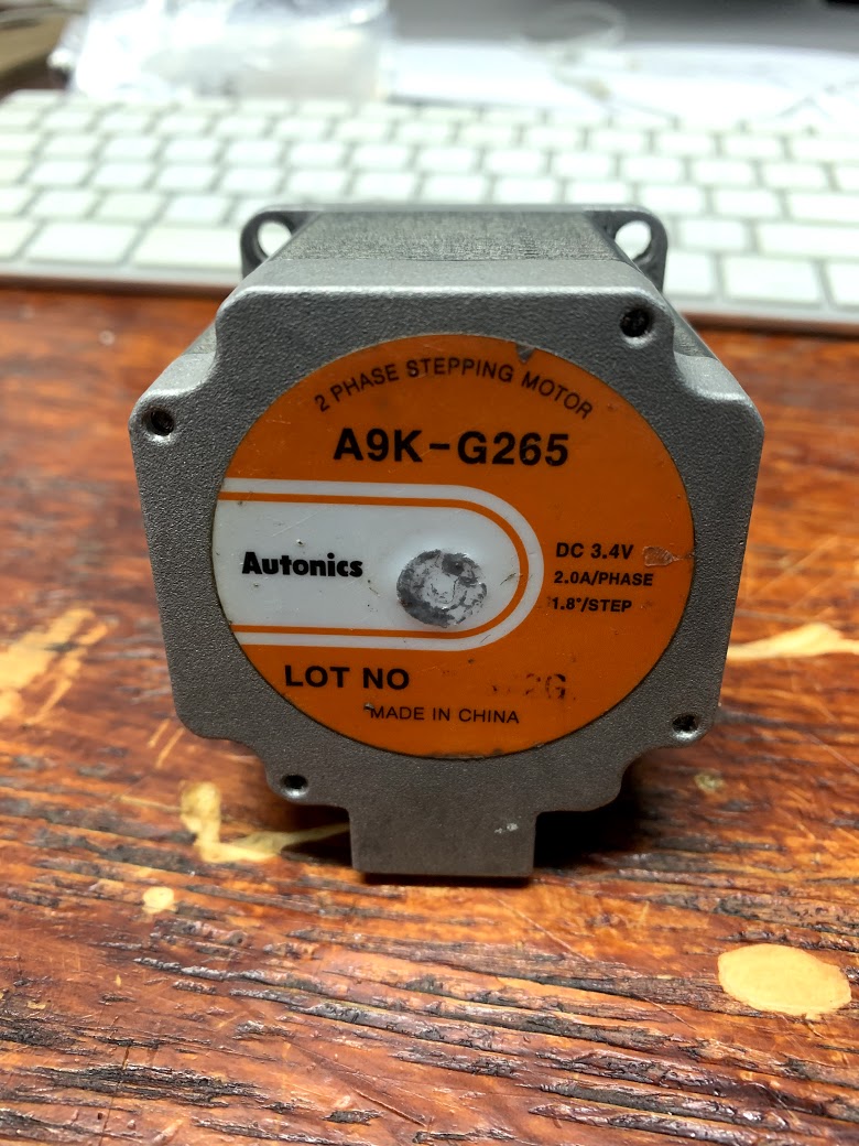

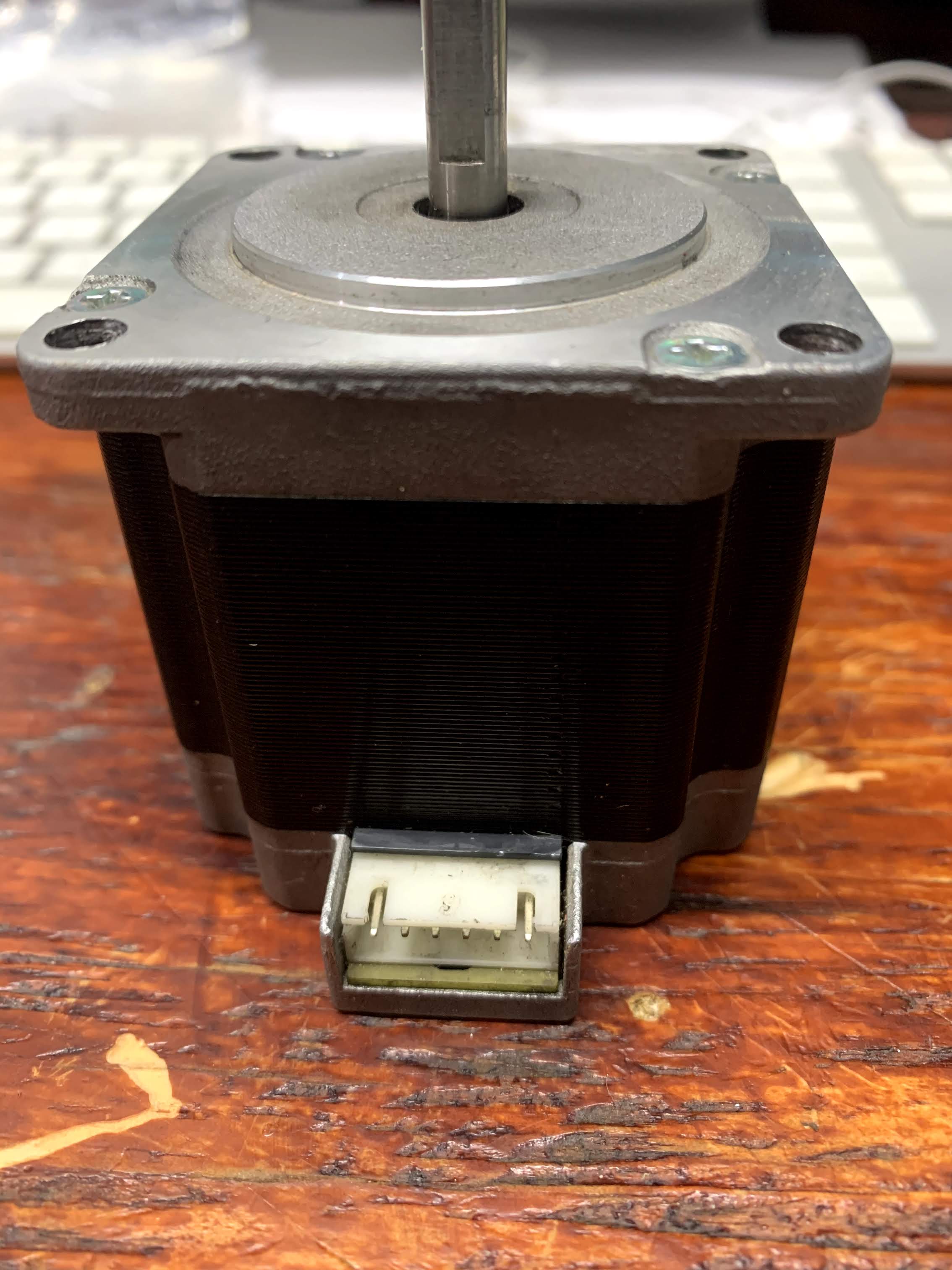

turns out I got quite a few of these steppers.
Can I build a MPCNC with these? if so, whats the best board or what would be the best way to continue?

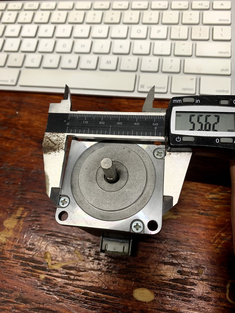

Those look like NEMA 23 stepper motors. They are physically larger in almost all dimensions than the NEMA 17 motors the MPCNC is designed for. They could probably be made to work, but it would likely involve a fair bit of ingenuity.
Electrically, they work just like the NEMA 17’s and could be driven by any of the usual driver boards (Rambo, Mini-Rambo, RAMPS, etc).
I would probably try to find someone who might be interested in trading motors.
They seem like very expensive motors, but the motors we use are like $10 ea. These will not be better, so it doesn’t seem worth it to me to try to fit them.
