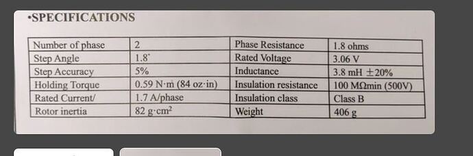

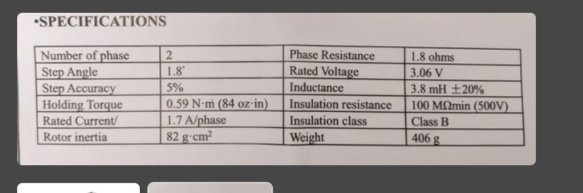

like phase resistance, inductance will these effects the final build in operation will setting need altering
i see there is a 2nd stepper on the shop now ? is this a better choice more accurate ?
84oz steppers from Zyltech and Stepper Online seem popular and reliable. Not sure why URL says ‘76oz’, probably an artifact of older slightly less powerful steppers being sold in the past.

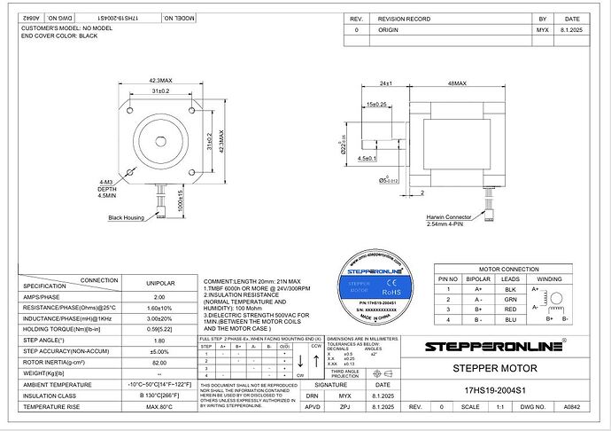

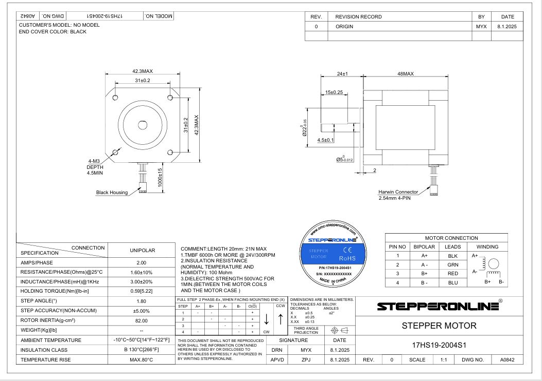

Guessing this one based on electrical/power and body dimension specs…
https://www.omc-stepperonline.com/nema-17-bipolar-59ncm-84oz-in-2a-42x48mm-4-wires-w-1m-cable-connector-17hs19-2004s1
  • Shaft Length: 24mm
  • D-cut Length: 15mm
But, should check shaft length, D-cut length are ok? @vicious1

To answer the actual question: Somewhat.
Yes, absolutely, IF they are wildly out of spec.
You’ve heard about wiring of the phases and inconsistency from other suppliers. That’s true.
Your question, though, was about the specs.
If you found a motor that had a wildly different coil resistance then you will need to tune your settings away from the stock ones.
At some point it becomes nearly irrecoverable.
The steppers in the shop are rated for 1.7A/phase and we typically run them in the 900mA to 1A range and not much over. If your steppers have higher nominal current (lower coil resistance), then at some point the impacts of that through the system will mean that the controller capabilities limit you.
For the data sheet that you posted, 2A rating and 1.6 Ohms of coil resistance with a .59 N*m holding torque looks to be just fine to use.
You should pay attention to a possible need to raise the current drive a bit and also the holding current in your config.yaml.
You should also carefully measure the temps of your steppers to be sure you don’t get the system too warm.
