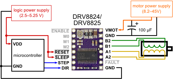

In principle, with series wiring of two motors at one DRV, they share the potential (Voltage) -> each one will have 0.35V of 0.7V (if they have the same resistance).

That voltage you are reading is just an adjustment, it is not what the steppers use. At some point JeffeB3 explained chopping to me. Since our steppers are rated for 2-6Volts but higher amps we use series since we have voltage to spare (12-24V power supplies), but we are pushing the amperage limits of the drivers (relatively).
Your steppers are rated at nearly the same as we use, so your drivers should still be at 0.68V or so (0.7V should be fine as I under power ours on purpose). The spec sheet for your steppers has two different values for rated amps, both are still close to ours.
So all of this said and done, with your drivers at 0.25V what happens with your steppers, do they get warm at all with 20+ minutes continual use? Did you get your two sets of ramps and drivers from the same source or different vendors?
Another thing to test is the Input power pin (Corner), does it shoe the same as your power supply, to me it sounds a bit like the drivers are running off the USB.
