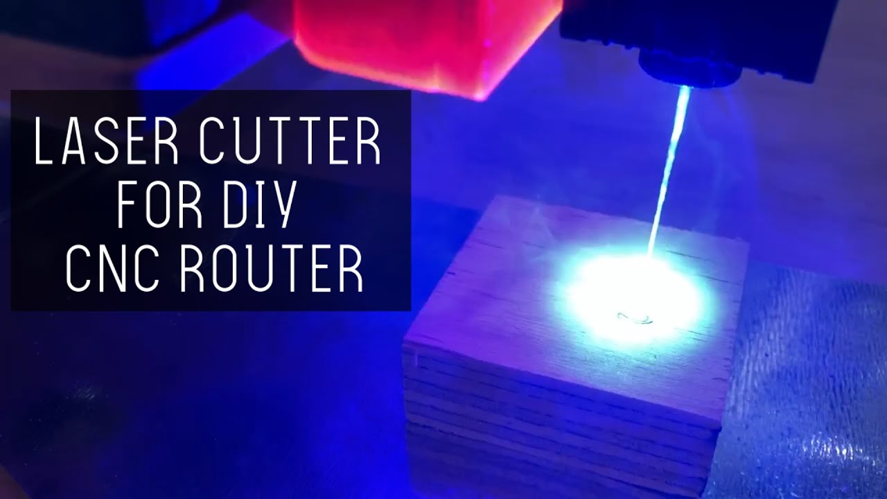

Hi All,
Hope everyone continues having fun with their builds or in making dust.
I recently added 5W banggood laser to my LR2.
If anyone interested in step by step video on how it’s done as a reference, here’s a link:
This forum discussions on the subject helped me a lot.
Cheers.

Thanks for the video! I can’t wait to try it out! Out of curiosity, what program are you using to compile the code? That’s the main problem I foresee running into, especially since you are using the fan speed as the laser control. Maybe this is less of a problem than I expect but I want to cover all my bases before jumping in. Thanks!
Installing a laser has changed since May 2020 when this topic was created. Laser support has been rewritten in Marlin. Assuming you are using a Rambo or SKR Pro board and assuming your laser will handle 5V/3.3V PWM, and assuming you are running a later version of Marlin, it is plug and play to install a laser. The laser will be driven my inline commands or alternately by M3/M5 commands. There is a substantial quality improvement using inline commands vs. using fan g-code commands.
If you have a board other than a Rambo or SKR Pro, you will need to enable laser support and recompile the firmware. This involves changing seven lines in configuration_adv.h and recompiling. The build environment of choice is PlatformIO.
Thanks for the reply! I am actually going to be using a 12v laser. I’ve been trying to find the pins that the laser control on the HMI controls but I am not finding it on any of the pins. I am using the Rambo v1.4 and would have thought it would be one of the fans. Because this is a more recent board do I need to adjust the FW to control one of the fan ports?
So, looking around a little more I found that I am supposed to connect to pin 45(+) and one of the grounds. I don’t have the physical laser yet but when I connect my multimeter to these two pins and set the laser to 255 I still only get around 100mv. I bought my board last summer so I assume that it is a recent enough FW. Any advice for troubleshooting would be appreciated!
What version of the firmware are you using? Laser support was enabled by V1 for the Rambo 1.4 board around version 510.
Here is a diagram of the pins to verify that you correctly identified Pin 45:
How are you turning the pin on? If you are using the display, the menu items are poorly worded. You have to turn the laser “off” to put it in manual mode. You can also turn pin 45 on directly using a M42 g-code.
I use a Rambo 1.4 board and a NEJE A40640 driven off pin 45. It was plug and play for me.
