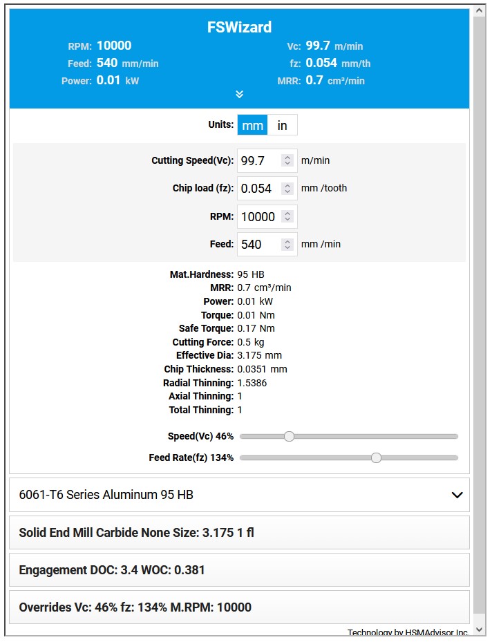

Here is the steel numbers. I will add the aluminum ones for an easy comparison.
Aluminum
Not sure those numbers are getting calculated well for whatever reason.
